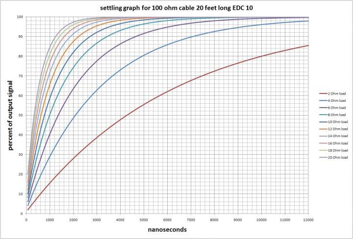

Actually, I've been saying it all along. sqr(L/C) gives the hf Z, and at audio frequencies the actual impedance is typically a factor of 2 to 4 higher. I've stated that the equation gives a LOWER limit on the cable impedance, and an UPPER limit on the propagation velocity.
The selling of an "8" ohm cable for an 8 ohm load is actually quite reasonable from an engineering standpoint. Think about the total energy being stored within the cable at DC for example. The inductive storage is indeed 1/2 LI2, the capacitive storage is indeed 1/2 CV2, and it is a minima when the load impedance matches the line impedance.
When the hf impedance matches the load, the settling time of the cable/amp/load system drops to the propagation transit delay, which is roughly 20 nSec for a 10 foot cable. (yes, the tail does slow down significantly as time goes on and inverted time drops into the audio band). But when the hf impedance is several orders of magnitude higher than both the source and the load, the settling time of the system increases 3 to 4 orders of magnitude, bring the settling time into the domain of human perceptions of ITD.
The only issue with very low Z cables, is that the load decouples at high frequencies, and if the amplifier's unity gain frequency is higher than where the load decouples, the phase margin is compromised. A zobel at the load can fix this.

edit: sheesh, I only went down to 2 ohms in this..1 ohm settles even slower.
edit 2: This graph is the settling time for a transmission line using the hf equation. It is the MINIMUM time that the system will settle. If the actual audio frequency impedance and propagation delay were used, these delays would be 3 to 4 times LONGER. The 2 ohm line is about 4 uSec to 50% of final value, it would climb to over 10 uSec with actual t-line numbers, and 1 ohm settling to 50% would climb into the 20 uSec realm..

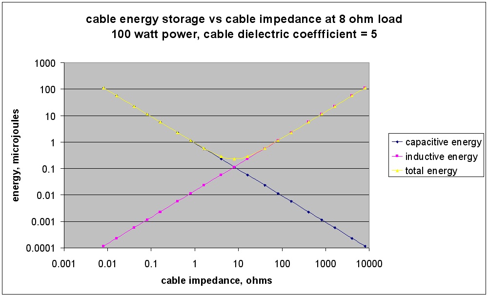

Your statement is correct if you have a given cable and wish to adjust the load impedance to minimise stored energy.
That is not the situation with loudspeakers. There we have a given load impedance and can adjust the cable; the result then comes from minimising L and C.
This is analogous to the situation for maximum power transfer from a generator to a load. Given a generator output impedance we set the load equal to it. But given a load impedance we want the generator impedance to be as low as possible.
A problem and its inverse don't always have the same solution! Note that I am not commenting on the desirability or otherwise of minimising cable stored energy, just on how you would do it if you wanted to.

It is identical in all respects. Had I normalized the data, you would not be trying to pick them as different.
L and C tradeoff. LC = 1034 DC for constrained cables (actually, epsilon*mu for DC, but generally speaking, mu is 1.), and for standard zips, use EDC in lieu of DC, with EDC in the 4 to 10 range based on conductor spacing (due to field existing outside the conductor pair).
To minimize both, you have to go either stripline or coaxial, or do a paralleled cat5e style cable, giving EDC of about 3 to 4.
Remember, a speaker load varies. If the load varies from 1 ohm to say, 50 ohms across the audio band, then the settling time will be heavily frequency dependent. If the cable is a 300 ohm cable (typical zip at audio frequencies btw, it's hf Z without R or G is about 100), then this speaker/cable combo will settle in a long time at the 1 ohm frequency, and far faster at the 50 ohm frequency.
I would recommend making a cable's audio Z somewhere between minima and maxima load impedance.
What I am speaking of is both sides of the equation, and the relationship.
Doing it is quite simple. A zip runs 100 ohms hf. Twist 4 zips with orthogonal pitches, then parallel them, giving 25 ohms, or 8 giving 12.5 ohms, or about 35 to 50 at audio frequencies.. Then, the only remaining Q would be conductor resistivity vs bundle size.
edit: your generator with impedance argument falls apart in the audio solid state power amp domain. Most amp Z outs are very low by design.

Go through the maths of the stored energy minimisation problem, as I did before answering your post. I suspected you were wrong, but I didn't want to reply before I had checked it. You will find that given a particular cable L and C you get minimum stored energy when the load impedance R is sqrt(L/C) (as you said). Now fix R and allow L and C to vary; you will find that minimum stored energy comes from minimising L and C (as I said). Simple maths. Different problem, so different answer.

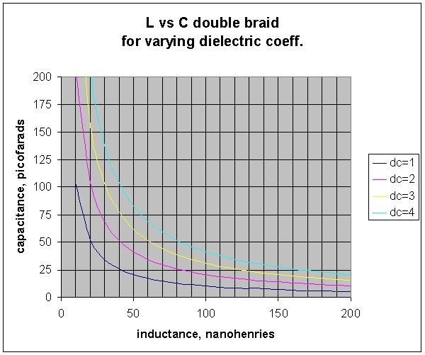

L and C tradeoff. You can only minimize both by constraining both the E and M field as in a coaxial cable or stripline.
LC = 1034 DC.
DC = LC/1034.
Vprop = 1/sqr(DC)
Make both L and C too small, Vprop exceeds lightspeed.
edit: I've attached a few graphs. First, the direct relationship between hf prop velocity, L, and C for 4 velocities.
Second, the relationship between L, C, and DC for a coaxial cable.
Third, the energy storage relationship between cable Z and load Z. As DF96 apparently concurred, this relationship holds from DC to daylight.

I am still not convinced that minimising energy storage is desirable, but that is a separate issue. I guess it is the lumped version of your settling time ideas, which we have already argued about in the past.
That's ok, my beliefs are independent of what you are convinced of.😀
Seriously though, this delay stuff has been measured by Cyril Bateman at audio frequencies using a modified RF bridge.
The settling time exists, it's as I've stated, it's been measured by others... It's the settling time across the entire audio band that's important, but only if one wishes to maintain the soundstage virtual imagery. Me, I've no audio system that is very capable of that. Nor, any desire to try to own one.
The only thing left is to test for audibility. that would determine desireablility..
