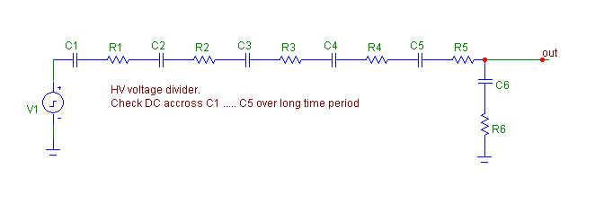

Holy cow! THAT is quite a statement for 'just' a 1st stage! 😎Here is an example circuit, exotic enough for you? This is ONLY an example. It will not necessarily work as shown.
It probably requires a lot of man-hours and pile of parts to put than one together..
It is expensive, but it is relatively straightforward to build. This design won a major award in Japan a few months ago. This is an example of what it takes to make a 'successful' world class design.
The DA stuff there is mostly nonsense.
It is not a nonsense. Please check the attached image. Sometimes high voltage dividers are designed this way. Try, after some time, like days, weeks, to measure DC voltage across capacitors. You will find that some have higher residual DC, some lower, some positive and some negative. This is DA in real world and discharge resistors of high value must be used over every capacitor of the series damped capacitive voltage divider.
Pavel
Scott has worked on DA in the past (see below). His ‘nonsense’ now refers to the DA ‘cross-over distortion’

George, thanks for the clarification. Cross-over distortion based on DA is really highly improbable.

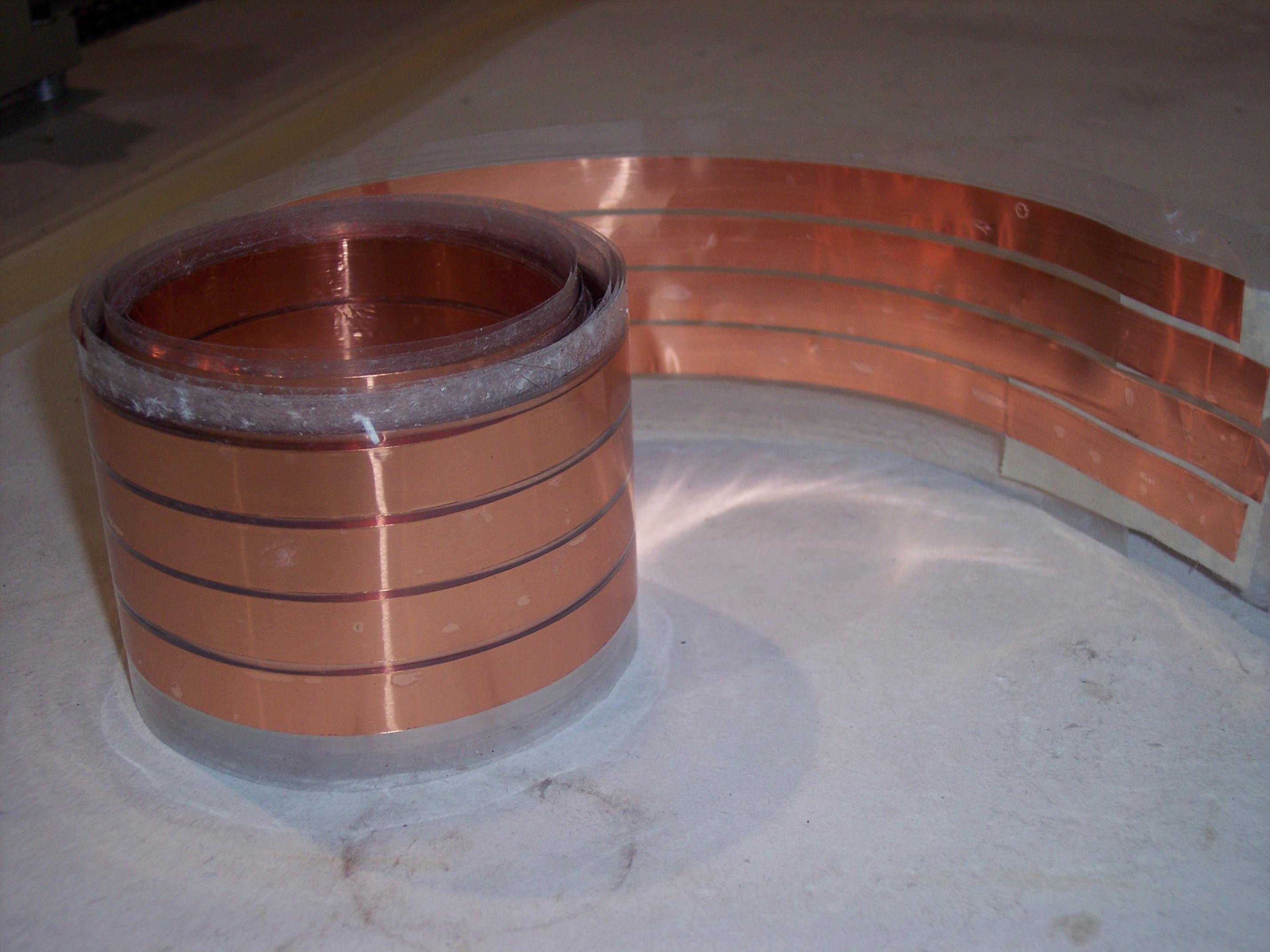

Funny you mentioned copper bars , I'm experimenting with flat 1/2 inch wide copper wire to connect to the amplifier , im pretty impressed with the sound i have the conductors spaced 1 inch apart i will do another pr at 1/2 and compare...
i can give you measured data or i can also report my subjective findings. Before i went for heavy gauge round and it did not work , this works much better , its not used on the bass , its used on the mid/ high ribbon drivers ..
I may drag it in one day and measure RLC , my rig only measures up to 40k ...
Like the Nordost Valhalla?The copper foil is physically locked in , flat ,( similar to a ribbon cable) on mylar , they seperate at point of connection.
I measured 1/2 inch copper spaced on a film as well as with a film between them. The effect of the foil side by side is to increase the reluctance path, lowering the self inductance. I measured the two geometries, I'll try to find the graphs...edit:found them.
Given a 1 or 2 ohm load, I'd be more inclined to drop the cable impedance down into the 4 to 8 ohm region to reduce the inherent line delay in a high z line with low z terminations at both ends.
There is the Earth's magnetic field, and current flowing in the wire.
yup. Half gauss fields, sometimes as much as .7 gauss. Nowhere near enough field to cause current to divert within a conductor.Put some numbers on that, jn would.
edit: here's a pic of the valhalla clone I made a while back using half inch copper 3 mils thick. (.003 inches). Also, the test data for this as well as the same half inch wide foil one on top of the other, with a 3 mil kapton insulation between. The measurement of the wide spacing falls apart at the higher frequencies, that is why I do a frequency scan with all inductance measurements, to make sure the equipment is behaving..given the low capacitance of the clone, I suspect either the cable is broadcasting into free air, or the length is setting up a t-line resonance which the meter is mis-interpreting.

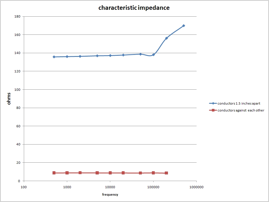

Frequency scale on graph? There are numbers but no units.jneutron said:here's a pic of the valhalla clone I made a while back
Hz 🙂

Measuring a resistive characteristic impedance below 1000Hz in a cable which is likely to have particularly low inductance looks a bit suspect, but I could be wrong. How was the measurement performed? The variation at the HF end looks to start rather earlier than I would expect - unless this balanced cable was being driven unbalanced and so began to act as an antenna.
I am also curious, at very small portions of a wavelength is it sufficient to measure L/C and compute Z? BTW I get ~.0025 Ohms/ft R if that picture is 4-1/2" stripes in parallel. Folks have tried 6-RG58 in parallel go for 50? 😀
The inductance measurement was performed very well..😉Measuring a resistive characteristic impedance below 1000Hz in a cable which is likely to have particularly low inductance looks a bit suspect, but I could be wrong. How was the measurement performed?
Actually, if the low frequency inductance did something different, then I'd be suspicious. As it flatlined down to 500 hz with no anomalies, I've no concern as to the validity of L down to 500 hz in this case.
Care must be taken when measuring inductances in the 50 to 100 nH range, as the setup lead issues can be non-trivial. When I work low inductance, I physically setup the leads and DUT, and do a zerocal with a shorting wire directly across the DUT at the connection. Any movement of the test leads at the DUT require re-zeroing, as simple movement of the leads can be several times larger than the measure.
The graph is simply z = sqr(L/C). As such, it ignores the distributed R and G.
As measurement of energy storage within the cable at audio frequencies, it is enough information. It shows that capacitance as well as inductance measurements were consistent.
As a measurement of settling time for a sub wavelength t-line terminated at each end with terribly low impedance, it can only provide a minimum settling time. The actual z at audio frequencies will be higher by a factor of 2 to 4, and the prop velocity will also be quite slower. So calculation of final settling time at audio can just be assumed at least 2 to 4 times slower.
I run L and C through a wide range of frequencies in order to assure myself that the equipment is behaving well.
It is a roughly 10 foot long two conductor system with 1.5 inch spacing. Because the capacitance was very low, I would not expect a bulk resonance at 200Khz, and the line length is also too short for resonance via t-line reflections. So as I stated, I believe it may have been broadcasting. I made sure there were no conductive objects near the cable during measurement.The variation at the HF end looks to start rather earlier than I would expect - unless this balanced cable was being driven unbalanced and so began to act as an antenna.
