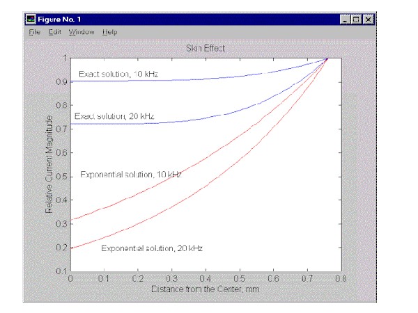

Note that they used the skin depth approximation equation, which is inaccurate for round conductors when the depth is more than say, 5 or 10% of the conductor radius. They are off by about a factor of 3..
I wonder what other approximations they used which are not close.

Wait a second, if we have the asymptote at DC and where we are at 10% or so of radius how would a reasonable smooth interpolation get 3X off in between? I'm dense OK.
Some kinda bessel thingy. Remember, the exponential approximation is only for planar wave e/m fields impinging normal to a flat conductive surface. It works very well when the actual skin depth is small compared to the wire radius. It falls apart in the audio domain. Well, ok, it may be good enough with my 535's..

Current density vs radius is another way to look at it but I was thinking net resistance. At DC it's R Ohms per foot and constricted to 10% of the radius in circular mils it's approximately 5R Ohms per foot at some frequency which is not that high for big wires.
They were discussing RG 58.
My statement was that if the skin depth is 5 to 10% of the wire radius, the exponential is a very good approximation. At lower frequencies, it falls apart. For a 1.5mm dia wire, it's off by about a factor of 3 at 10Khz.
I always worry when somebody takes an analysis really far when some of the initial assumptions are based on approximation equations.

I think the skin depth issue for a round wire is covered somewhere in Ramo, Whinnery and van Duzer - most textbooks omit it which is why so many people are not aware of it.
Me too. The snag is that EE courses don't always tell students the difficult bits that physics courses cover - and I suppose that us physicists don't always hear about the reservations of mathematicians when they see our tricks.jenutron said:I always worry when somebody takes an analysis really far when some of the initial assumptions are based on approximation equations.
