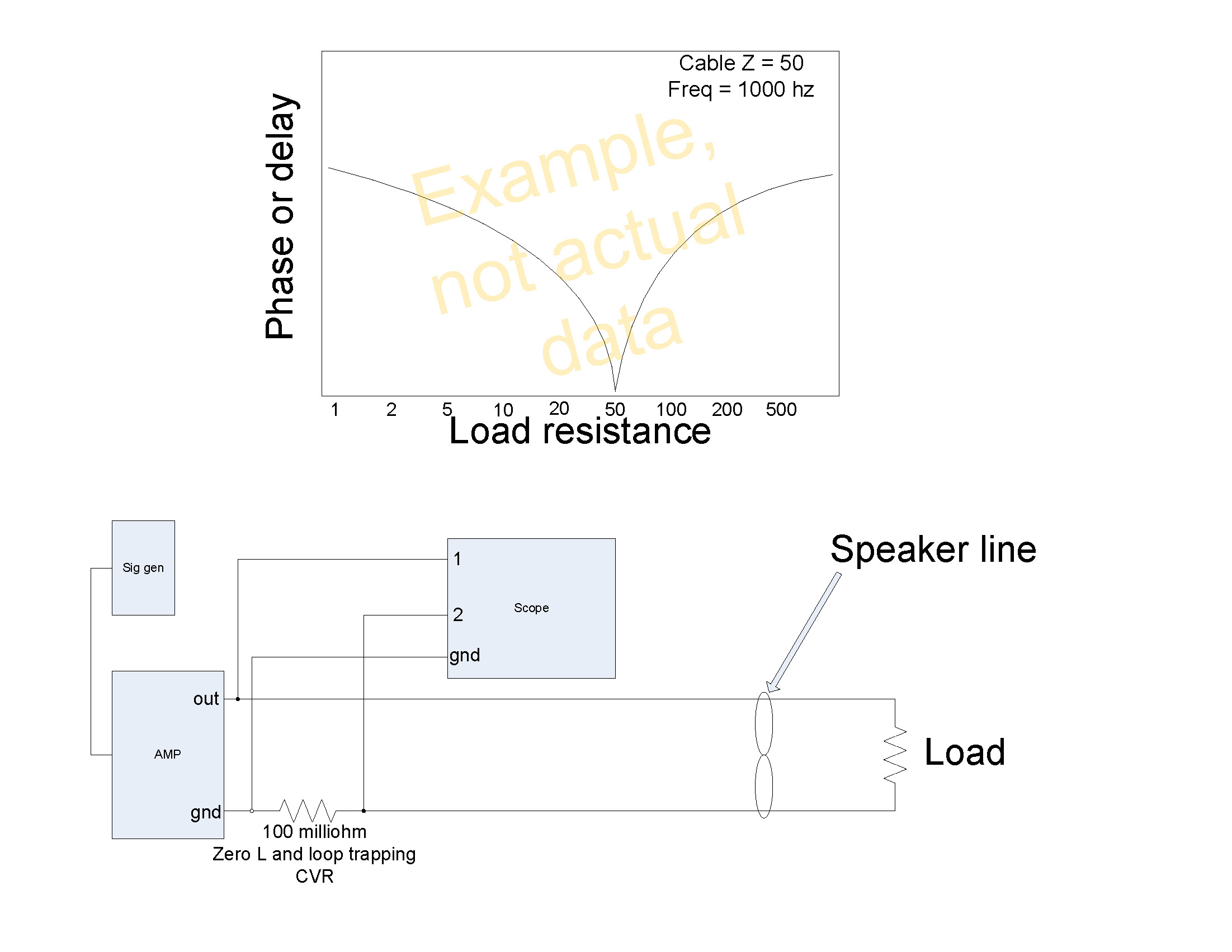

It can. Either use a low milliohm zero bdot cvr at the amp out, and measure the zero crossing delay between the voltage across the line and the current drawn by the load at the other. The only time difference in current from one end of the line to the other will be one transit delay, or about 20 nSec. I recommend measureing the load current at the amp because doing so at the load raises "heck" with the scope grounding.The waveforms are clear why can't a direct measurement be done?
The other way is to use a modified rf bridge. Yuk.
edit: attached is the test setup. Frequency is arbitrary, I believe Cyril used 1Khz as well.
The resistor is extremely important, as it's self inductance will be very significant compared to the IR drop at 100 milliohm.
Also, use a really good resistor at the load.

Yes.Was your plot a voltage step at one end and the voltage at the other end?
No matter what the amp does, the line will initially charge voltage and current at the line's impedance. One transit delay after the amp does something, the load only sees what passes through the mismatch interface via the transmission coefficient.
The difficult thing with audio is the wavelengths for audio signals are so slow, that we can't see directly the reflections and the composite effect the line to load mismatch has on the current through the load.

Thanks, a couple of experiments to try (you do mean long not slow?). One quick question is that plot the absolute value of phase? Dimitri is sending Mr. Bateman's papers.
Yes, I meant long. The rate of change of the audio voltages is very slow in comparison to the wire lengths we discuss, so it is impossible to see how the cable fills up with energy..
The primary purpose of the plot is to convey the cusp which occurs when line and load are matched. Below the cusp is where inductance dominates, that is where my settling time graph details. Above the cusp, capacitive storage dominates. That is also the region where I mention hot amps and phase margin concerns.
It's moreso a delay plot, but at a single frequency the distinction would be moot. Delay is somewhat easier to understand conceptually, and I'm keeping it simple..

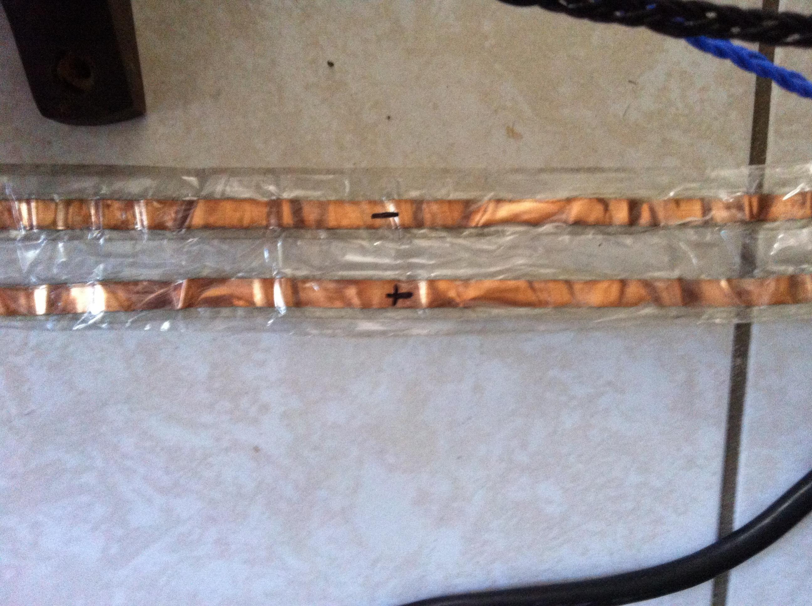

pic of cable ..:

edit..BTW, you've ruined the frequency response of your cables. The electrons are going to avoid the plus and minus magic marker symbols , and that's gonna slow the signals down. Maybe you can counter it with red racing stripes on the other side of the cable..

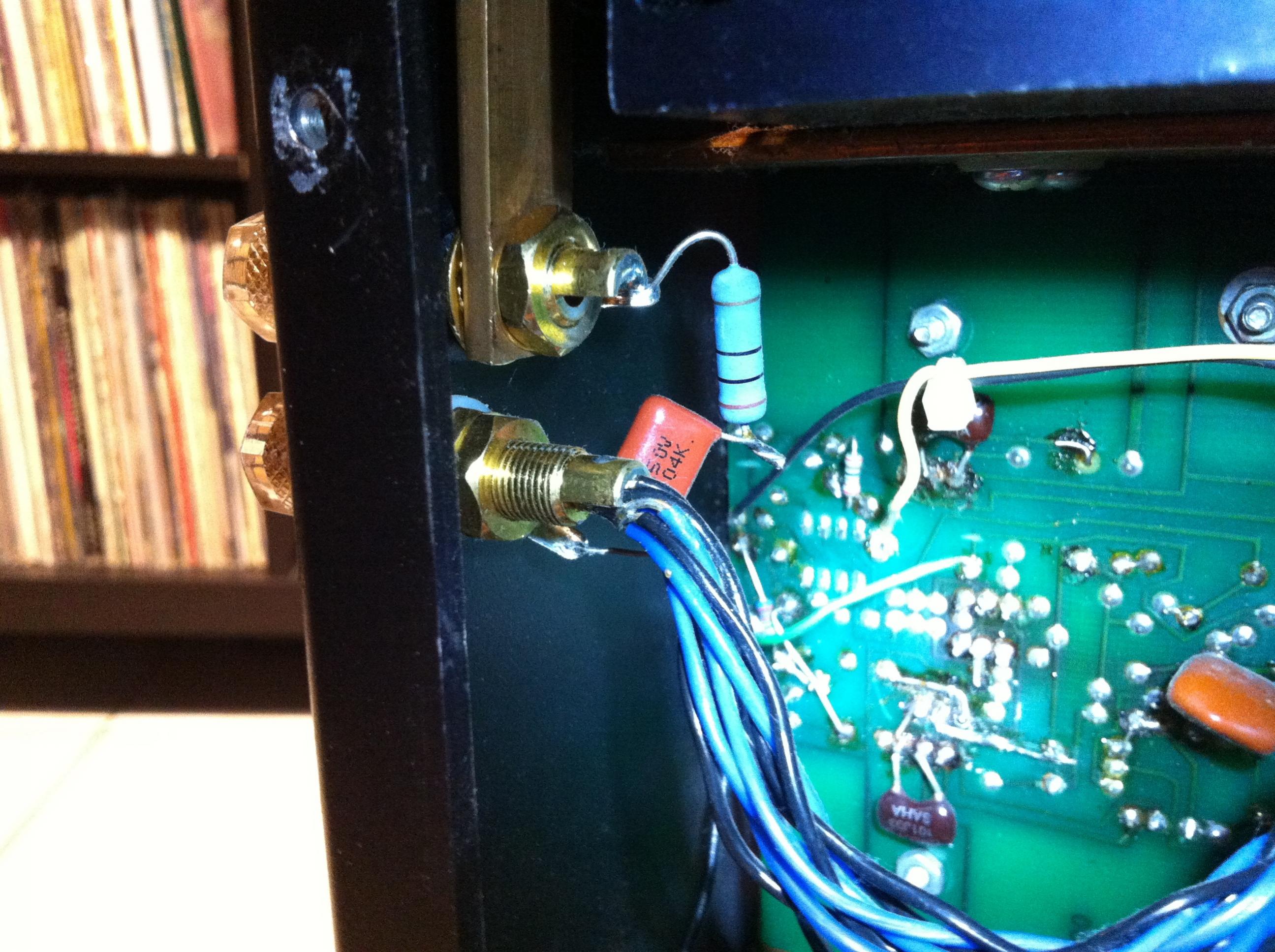

ps..I won't tell anybody about that missing pc land if you don't...
No. Coulomb's Law. They will be attracted to the + symbol and repelled by the - symbol.
"Ceci n'est pas une pipe."
Ah, but you forgot, my three dimensional friend. They are flatlanders, and cannot discern the symbols as they approach..they only know that such symbols are the work of the demon (Maxwell's demon), so go out of their way to avoid it.. Course, they can't eat either.

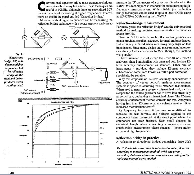

Seriously though, this delay stuff has been measured by Cyril Bateman at audio frequencies using a modified RF bridge.
http://techdoc.kvindesland.no/radio/passivecomp/20061223155312558.pdf

Personally, I feel that the structure of the cable is too flimsy, considering the currents that are drawn by the speaker. I would mount the foil on a much more rigid substrate, or stabilise what you have there on some form of backing material. What I would look for would be audible variations with peak signals, crescendos and suchlike ...pic of cable ..:
https://community.klipsch.com/index.php?app=core&module=attach§ion=attach&attach_id=86522
