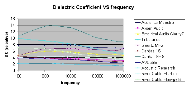

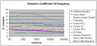

Years ago, I tried the formula to estimate the L of some cables but I failed miserably due to the field spread of these constructions (I didn’t know that then but I suspected it). George
Something I did for Gene D at AH.. It uses data he measured. I cannot vouch for the absolute accuracy of the data, but it seemed ok.
