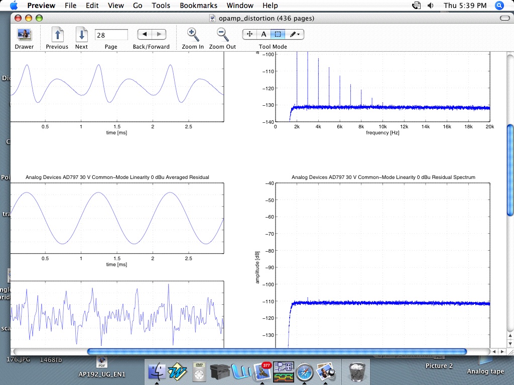

It is almost impossible to measure the actual nonlinearity of an AD797 at low levels (typical working levels) because the high negative feedback and the residual noise floor hides it.
I have difficulty believing that your understanding of feedback is that poor.
Grooner uses distortion magnification technique. One should start with something else to explain sonic differences. BT result in Grooner test would be horrible.
Who wrote (i quote):I showed higher order distortion from a typical graph from Samuel Groner's measurements of the AD797
"At higher frequencies (10kHz and up) slew rate is of great importance for low distortion."
Each time you are talking of an OPA, you refer to parts with 20V/µs or less, and complain with high order harmonic distortions. Chose your poison.
JC, if you haven't got the facilities to measure distortion at those levels, why not send your spare Blowtorch to Sam to test and compare against AD797? If you send him your Hirata box too, I'm sure he'll figure out how to work it.SY, what do you want? I showed higher order distortion from a typical graph from Samuel Groner's measurements of the AD797, that has been discussed here before.

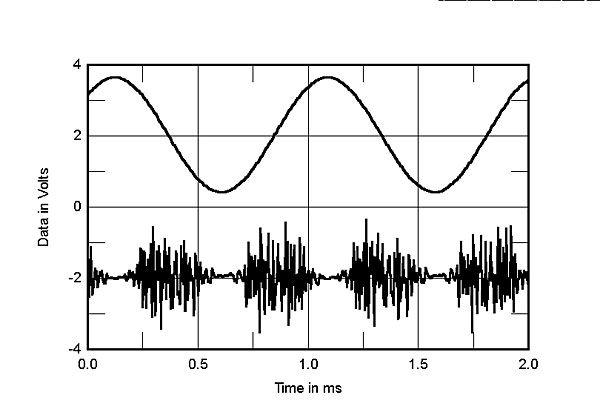

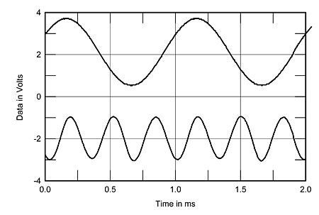

OK everyone, I don't usually measure op amps for a living, so I have never used the DISTORTION MAGNIFICATION TECHNIQUE. However, just a look at a distortion waveform at ANY LEVEL can give me an idea of the circuits performance. Virtually all IC's have a 'kinky' distortion waveform. That means higher order harmonics, because they make the KINKS in the distortion waveform. If it is ALL lower order, you see only a sine wave or two sine waves mixed together, no kinks!
Well, I'm into 'kinky' sound, as well as in other things -- anyone else so inclined ....? 😉, 😀Virtually all IC's have a 'kinky' distortion waveform.
Frank
Just like this vs. this...
