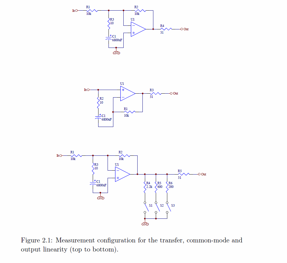

This is the setup that Grooner uses to measure transfer linearity. Please note 60dB of noise gain.

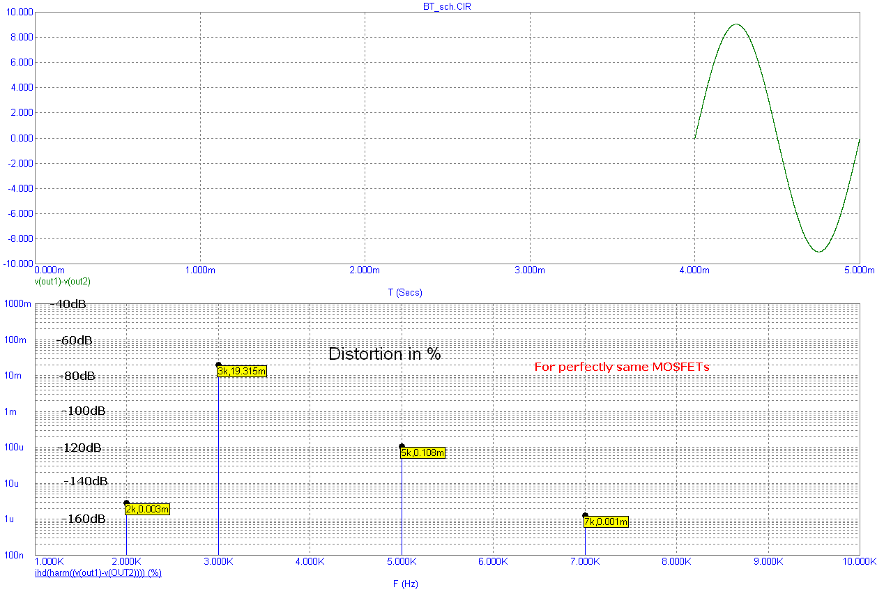

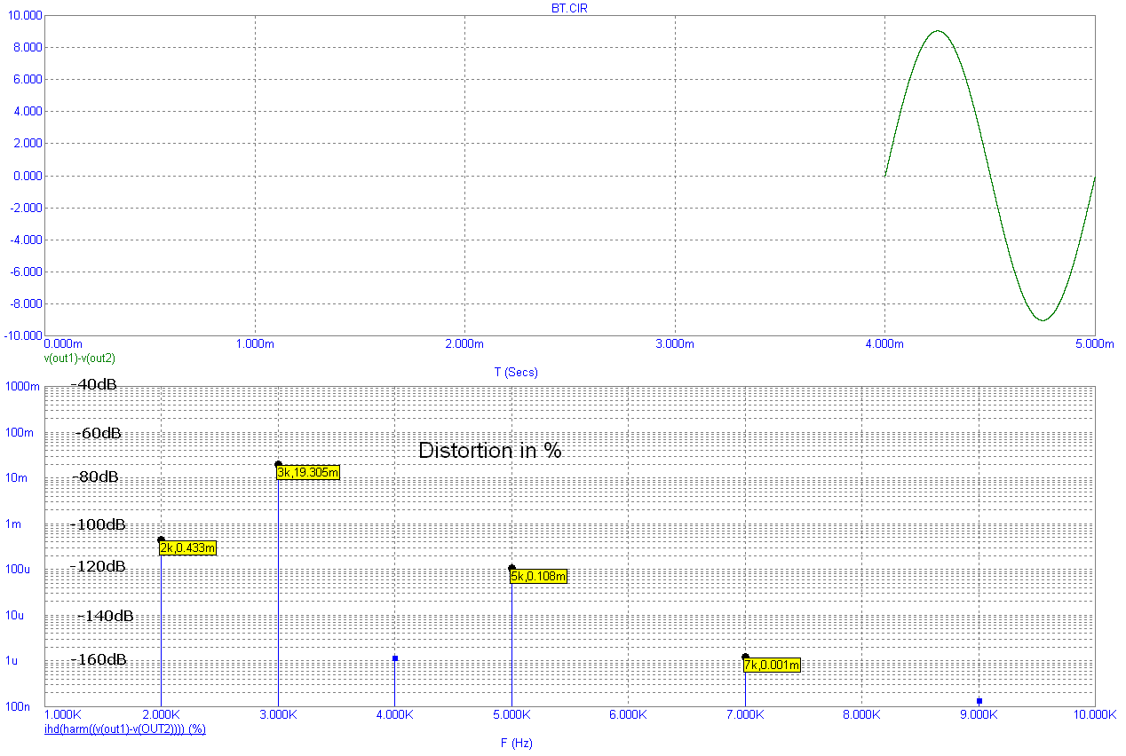

When I am simulating BT, for balanced input and balanced output I get this at 9Vp output amplitude. It is good, but if for John any 7th at any level (like -160dB) is an evil, he will find it even here. And, the simulation assumes perfectly matched JFET parts. 1st simulation is for some difference in output MOSFET capacitances, 2nd for absolutely same parts.
If the AD797 was measured under normal conditions (and NOT with 1000x distortion magnification as Grooner does), I am sure it would not be worse in 7th and it would be MUCH better in 2nd and 3rd.
Anyway, the level of 7th like this is absolutely unimportant, regardless BT or AD797.

Thanks PMA for your frank criticism, and your measurements. NOW, I have something to work with, but please understand: I use my CTC balanced out with 1V rms max per side, because I have a voltage gain of 27.2 following it to match THX specs. Most of the time I am below 0.1V per side, as 0.1V would give 90+ dB in my living room, and I live in a small apartment, with sensitive neighbors.
OF COURSE, if you push any design high enough, then 7th harmonic distortion will appear. However, it falls off very rapidly, according to a predictable mathematical equation so that it is almost nothing at any PRACTICAL working level. There is the problem of measuring it at working levels, Better to find 7th at a much higher level and scale down to working levels, mathematically.
Now just to make this clear: The Blowtorch is rated for 3V out, balanced. It is not perfect here, but at this output, a Parasound amp following it will be clipping at over 1000W in my living room. See the problem? It is absurd then to worry about its operation, even its 7th harmonic above 3V.
Of course the construction of the Blowtorch is not perfect, nothing is, and it will have more measured distortion from less than ideal components that it is made of, as well. Best they each don't contribute too much, however.
Let's get real. 7th harmonic is something to avoid. A super linear transfer function is one of the best ways to minimize it at ALL working frequencies. Feedback can help too to reduce measured distortion, but it has other problems, so I use it to a minimum, when I can.
