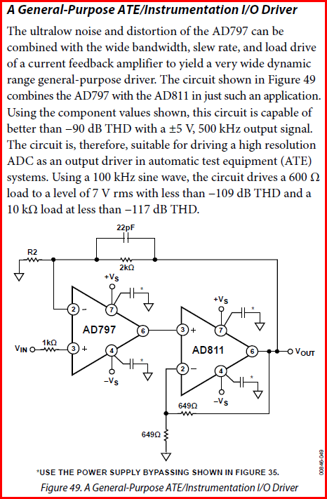

well you could put a R to a rail to SE Class A bias the output
AD797 has ~500 uA output bias so should supply ~+/-1 mA in push-pull
and that's plenty to drive a real buffer or CFA op amp input of MegOhm||pF if you need more output
you really don't have to only use just one op amp if you really want superior performance
DSL driver CFA op amp for instance are designed, speced to compete on distortion at 100 kHz- few MHz while driving W into 25 Ohm - audio cross over distortion is not a problem
wrap a "good" "audio" input op amp feedback loop around one of the DSL drivers to clean up thermals and what's left to complain about?

The AD797 can't properly drive its own feedback loop. jcx

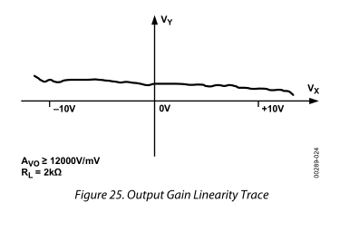

I take it PMI fixed this without resorting to classA biassing the output stage - the schematic still shows the typical complementary pair, the total supply current is 2mA and the plot of the device I've attached. The gain linearity problem would appear to be elsewhere.

that's why you hang the feedback from the output buffer/CFA in the composite - its even a datasheet circuit
sub regulate the input op amp's supplies and you can stack the PSRR too
Well, DUH!! The gain is shown as 12000V/mV while the previous 'bad' one was shown as 650V/mv. A factor of 20 difference. Add to that the fact that they conveniently don't show a Y-scale and they can proof anything this way. Are you engineering types now falling for common marketing tricks? 😉
