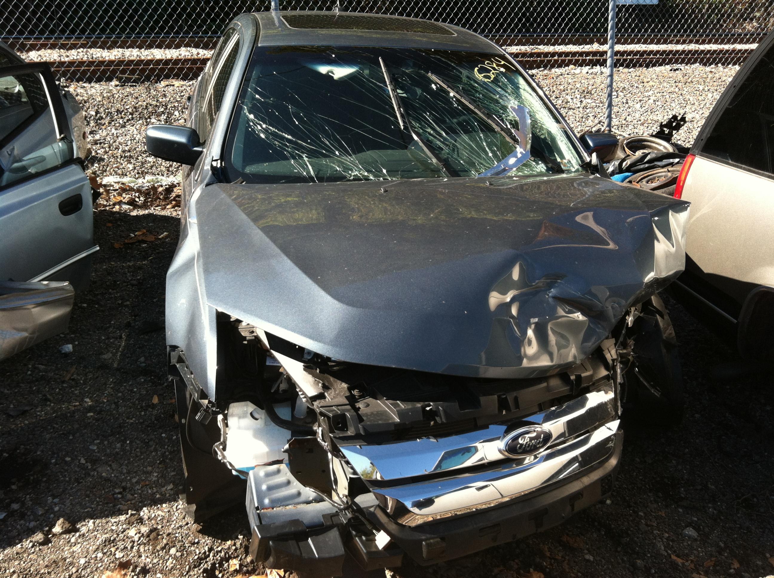

JC,
We are going to disagree. Unless you are driving on a track or under weather conditions where the wise would not, the the performance value of a car changes. I go for comfort, safety, reliability, ease of parts and service, mileage and the ease of reading and using the controls.
I had 1,000,000 miles under my belt without a moving violation or accident. Until the guy driving the import hit me. I walked away (O.K. Limped because I did have my foot on the brake.) He didn't.
Attached is what my car looked like after. (No damage to the passenger compartment!)
ES
