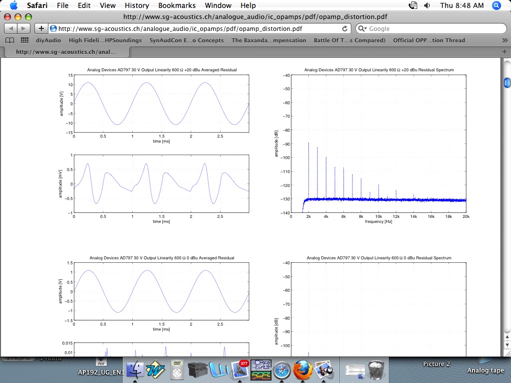

Got some data? What is the 7th and 9th for (say) a 797 or 4562 as a line amp driving a standard 10k load compared with (say) a Blowtorch or Parasound?

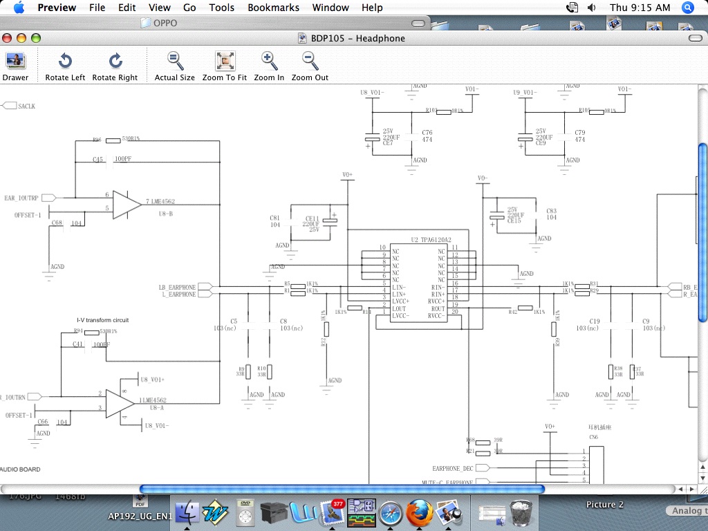

I have a design in front of me that uses a 4562 with a 350 ohm load. Do you see a problem with this? '-)
Yes. A 350 ohm load is meaningless in the context of home audio.
So, for home audio applications, do you have any data to support your assertion about inferior performance of good quality ICs with respect to 7th and 9th?

Yes, the current capability of this OPA is 42ma. With 35Ohm load, it allows... 14.7 volts -)I have a design in front of me that uses a 4562 with a 350 ohm load. Do you see a problem with this? '-)
We are far from the 100X margin we like 🙂

AD797: sample
OK, so you're saying you don't have anything with a 10k load (home audio) to support your contention? Or comparative data with a "high end" preamp like Parasound or Blowtorch?

I don't understand.Partial schematic with 'loading'
The output load is 2K (less the charge of the following circuit input i don't know).
The feedback resistor is 530 Ohm: Why ?
As it look like an inverting configuration, we need to know the source impedance to have an idea of the gain + the charge induced by this strange low value for feedback resistance, while they suggest 6 x more in TI application notes.
Notice TI measure the best figures for 2K load, i would use this value as a minimum, and certainly not drive a 600 Ohm load without an additional buffer..
