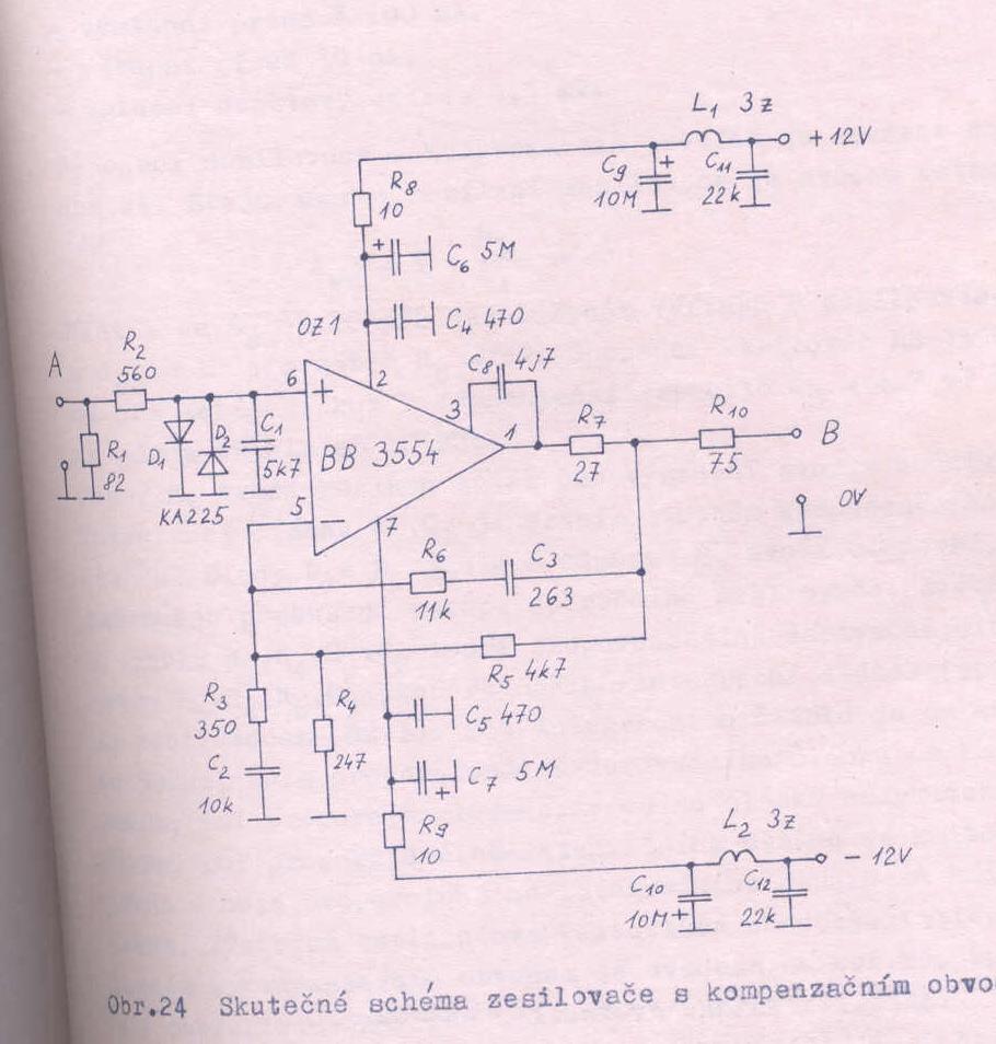

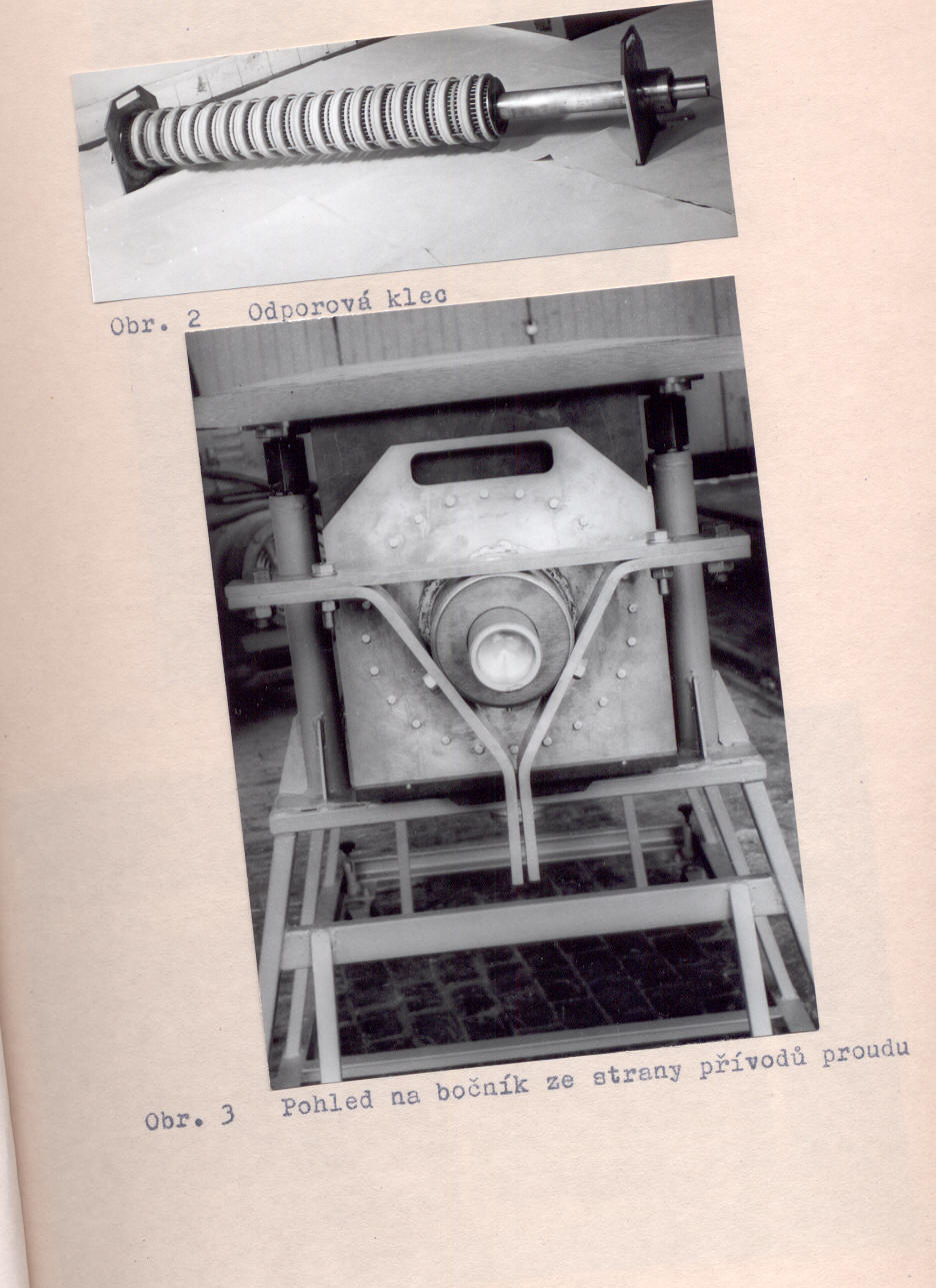

I was using the 3554 for near-to-zero current measurements of circuit breakers. The FB circuit contains squirrel cage shunt frequency compensation. Rshunt = 0.001 ohm. This schematic is 30 years old now.

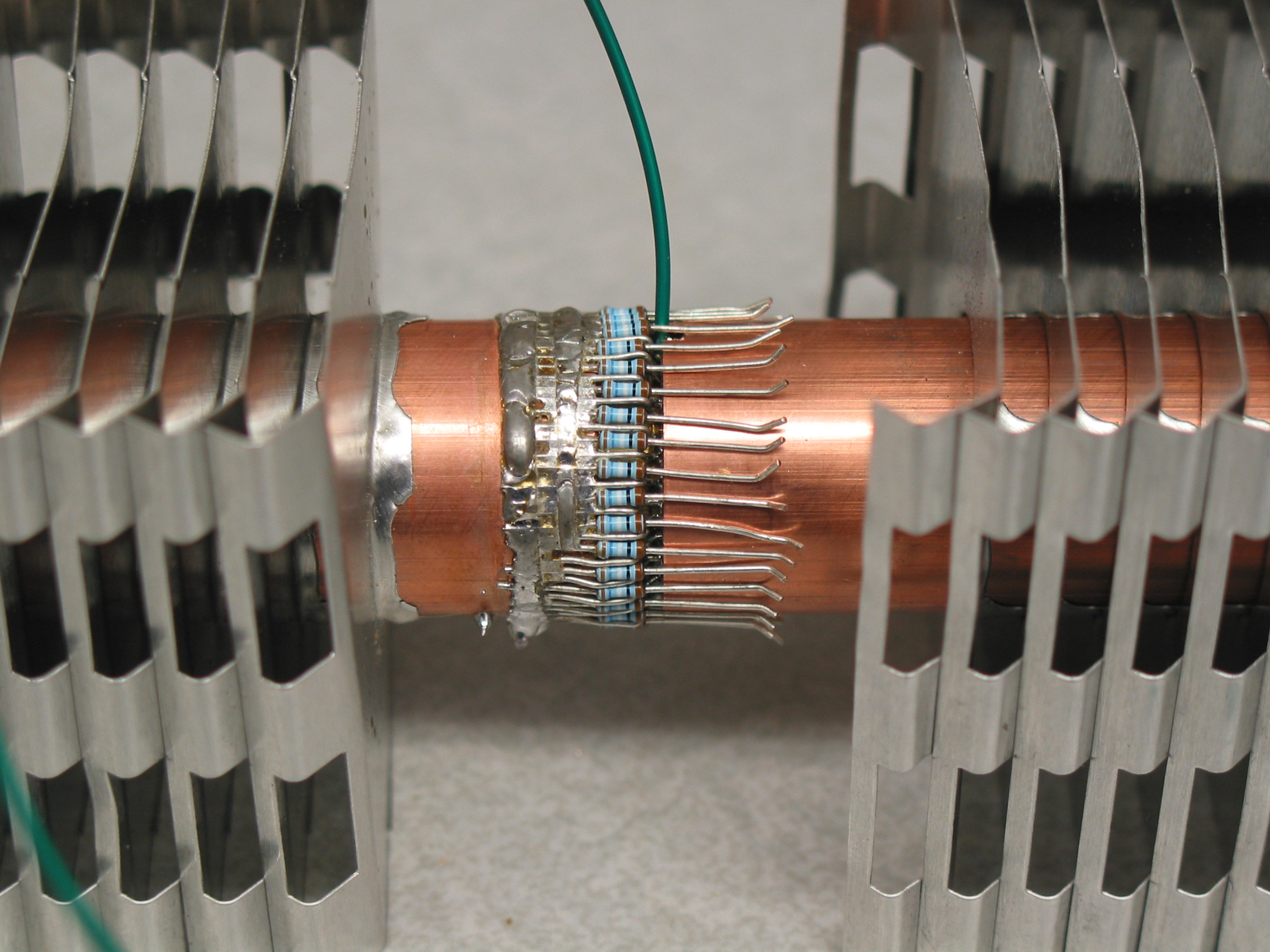

Squirrel cage? Is this what you mean?
In this resistor, the current comes from the right, through all the resistors in parallel, then returns through the wires inbetween the resistors. At the last moment, the wires bend inward radially, they are already soldered here to a slightly smaller tube inside the right tube, and the current exits coaxially on the right.

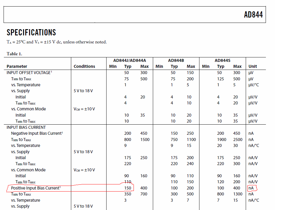

Really? Where did you get it. 150nA.
150nA is high - that's one of the draw backs of the 5532/34 (200nA typical).
You cannot direct couple to a volume control put because you get scratching sounds as you rotate the pot.
JFET opamps are great for this, but the LM4562 is also good at 10nA (typ) although input bias does rise with input common mode voltage.
A switched attenuator is the solution for high input bias opamps - yo cn then direct couple but the problem is they are expensive.
