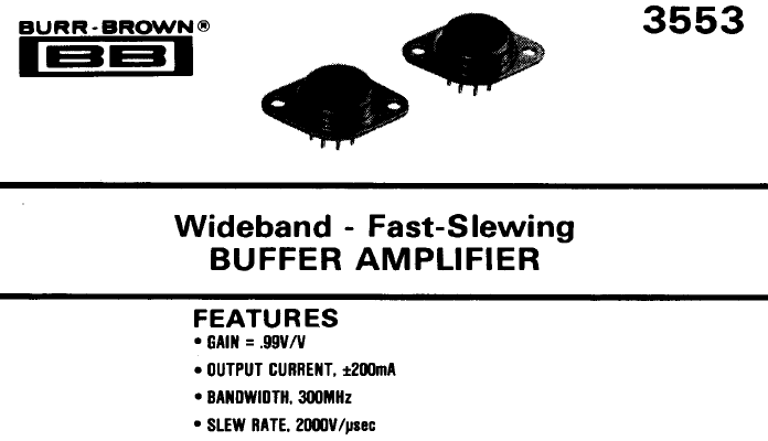

I have a plan to use a 3553 buffer, driven by 3554. They are fast but I didn't find current feedback has been mentioned in the datasheet. But I think it is. Not for audio, but why not? Any good comment to motivate me finishing the project? 😀
The 3554 is an old hybrid voltage feedback amp: http://www.datasheetcatalog.org/datasheet/BurrBrown/mXyzywq.pdf
