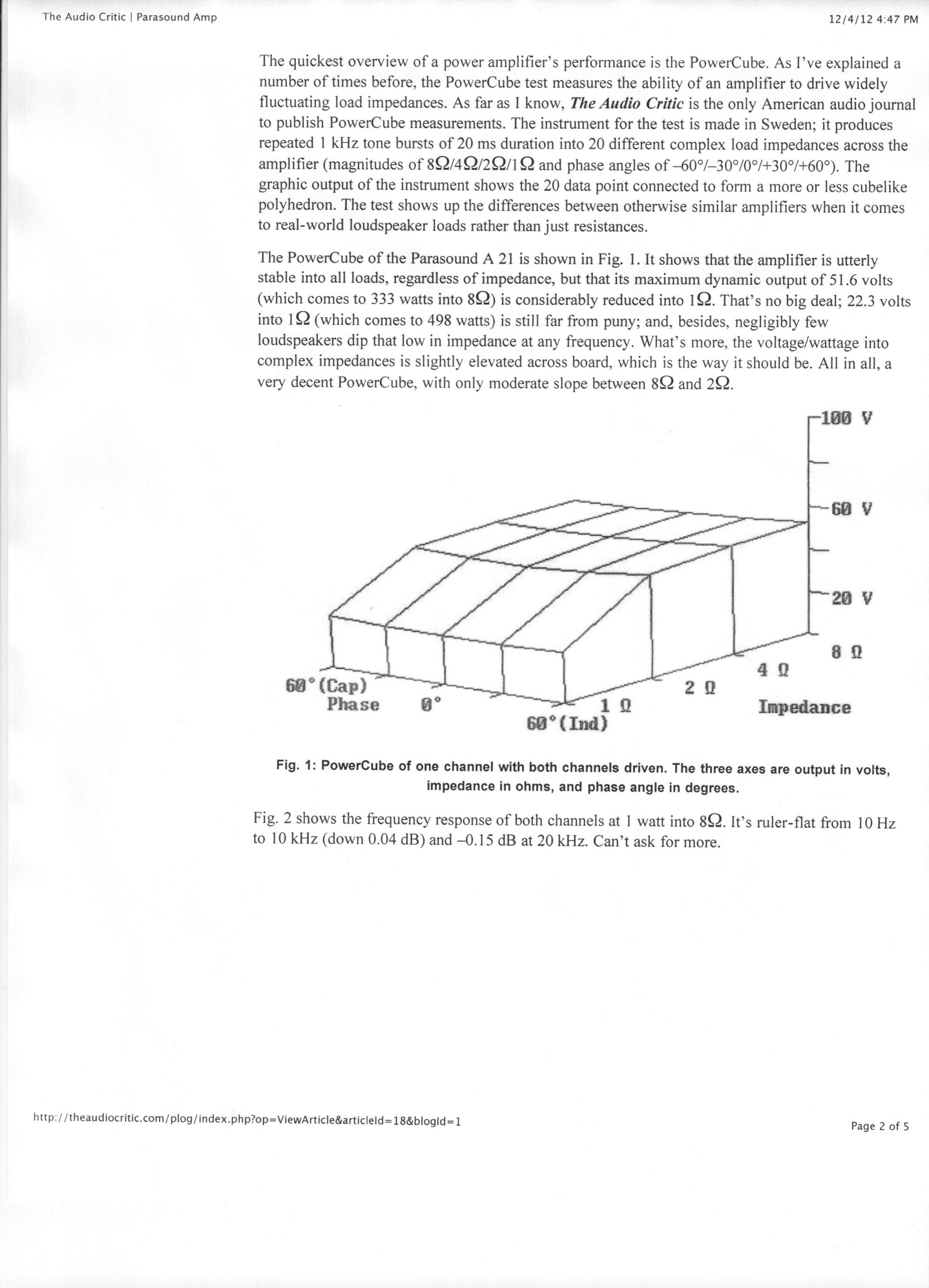

I would like to KNOW exactly what both of you insist upon to insure that an amp is stable. A coil will not necessarily do it, so don't insist on that. Just WHAT should designers do, that you suspect that we don't do, to test for stability?

Good enough for you, SY?
Thanks for joining in JC. If I list my tests, will you list yours? 🙂
Or are you going to insist that your designs can't possibly be unstable into real speaker loads so no testing is necessary ? I hope you won't take this attitude ... as you've taken with the Hirata & Quan tests?
