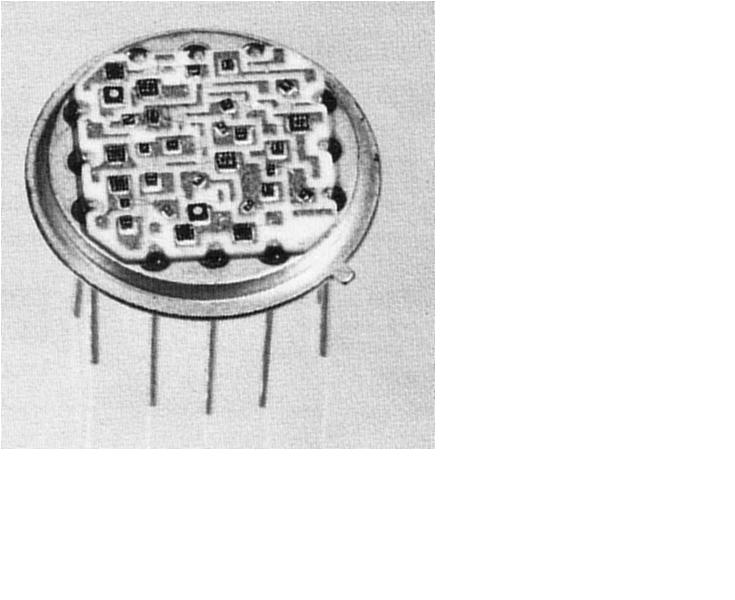

A hybrid is a device which is made using individual silicon chips, resistors, capacitors, and the occasional inductor epoxied or soldered to an alumina, beryllia, aluminum nitride, or sapphire substrate to create on a very small scale what we would do with a circuit board. It allowed chips of different technologies such as high voltage powerfets, low voltage low noise ic's, large and small value resistors, scr's, led's, whatever... to be used in a very small package. The linked device may have ten or 20 seperate components within.

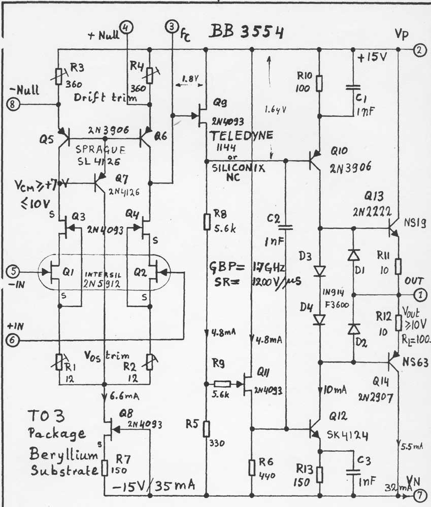

BTW, the schematic for the 3554 on the Burr-Brown datasheet I linked to appears to be at variance with the specifications, which suggest it has JFETs in the front end (the amount of bias current and its temperature dependence is a giveaway).
Thanks for the explanation. At least I know what to look into when I need to find further information. Coz it is hard for me to differentiate between "chip" and "chip plus". It shouldn't be just about size, but should be about different technology that make chips a different creature than discrete. It reminds me of STK "chips" (so that's why old STK documentation used the "hybrid" and "module" terminology in the datasheet). :cool:

I have the schematics of BB3554, but I think it was provided by Scott, if he agrees, I can post it.
From the looks of the schematic I saw yesterday and mysteriously appears to be inaccessible today, the drafting person lacked a symbol for JFETs and substituted bipolars. If the four input bipolars are changed to JFETs everything else looks pretty straightforward, indeed pretty boring.
Of course the part has been long discontinued.
No problem, there was a thread 2 or 3 years age when I posted many already. That schematic was reversed engineered here so it is correct.
Example of hybrid (not 3554)
