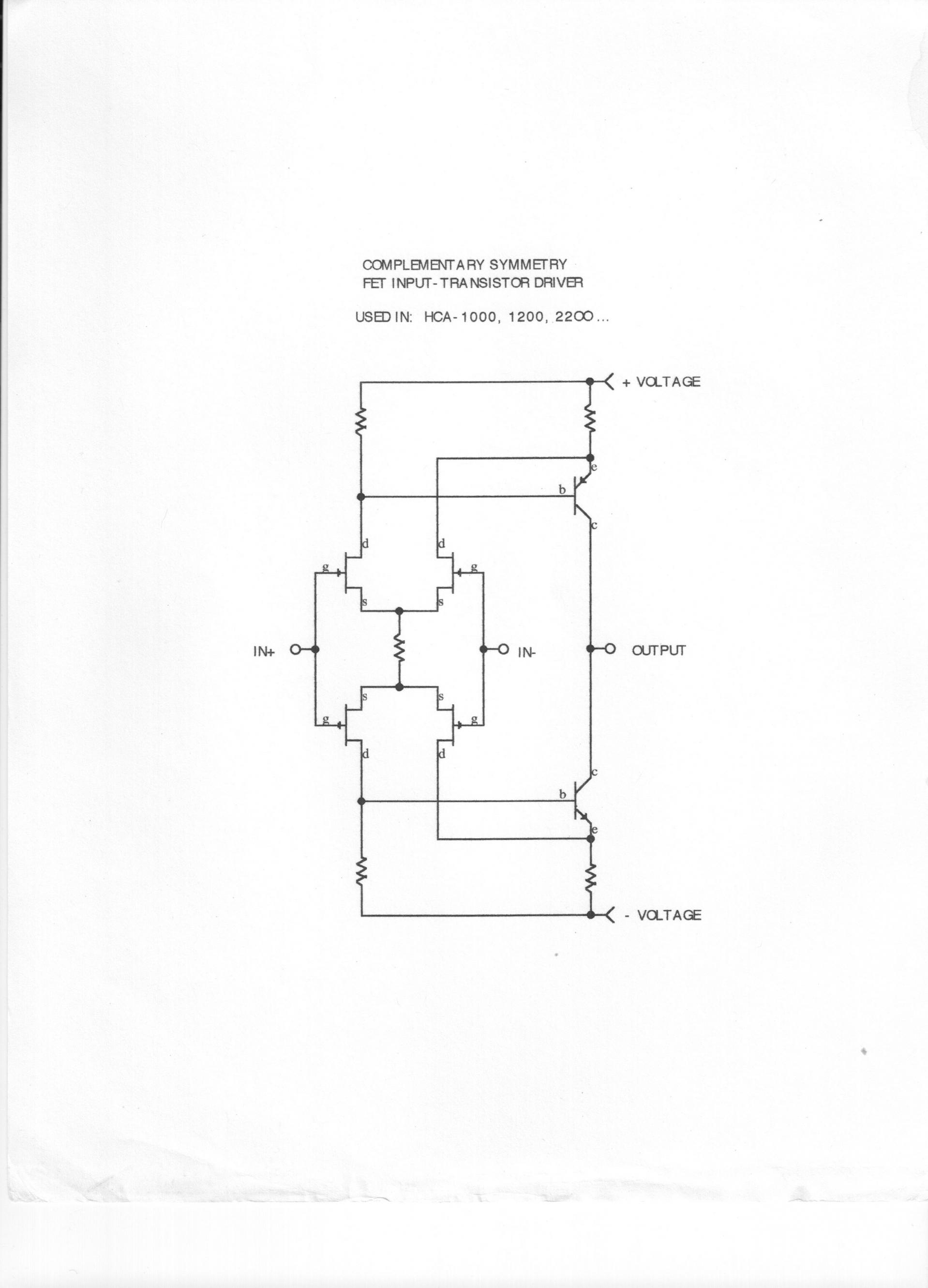

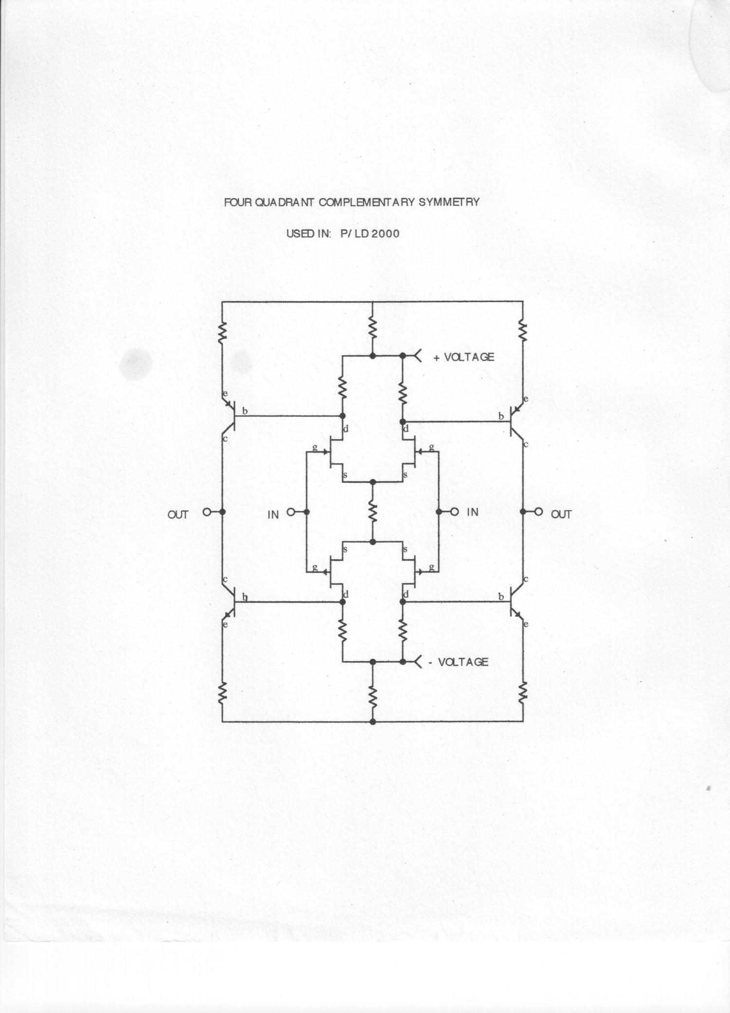

A couple of reminders. These are basic subcircuits that are used by Parasound, for example for amps and preamps. There are more sophisticated topologies, but they are harder to make, and are not used by Parasound for this reason.
I would next talk about the second stage connections to the complementary differential and its relative advantages over a single differential pair. As can be seen, the second stage has true push-pull in its second stage driver stage, whether it is single complementary or differential complementary. This is more linear, all else being equal than any single drive (with an active load, bootstrap, or resistor) or single differential with a current mirror, resistor, or active load(s). This is the second major advantage of the complementary differential input stage.

I've always been intrigued by the drive to the second-stage devices in your complementary differential topology. In your circuit, you differentially drive both the bases and the emitters of the second-stage devices, a configuration which I've observed tends to take the transfer characteristics of the second-stage devices out of the circuit from a sonic contribution standpoint (yielding a more sonically neutral sound to the circuit). This is different from most complementary differential topologies that I've seen, which usually just drive the second-stage device bases or feed the input-stage output signal into the emitters of the second-stage devices (which effectively converts the circuit into a folded cascode).
Could we get you to expound on the benefits of this elegant topology? Also, since it's your design, have you ever assigned a name to the circuit (as in a Curl "curl")? I've read that Grey Rollins asked you for a circuit name several years ago.

essentially the resistors can be considered theoretical, and the source of distortions becomes one of symmetry in layout/execution, symmetry and perfection in power supply, and most essentially, device matching.
When it comes to the devices themselves, it appears that the overall complex characteristics of the devices themselves will be the limiting factor in any distortions of high delta signal and it's handling. The error of the one (device) will accumulate into existence along with the error of the other (mirror). Inequities in the given mirror become the appearance of being the sole distortion component, if properly implemented.
The rest (distortions) will creep into existence (power supply, mechanistic symmetry issues, etc), as theory is not reality, no matter how much we may desire it to be.
Basically the circuit will be very neutral, nearing perfection, until high deltas enter the equation and raise the issue of micro differentials between the devices.
To the contrary , this topology is the best one
large signal mode wise...
I stated something that is... rather obvious, I hope, but maybe what I was saying was not interpreted the way I meant it, so I'll do as John has suggested. '-)
