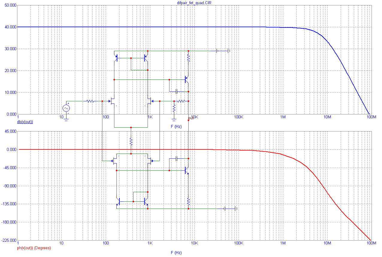

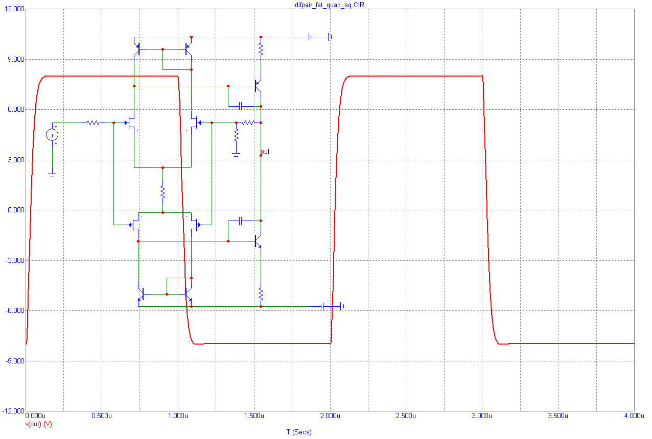

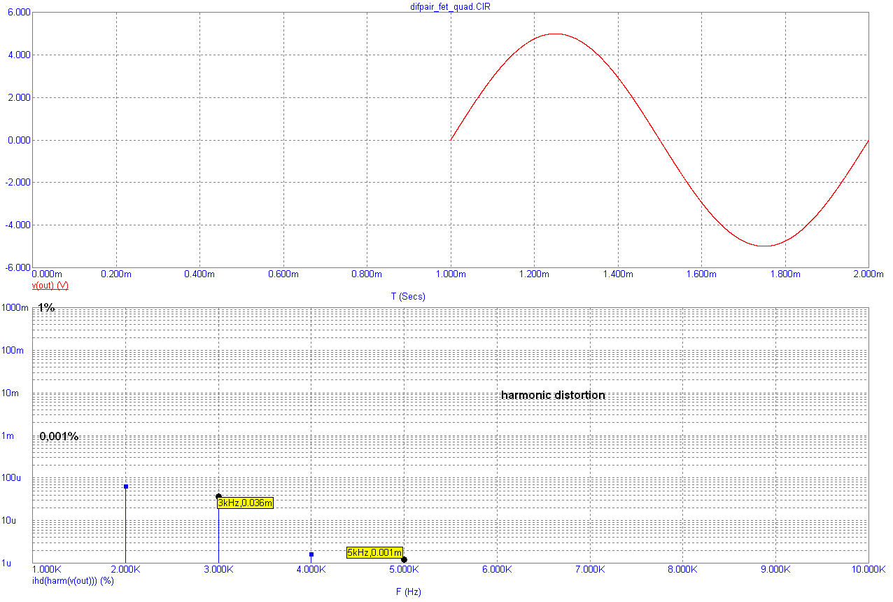

Some simulation results.
What about offsets? There is no voltage response to the output to common mode current in the output devices, i.e. as long as they are the same they could be almost anything.
EDIT - With 20mV delta Vp on the FETs circuit has no equilibrium for the two high gain nodes at zero crossing. At 5mV delta Vp the circuit finds equilibrium but the quiescient current of the output stage goes down to .6 mA from 3mA and the THD is not very good.

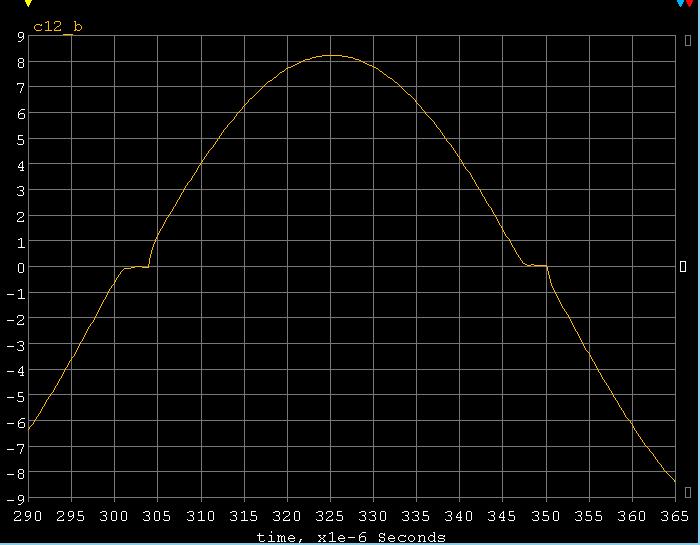

The quiescent current of the output stage is about 15mA in my circuit.
This circuit perpetuates the same design error as in the famous Randy Slone's book, fig. 11.4, discussed in extenso here: http://www.diyaudio.com/forums/solid-state/16796-unstable-vas-current-amp-slone-book.html
Essentially the output stage bias current is undefined; not only component dispersion, but also temperature variations will flip the bias current from zero to God knows where.
I doesn't matter if an output servo is added, the output stage bias current is not well defined even if the output is kept (by the servo) at zero volt.
Such "designs" work very well in simulators (perfectly matched components, etc...) but never work properly on the bench, or at least can't be reproduced with any degree of certainty.
