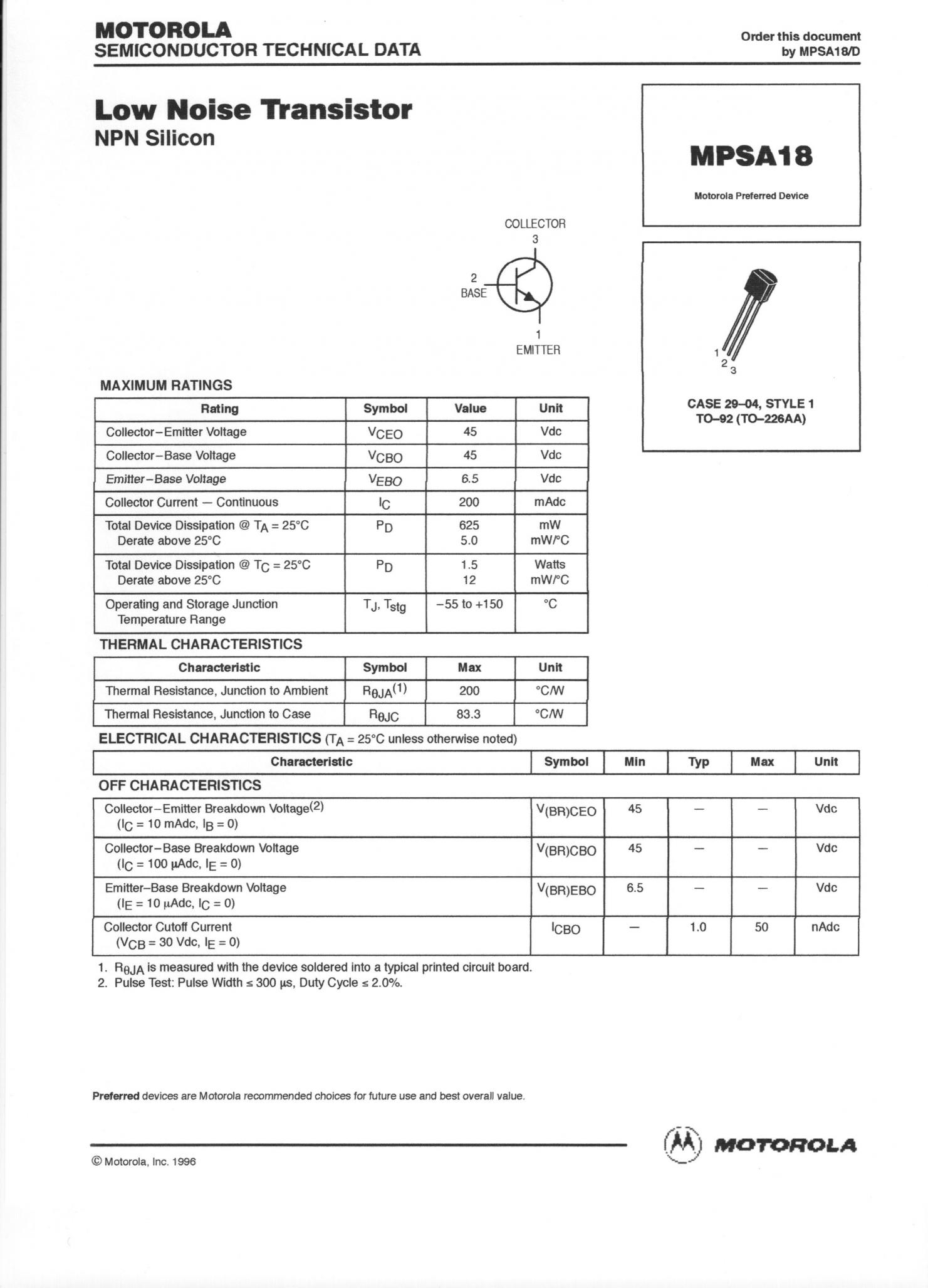

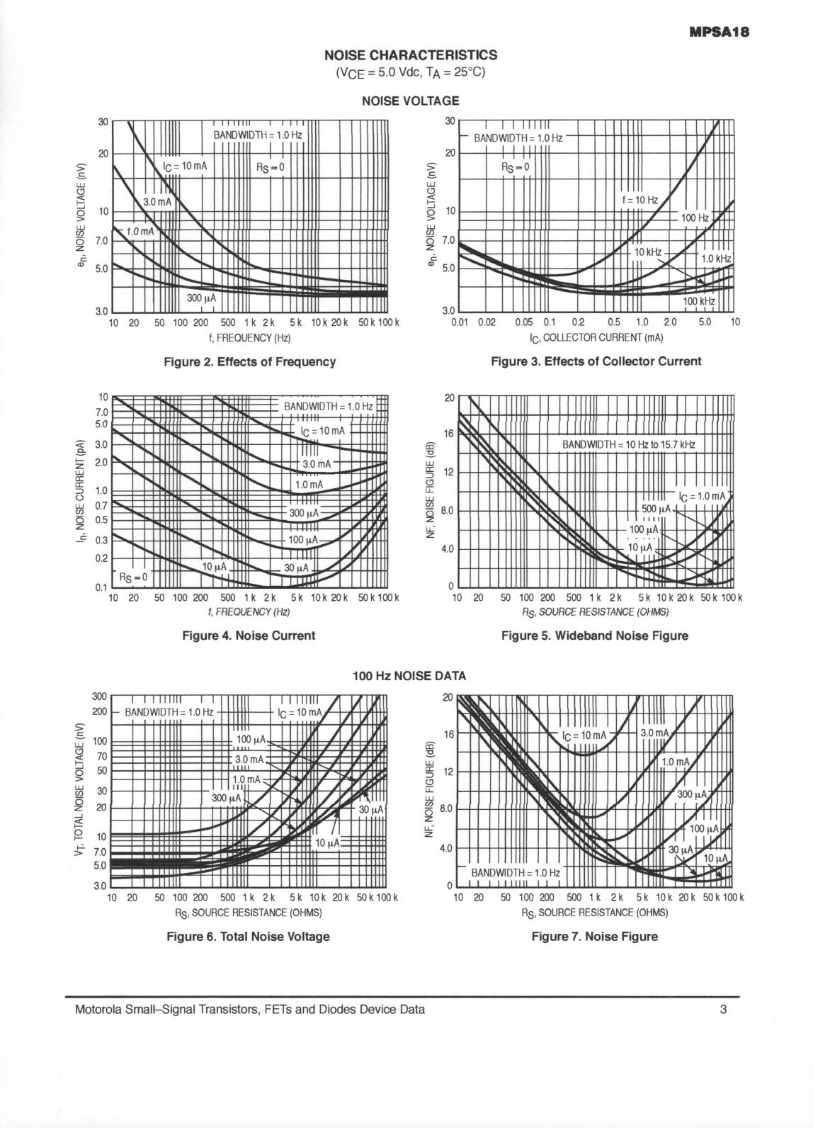

I hope to point out Noise Figure (a useful figure of merit in this case) with current with a typical low noise input transistor. Please note what happens with increasing current.

EDIT - MPSA18 a choice for low noise input ???? If this is meant to dissipate confusion go for it.
The MPSA18 is related to the 2N5210, which is complementary to the 2N5087. These are devices that we used more than 40 years ago for input stages. That is WHY they have a WHOLE PAGE devoted to Noise Figure. However, look what happens when you run at 10ma or more. That is why I put it up. These devices normally have a beta between 250 and 500 or so, which lowers the base current. They are fairly high voltage, and their rbb' is slightly on the high side, but typical for this range of devices.
OF COURSE, you can insist on a complementary pair, low Rbb' device with a similar voltage rating and a beta of about 500. I might sell a few to some serious customers. Not cheaply, though. Not made anymore.
It would be a waste of device, since Rs will probably be more than 100 ohms and typically 1K ohm. Then you are in trouble.
