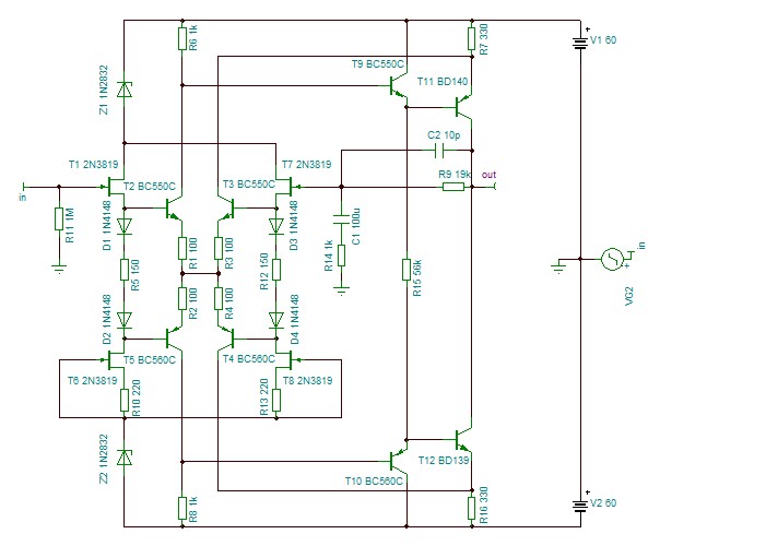

I did some thinking about this and came up with this...
I personally rejected it for use.
BTW, I cannot really claim that one, it's earlyish lower end Accuphase... Still, I can see uses...

T, further consideration of the circuit that you just put up shows a true engineer's understanding of the problems, and a practical solution that could have been effected even in the middle 1960's without too much of a problem, since the 2N3819 was available even then.

I agree, complexity is much up. But it allows very simple, cheap and generic parts to be used, which was my aim.
I suspect for the price of a matched Quad of 2SK170/2SJ74 we can buy a lot of 2SC2240/2SA970 and 2N3819 or similar...
Performace, I think it could be broadly comparable, if time is taken for optimisation...
Thank you for the flowers and yes, I agree.
It is truly a pitty that in the year 2012 we have to resort to such circuitry. I would have expected some form of monolithic J-Fet quads in big 12-Pin TO Metal Can enclosures instead of we are getting, just goes to show WTFDIK...
It sorely lacks the elegance of your complementary J-Fet solution and as it so happens, I do have hundreds of matched K170/J74 pairs (marked to 0.01mA Idss per pair) around, so I do not have to use it... 😛
Ciao T
It would work, but at what 'price' in complexity and performance?
