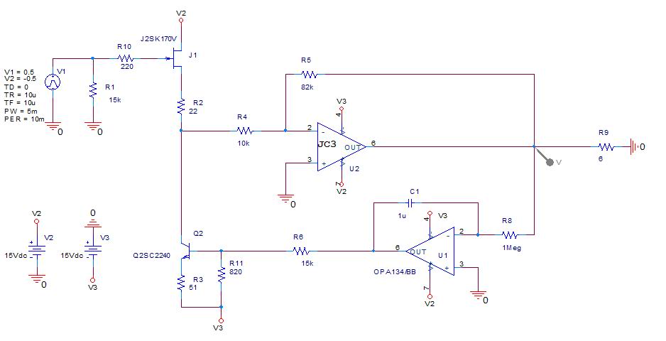

I can get a good price for 100 boards. I will not buy that many until I build a prototype and make sure the board is correct. I am only 99 % sure until it is built.

R5 and R17 are 10 K on original. I will post a parts list after the 1st prototype.
Please mark it up on your schematics.

Mike,
I think you'll find that 500 Ohms is a pretty high value for R25 unless you're intending to run the front end really, really lean. Assuming that you're going to be using BL parts for the front end, a fixed resistor somewhere between 10 and 50 Ohms would probably suffice depending on the Idss of the actual parts. If you're using a pot, something along the lines of 20, 50, or 100 Ohms will do nicely.
Won't make any difference in your layout, though.
You might want to consider an option on your PCB to run the front end on a separate, regulated rail. John's self-biasing complementary differential has only so-so rejection of rail nasties. I'm using separate, regulated rails for both input and output. My input rails are higher than the output rails--something that you won't have to do.
I wish you luck on your design. I'm in the process of building a second channel so as to be able to listen to my version. Hope to have two channels running by the end of next week or perhaps the week following. The PCBs are ready; I need to stop and do metal work so as to have heatsinking for the output stages. Either that or pay someone else to do it and hope they get it right. Neither option appeals to me. Ugh.

Thanks, Grey. I will be changing some values when I build this. I will use your input. The resisters between the output and the input is a good spot to split the power supply rails.
What do you think use the Pass Labs X 350 toroid, 65 volts for the front end and 55 volts for the outputs???
Split at R26 & R31? Yeah, looks good.

be aware that this amp can be unstable when the source is disconnected, some sort of the input buffer will be helpful
Mine's stable as a rock. I don't see any reason it should be any worse than any other circuit regarding stability. Actually, mine's probably more stable than most because it's inherently rather low gain and there's no feedback, hence no phase-shifted stuff coming in the back door.

Just in case instability occurs
Altough it is certainly adding distorsion I think that the solution posted back here might take care of this problem... plus a list of several others: eliminates the input coupling cap, allows the use of a potentiometer at the input, isolates the influence of preamp output Z on gain and of course should also work as servo. As is the schematic is not updated with John's usefull recomandations.
Unfortunately as far as I'm concerned, after the dualFET GB mishap, I had to postphone this project. Reason: I can't use the singles because the supplies I had in mind are a bit too high: regulated +/- 27 for input and driver, +/-25 unregulated for output stage.
dimitri said:be aware that this amp can be unstable when the source is disconnected, some sort of the input buffer will be helpful
My circuit is DC coupled, hence no caps in the signal path unless you want to use one as a high pass. Each input is connected to ground (at present by 100k) setting the Zin and making things behave.
To the extent that you want to more faithfully reproduce John's original circuit I don't believe too much violence would be done to the concept if you were to use a large resistor to ground at the input. Yes, it would change the feedback somewhat, but it would ground reference the thing.
Running feedback back to the input isn't the most common way to do things, but it works. (I do it in my main tube amps.) In this case, the cap allows the DC offset pot to control the circuit independent of anything else going on out in the world. If you're brave and happen to have a tube preamp (hence already cap coupled unless you're using something like the Atma-Sphere) or a solid state preamp that happens to be cap-coupled (like some of Nelson's designs), then you can begin by deleting the input cap on the JC-3. If you're certain that there's no DC at the output of your direct-coupled preamp, you can go one step further and see how things go without the cap.
Me? I'd stick in a high value ground referencing resistor, anyway, just to be sure. 1M, 2.21M, 3.32M, something big so as not to load the feedback any more than necessary. At these values, even the minor Gate currents in JFETs can begin to cause offsets, but you should be able to adjust things with the pot.
