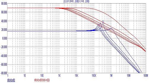

probably that is why you need that high C10 and C11 (130 pf)C9 680pf
I made a mistake ordering two boards, I should order more and help you to tame it. Nevertheless, you can send me working board and I'll measure it with AP/check stability, etc
That is just what I happen to have. I don't think there are any problems with the board so we can order some more. I will finish building up this board and can send it to you. Do you need the heatsink? Do you want me to send the other board?

I took out the 130 pf and changed them to 22 pf.
I have taken C9 out. I have the other channel built and working.

Please mention Toshiba and Sanken pairs, I'll check my piles. What are the minimum overall dimensions for the heatsink? I have different ones and I can use forced cooling. The only inconvenience is the absence of drilling press at home.
You will need one that will be good for 80 to 100 watts. I will send you the one that I have used for testing. It got up to 50 deg C after 30 minutes. It was dissipating 112 watts.
at what Vce?MikeW said:You will need one that will be good for 80 to 100 watts. I will send you the one that I have used for testing. It got up to 50 deg C after 30 minutes. It was dissipating 112 watts.![]()
Tc=50degC or Ts=50degC?
How far was this above the temperature de-rated SOAR for the test Vce?
Temperature of the heat sinks. Enough above the SOA not to blow up anything.
