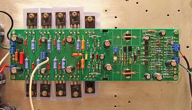

The layout still needs to be checked.
You should be able to put them in the existing holes.
john curl said:Caps MUST be polypropylene, mica, better. Big problems here with this layout.
New layout coming.

Much better layout! Good work Mike!
Thanks for implementing some of my previous ideas.
Looks like you have added a cap, C9, yes?
Could you maybe update the schematics with the correct schematic symbols and all values?
Some comments on the layout:
a) How about adding a screw hole in the middle of the PCB for increased stability?
b) Would be nice to have another GND connector next to the output GND.
c) The pad for C8 looks a bit too small. What type of cap did you have in mind here?
d) The wire connection that is just above "R3" looks a bit weird.
e) As you noted yourself, C7 and L1 should have other sizes. L1 could actually have the pad size of the pad for C7, and vice versa.
f) I would like to have a smaller cap (~10-100n PP) in parallel with the 100uF caps just next to these bigger caps to stop noise/RF from entering the board wirewise
What do you think, Mike?

a. not needed
b. It has 2 holes for ground.
c. 5-10 pf
d. It will work
e. yes
f. I'll think about that one.
MikeW said:latest schematic
Thanks, Mike.
C9 should be connected after R9 if you want it to work as part of an RC LP filter removing RF. Now it is before R9.
Sigurd
