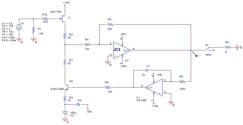

While waiting for my dual FETs I've been thinking on how to servo the JC-3. Only in the simulator for the time being...🙁
Provided that the input FET (J1 in the attachment) is able to drive it, how much can I lower the gain setting resistors of the JC-3 (R4, R5) without getting into serious trouble? I imagine that the two 1M resistors should be lowered as well in order to keep the ratio with R4 constant.
In relation with my first question, I would also like to increase the overall gain to -10. Will the performance be greatly affected?
Thank you for your time and for sharing your design with us!
It would be easier to directly sum it into the - input.
A Burr-Brown 134 would be a better choice for a servo. Fet input only, please.
It might be easiest to use a 2134 to get polarity inversion. 1uF-1meg should be the time constant.
Thanks for your reply,
The sugestions for using a 134 and about the time constant are taken. I was thinking to use this type of servo to 'isolate' the gain equation from preamp output Z, cable L/C...
(some of my friends - 2 actually - have tube preamps and... other home made exotic gear with output Z vs freq unknown. I know I should increase the 15k on the input when visiting the tube guys.)
Even better, add 100 ohm resistor to + input and ground. Then connect 15K (R6) following servo op amp directly to the 100 ohm resistor.
