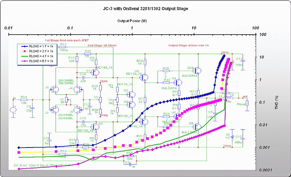

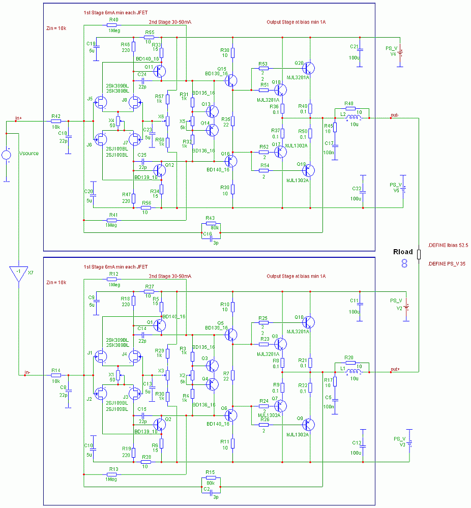

John do you like this layout better?
I would like to make a few prototypes to prove out the board. If there is a lot of interest I can have more made. If someone wants to run more boards I can send them the gerber files when I get them.
Sig, it certainly looks to be in the 'ballpark'. I should get the original unit out of storage and measure it sometime. In 1974, when we first made this design, it was specifically used with an Electrovoice T350 tweeter that had a sensitivity of 108dB/W or so. So, even at 1W, it was really, really, loud. It was designed for 8 ohms originally and modified (like you have) to also be OK at 4 ohms. That is about as low in impedance as we ever thought it would be used.
I am glad that you added the series resistors in the bases of the devices. Originally, we only used 4 MHz devices or less, and the series resistor did not seem necessary. Later, when we switched to ring emitter transistors, we added base resistors out of necessity, given the advice to me by the 'late' Jon Iverson.
