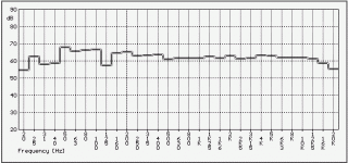

I think everyone would be more than happy with the in-room FR below.

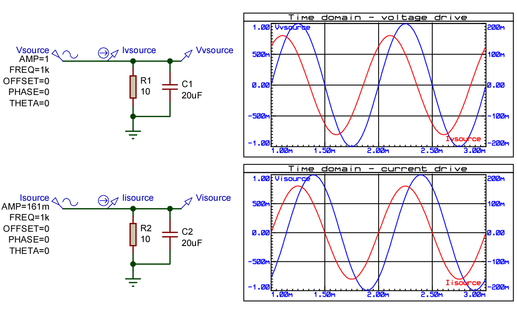

This is the statement I am uncomfortable with:
'Now I want to make a statement that I believe is an essential issue. The voltage source can produce current - no doubt about that - the problem is that it can also produce current of any phase angle. But a genuine current source can only produce a phase angle of zero since it sees it own output impedance as a series resistor of (ideally) infinite value. The voltage produced across the final load will always track current and voltage together without contamination.'
Jan
OK, went and simulated such a situation. A voltage source driving a reactive network, versus a current source driving the same reactive network.
Graphs show voltage across the network (left axis) and current through the network (right axis).
Top with a 1V, 1kHz V-source. As predicted by theory, the current leads the voltage because of the C.
Now I changed the V-source to an I source, with the same amplitude as the current that I saw in the voltage drive case, which happened to be 161mA.
The result - exactly the same! This current generates the same 1V amplitude across the network as in the first case. Phase shifts are the same in magnitude and relation.
Only difference is the start of the zero crossing of the generator, which is (of course) voltage in the 1st case and current in the 2nd case.
So you may want to remove this 'essential statement' from the project description to avoid further embarrassment.
As well as the 'noise' stuff which also is nonsensical.
Jan

Mark, it wouldn't make any difference. The simple math (no fancy sim needed) shows that I and V through the load will not be in phase if there's reactance (which every driver has). Period. You can stick an impedance flattening network across the load to waste some power, but I vs V for the load is still unchanged.
