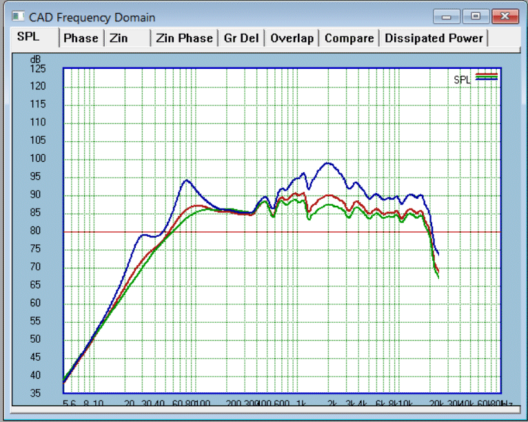

But in the mean time, to be fair, you just posted this plot:
You state green is output Z = 0.01, with and w/o comp. I'm satisfied that it would also represent the response with output Z = 5 when the Z comp is present to reasonable accuracy. Red is Z out = 5, w/o Z comp. So we can all take red and green as representative of your triode amp driving the speaker with and w/o Z comp.
Are you still going to claim that the response differences shown between red and green are inaudible? Your claim is of increased clarity with the Z comp networks regardless of the amp. How can you make that claim,; how can you make that assessment; how can you make that subjective evaluation, when FR differences of that magnitude are present? Surely you aren't going to sweep FR differences of that magnitude under the rug and claim inaudibility, are you?
So, as far as I can see, you can listen to the speaker with your solid state amp, with output Z = 0.01, with and w/o Z comp and make the conclusion of increase clarity with the Z comp. You can make any claim you like, as far as I am concerned, as to why. I don't care. I, personally, would still point to the amp's characteristics into the different load as it is the most obvious. I could even go as far as saying the increased current draw from the amp places the operating point at a different point on the load line. Or increased current draw increases the junction temperature places the transistors in a more linear region. There are many reasons the amps characteristic would change under a different load. There aren't any reasons the speaker would sound different, other than the input signal is different. And again, the input signal is a function of the amplifier and it operating point. But, BUT, BUT, what ever the reason for increased clarity is that particular comparison, you can not carry it forward that increased clarity results for all amps, regardless of output Z, when, as you yourself have shown, the FR changes significantly. You simply can not make the same subjective or even objective evaluation when more than one parameter changes.

That's a funny plot. The 5 ohms Zout should lower SPL output by some 4dB with a 8 ohms load if noting else than a voltage divider. So how can they be exactly on top of each other? Or did you normalise the output to be the same?
Jan
Jan, this time you owe me an apology.
Do you not read my post carefully? Did I not say "offset" !!!
Good grief!
Yes.

By the way Joe, regarding my post about the observed difference in your measured FR with the comp network in place for amps with near zero and 270 ohms output Z, here is the quote from your initial post:
http://www.diyaudio.com/forums/mult...-usher-s520-current-compatible-crossover.html.
So, I take back my apology. Hey, it's your data.
