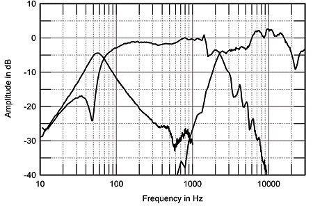

From zero to 270 Ohm, this is how much the response deviates:
Red is zero Ohm and Green is 270 Ohm.
Now let's look at how this affects the crossover:
So the crossover is LOCKED IN.
Look carefully, there are TWO lines overlayed and you can hardly tell them apart in the crossover region. At least from an engineering point of view, that has to be some kind of achievement.
Can you imagine what it would look like with the standard Usher crossover.
This is how it looked - but add 270 Ohm, what do you think would happen to those crossover curves. It would be a disaster!
So, here is proof, that we do not hear any tonal balance nor are there any audible frequency response changes, from zero Ohm to 270 Ohm. The Hypex NC400 Class D amps (very good indeed and a bargain) has, I believe, an output impedance of 0.1 Ohm.

To me those graphs look like the major difference is in the woofers lowpass. JR's version has smoother roll-off and thus obviously better phase match. 4kHz (resonance peak) of woofer is 15dB down in original, only 10dB down with JR's
I accept also the smoother impedance /phase angle making the load easier for the amp. But I have no idea about how that would make the sound cleaner -distortion?
