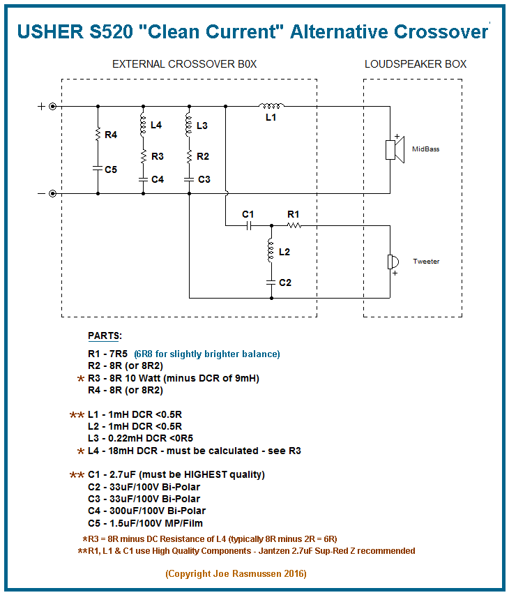

Joe Rasmussen Usher S520 "Current Compatible" Crossover
Isn't the Usher just a pair of commodity drivers in a nice looking box? It seems that many could build a comparative set of speakers and try it out. Just list the driver models and I imagine those are available in many countries.
As seems very likely from previous discussions, the difference probably is mainly caused by the amp reacting differently to a flat impedance. Which means the effect is not specific to this particular speaker.
With that in mind we could test the hypothesis with any reasonable speaker, as long as it has a 'wild' impedance curve.

I just want to reiterate what I have said a number of times:
IF this is making an audible difference, then we have concluded that the improvement is not to do with the amplifier, but rather that of the speaker itself.
I only use the IF world because of those who not heard the benefit. The most I have claimed is that there is a noticeable improvement in 'clarity' and I have not been making outlandish claims using flowery speech or lots of wonderful adjectives. All that has been claimed is that it is a benefit and I would prefer people to describe what they hear in their own words.
Since more than a dozen designs are out there and in various hands, with all kinds of different amplifiers, indeed we have also tried it with wildly different topologies, indeed I have here three more than average sounding amplifiers, tubes, solid state, Class D and the transconductance amplifier design published here with a 270 Ohm output impedance.
From zero to 270 Ohm, this is how much the response deviates:
Red is zero Ohm and Green is 270 Ohm.
Now let's look at how this affects the crossover:
So the crossover is LOCKED IN.
Look carefully, there are TWO lines overlayed and you can hardly tell them apart in the crossover region. At least from an engineering point of view, that has to be some kind of achievement.
Can you imagine what it would look like with the standard Usher crossover.
This is how it looked - but add 270 Ohm, what do you think would happen to those crossover curves. It would be a disaster!
So, here is proof, that we do not hear any tonal balance nor are there any audible frequency response changes, from zero Ohm to 270 Ohm. The Hypex NC400 Class D amps (very good indeed and a bargain) has, I believe, an output impedance of 0.1 Ohm.
There is another nice little thing to point out, the DCR of the series inductor of the bass is cancelled out. Because the compensation is seen directly by the amplifier and the series inductor is compensated for, it's DCR is effectively zero in a system sense. You can, if you think it worthwhile, use a much smaller inductor with larger DCR, that is of course a design choice, but whether high or low DCR, it is accounted for.
But have to say, this works best for sealed boxes.
But coming back to the point, we have now used this type of crossover with just an infinite number of amps (number unknown) and I think I can say emphatically - the speaker is making the difference here, but of course we shall always need a more than average amplifier to show it up.

It is the amplifier working better into a resistive load. Lower distortion for several reasons. No doubt in my mind at all. 😎
Look at the original impedance corrected speaker circuit:
Without impedance correction the top end is just like one of my own rough sounding disasters:
Because the impedance goes almost infinite at ultrasonic frequency, before the amp Zobel kicks in. Because the tweeter goes inductive. Easy to fix, once I knew what the problem was. A Zobel or a simple resistor can do this.
The Current/Voltage/Feedback/No Feedback amplifier part is a red herring. They all work the same into a RESISTIVE FLAT load. Which is what Joe is saying really.

To me those graphs look like the major difference is in the woofers lowpass. JR's version has smoother roll-off and thus obviously better phase match. 4kHz (resonance peak) of woofer is 15dB down in original, only 10dB down with JR's
I accept also the smoother impedance /phase angle making the load easier for the amp. But I have no idea about how that would make the sound cleaner -distortion?
