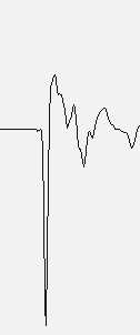

To see what current drive does just measure the impulse response of a woofer in air, do the same with a voltage drive and compare them. This just to rule out other "components". It will be self-evident that the former is far better. Also the decay is shorter and cleaner.

This is a real measurement. I know it's counter-intuitive but that is.
I do run simulations for work but I know they work.
I don't do it for audio because it's just a hobby for me. Only run some measurements sometimes to verify I am really getting what I think.
