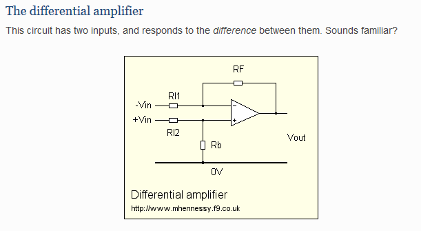

If you've built preamps and power amps and current amps, as I have, you really have three major problems. Stability in feedback, requiring compensation which reduces transient response and slewing rate or a defined stable load. Common-mode caused by earth-rail noise breaking into the signal path below with mismatched resistors in the arms in unbalanced mode:

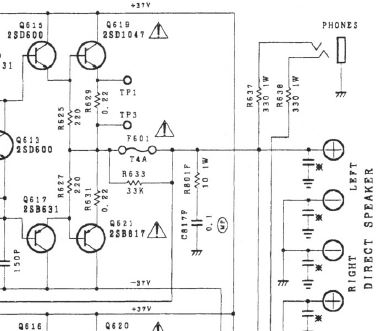

And crossover distortion which reduces current output ability at the zero volts crossing:
541537d1459701800-joe-rasmussen-usher-s520-current-compatible-crossover-rotel-ra931-output-stage.jpg
All these things make or break an amplifier, and IMO, get considerably easier with a flat resistive load around 8 ohms.
542044d1459901954-joe-rasmussen-usher-s520-current-compatible-crossover-differential-opamp.png
If I understand you, you are saying that currents on the ground "rail" can induce a voltage across RB and hence at the input to the amp. Where is the common-mode component? Your picture seems to show a differential-mode noise source. Can you explain how that is common-mode? Maybe you need a new picture?
You keep showing that fragment of a schematic, but I don't see the crossover distortion, nor how it varies with load. Could you please find a graphic which shows what you are talking about?
Nezbleu asked:
System7 answered:
My point is that opamp preamplifiers often break the established rules of common-mode rejection. Below is the Rotel RA 931 preamp. Surely not wildly different from the ideal theory. But not bad, and adjustable, if you accept that the perfect is often the enemy of the good.

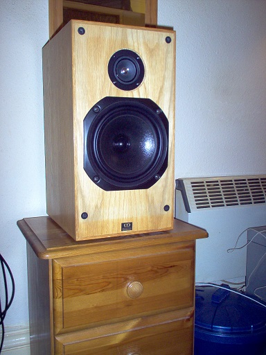

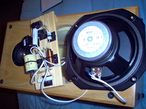

OK, guys, as you know I'm not a complete newbie when it comes to all this crossover and speaker and amplifier stuff. I actually know stuff. I can measure, if interested. I know the theory. I can listen to the final result.
So, er, what do you suggest I do with my speakers to make them sound better?
I mean, just throw out ideas. I'll do it. I can build most stuff. 😎

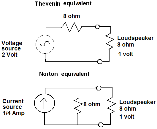

541536d1459701800-joe-rasmussen-usher-s520-current-compatible-crossover-norton-thevenin-equivalent-drive.png
I have built this stuff. I know how it works and Joe Rasmussen with his flat resistance ideas is nearer right than you are. But, hey, fools must pretend to be wise, eh?
BTW, thank you for taking us off-topic. Nothing like distracting from the real issues. Now can we get back to my inconvenient Real World speaker. Any ideas?
