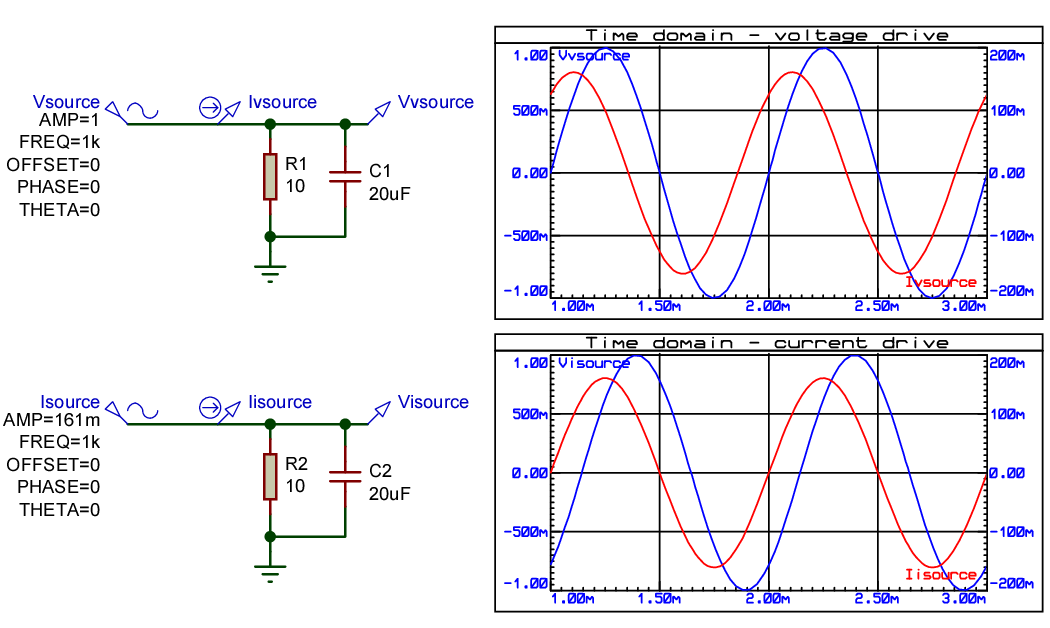

At one point I tried to clarify things for Joe; Joe is this what you mean? A picture and 1000 words and such?
OK, went and simulated such a situation. A voltage source driving a reactive network, versus a current source driving the same reactive network.
Graphs show voltage across the network (left axis) and current through the network (right axis).
Top with a 1V, 1kHz V-source. As predicted by theory, the current leads the voltage because of the C.
Now I changed the V-source to an I source, with the same amplitude as the current that I saw in the voltage drive case, which happened to be 161mA.
The result - exactly the same! This current generates the same 1V amplitude across the network as in the first case. Phase shifts are the same in magnitude and relation.
Only difference is the start of the zero crossing of the generator, which is (of course) voltage in the 1st case and current in the 2nd case.
So unless this is NOT what Joe means, it appears to me that the reason he has issues to explain what he means is that what he thinks how it works, is wrong.
