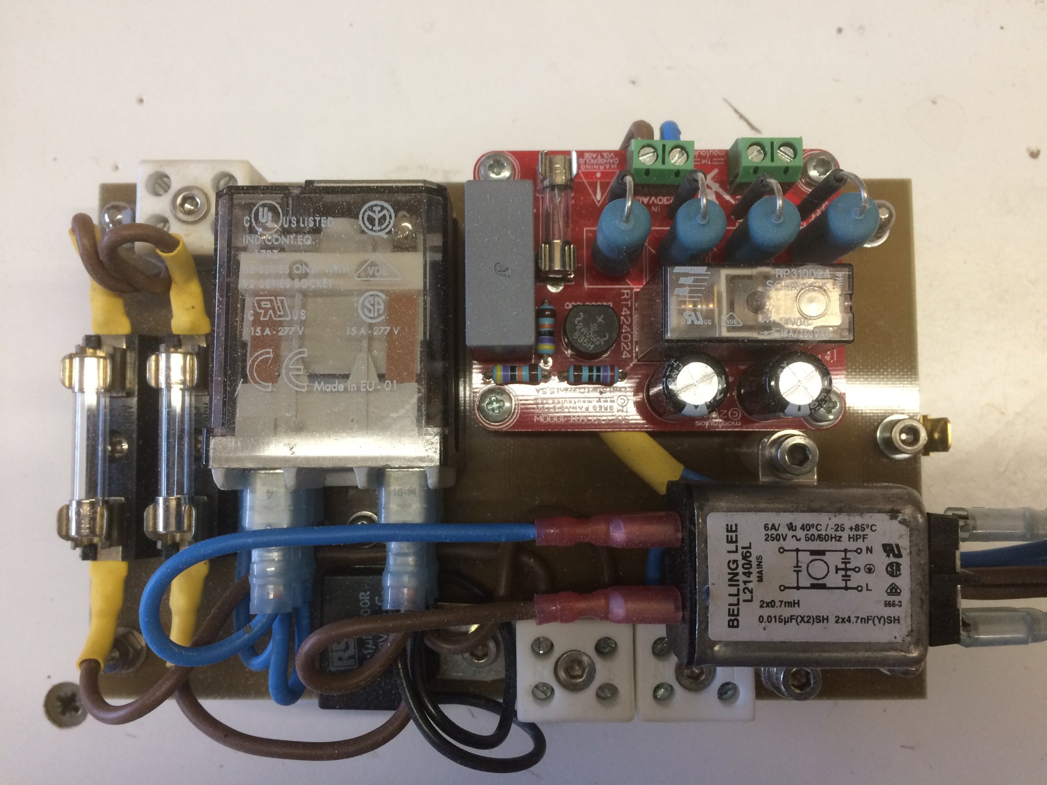

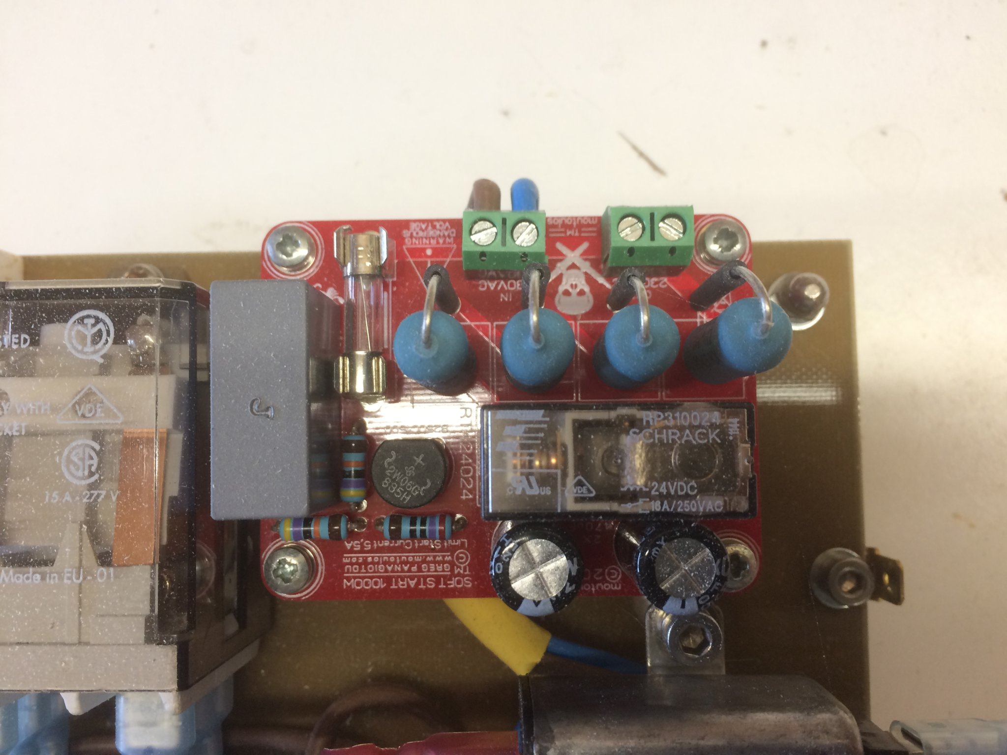

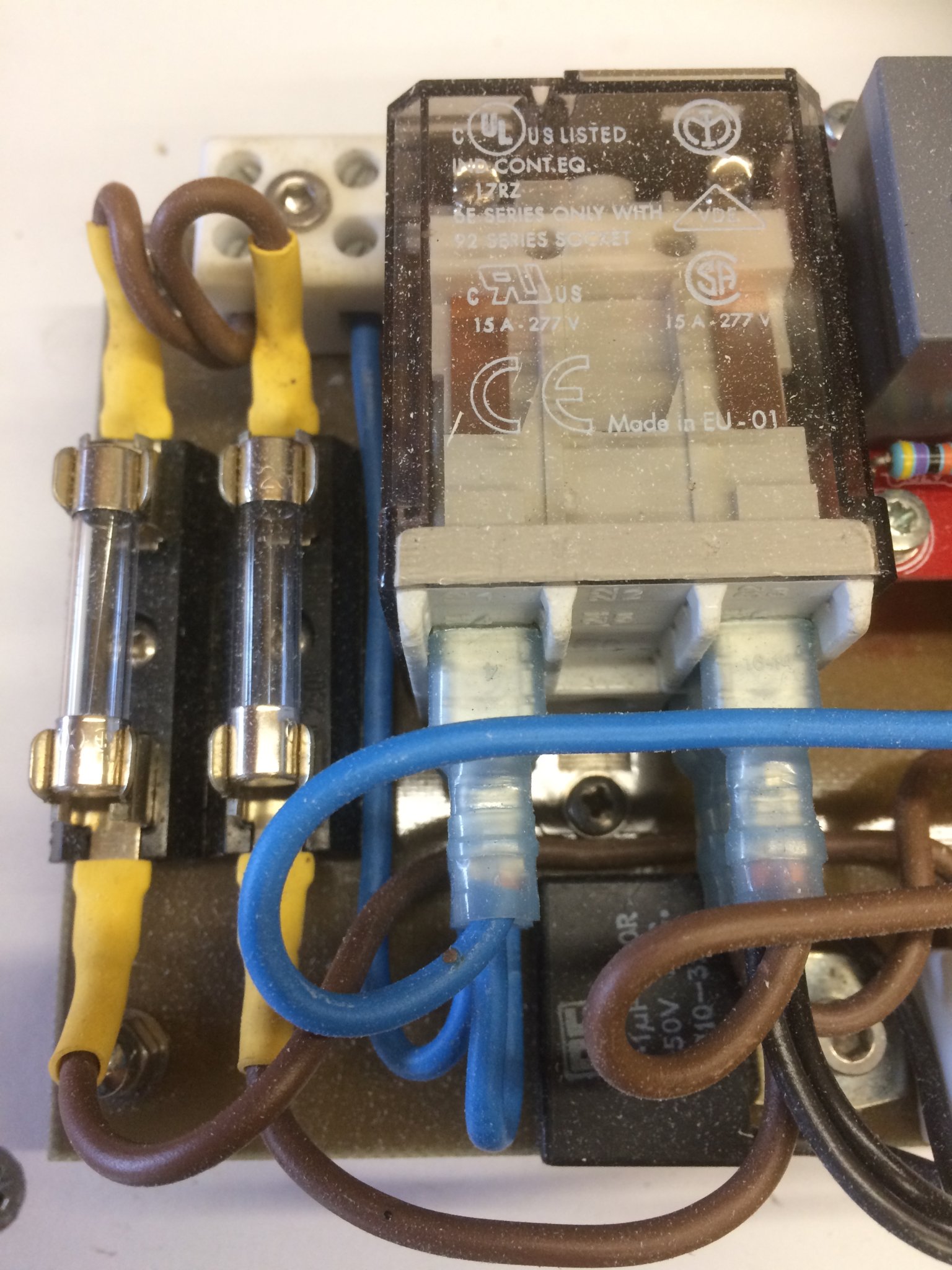

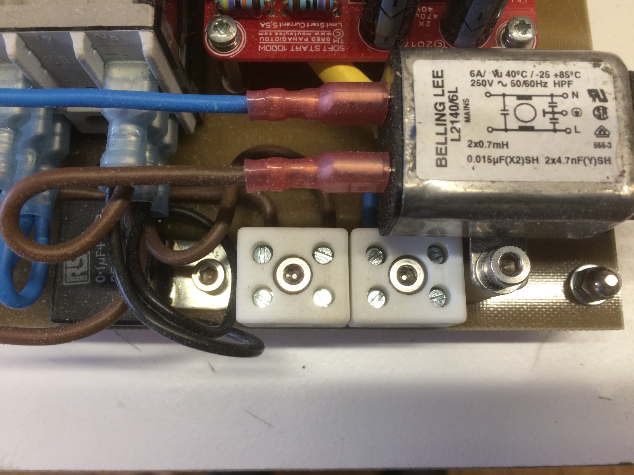

Have just made a little soft start module for the 500va transformer that I am using for this project
It has mains in (top right corner terminal)
then terminal for the main on/off switch and out put to fans and protection modules and from the red circuit board goes to the primary transformer winding
hope this makes sense

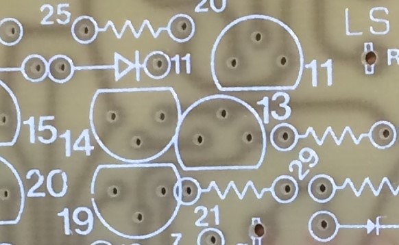

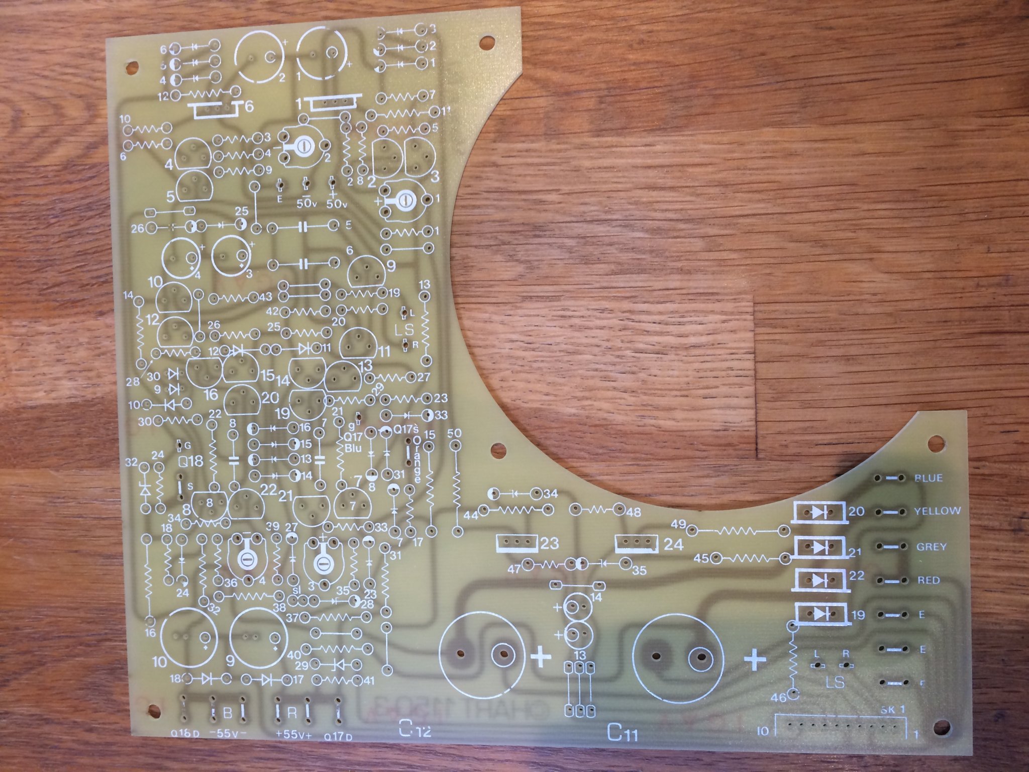

Also Please note :
the power supply PCB has a very small over site that is easily rectified (yes I have not the time to re visit the Gerber file)
this PCB 1150-3 has been modified to take the latest power supply capacitors and a small copper wire / track was left off . This is very simply added at the assembly stage by taking the cathode wire from D11to the base (centre) connection of Q14
