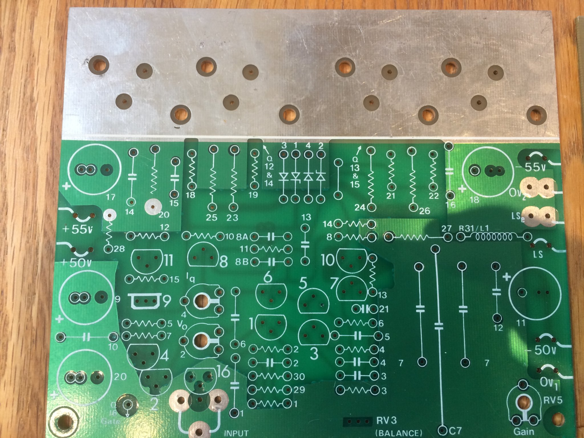

I have 2 in the original Amp I built over 20 yrs ago that are still working. Then I had manually made my own PC boards using Alfac transfer (lines and doughnuts on separate sheets) and a PC pen to run over that in case of small cracks. I had used the PCB in the original 1984 ETI article, including the rectangular PCB of the regulated power supply. I modified the power supply by making a few changes and using MOSFETS instead. Surprisingly it worked. Recently I decided to make a rebuild using the HART boards. I took the photos posted, used a photographic program, squared distortion, greyed scaled the photo, increased the contrast and retouched using a graphic tool. This came out well. I scaled the PC boards using the TO3 transistor for sizing, made some adjustments for my capacitor sizes, laser printed them out onto glossy magazine paper in negative image and then ironed the image onto cleaned copper boards, soaked the paper off, then etched and drilled them. A long process but it worked pretty well.

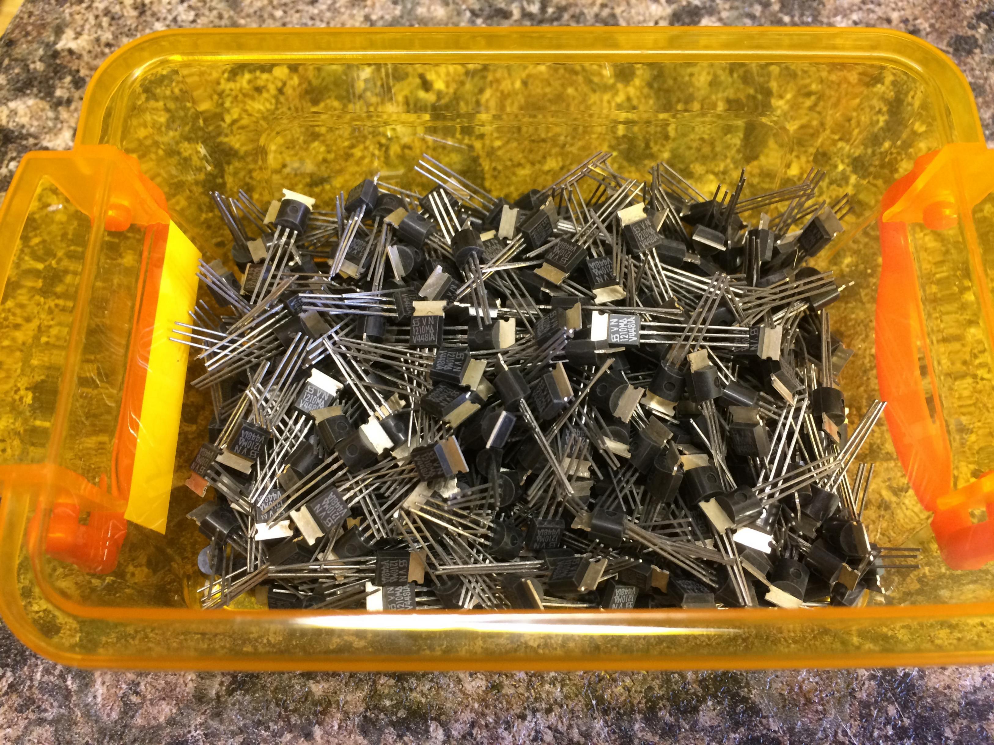

Hello I have the PCB'S will post a pic later
plus have the hard to get transistors
BF870
VN1210m
2N5459
the remaining components are still available - plus I have the output Mosfet transistors as well

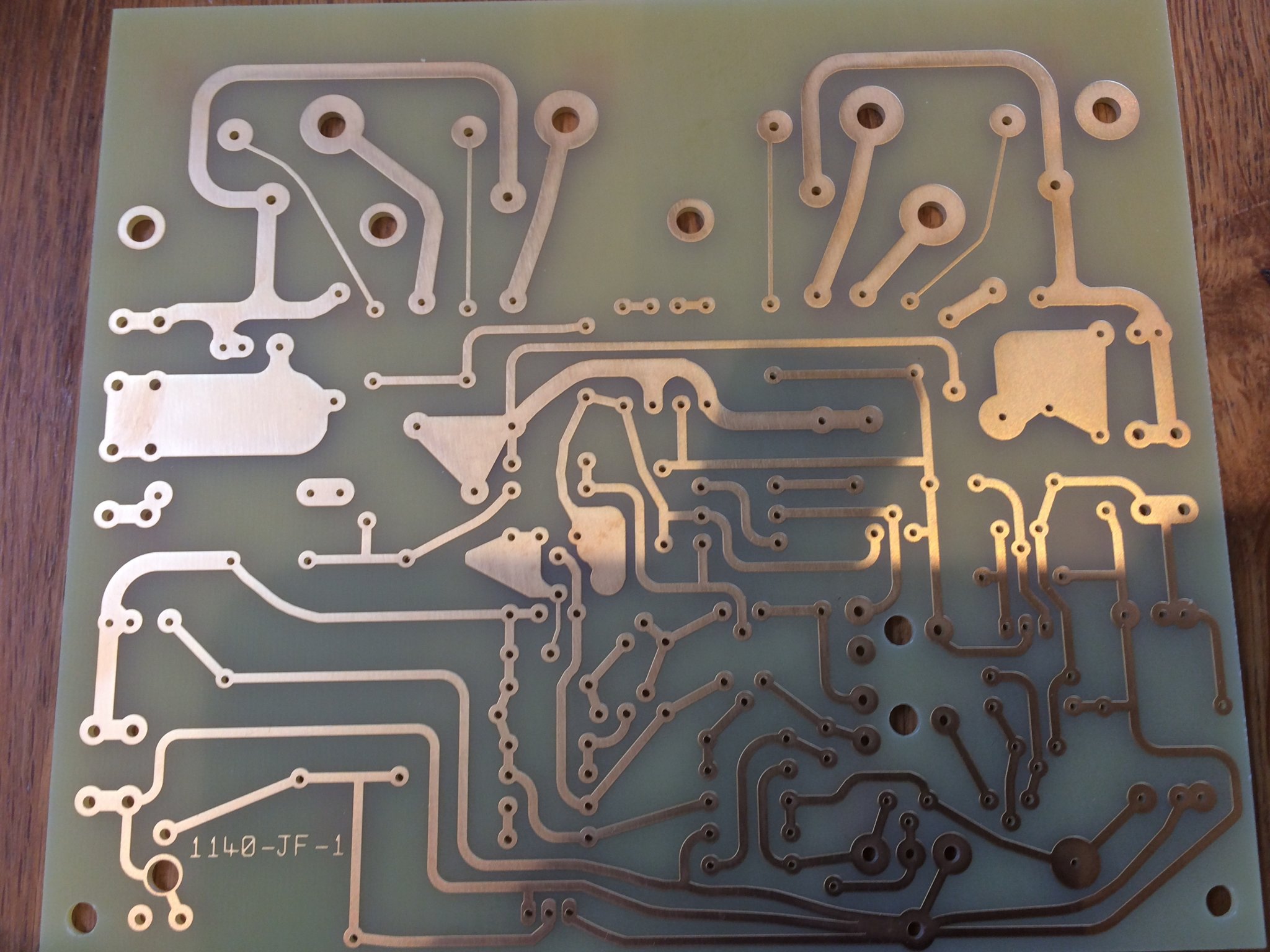

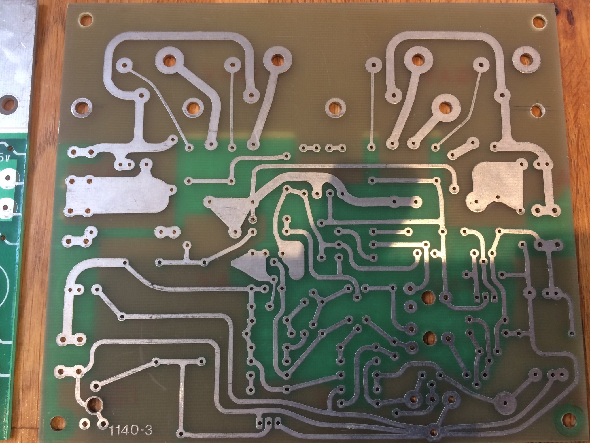

these are the versions that I make.
I have now produced my own power amp PCB (the power supply to follow) mine is 20z copper gold, but I don't bother with silk screening but do have the original layout pics to follow
please see below ( 2 pics of the original board)

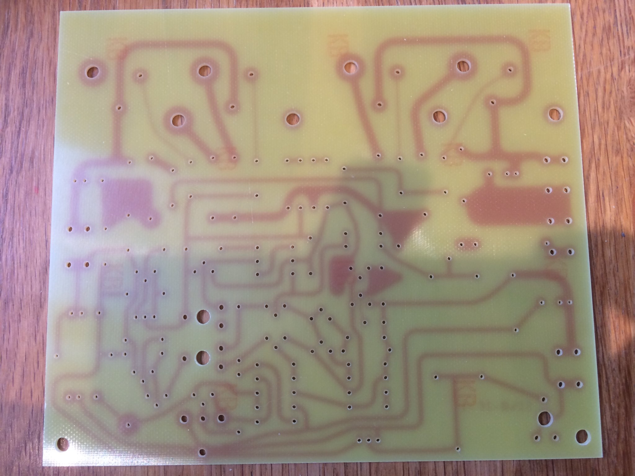

I have my own Gerbers for the new version (true to the same layout)
I use bare gold 2.0z copper boards with no silk screening as like the retro look if I can call it that ? I have tried tag board point to point but had to many instability issues and even though I tried my best always looked like a rats nest.
so 2 pics of the my own power amp PCB
