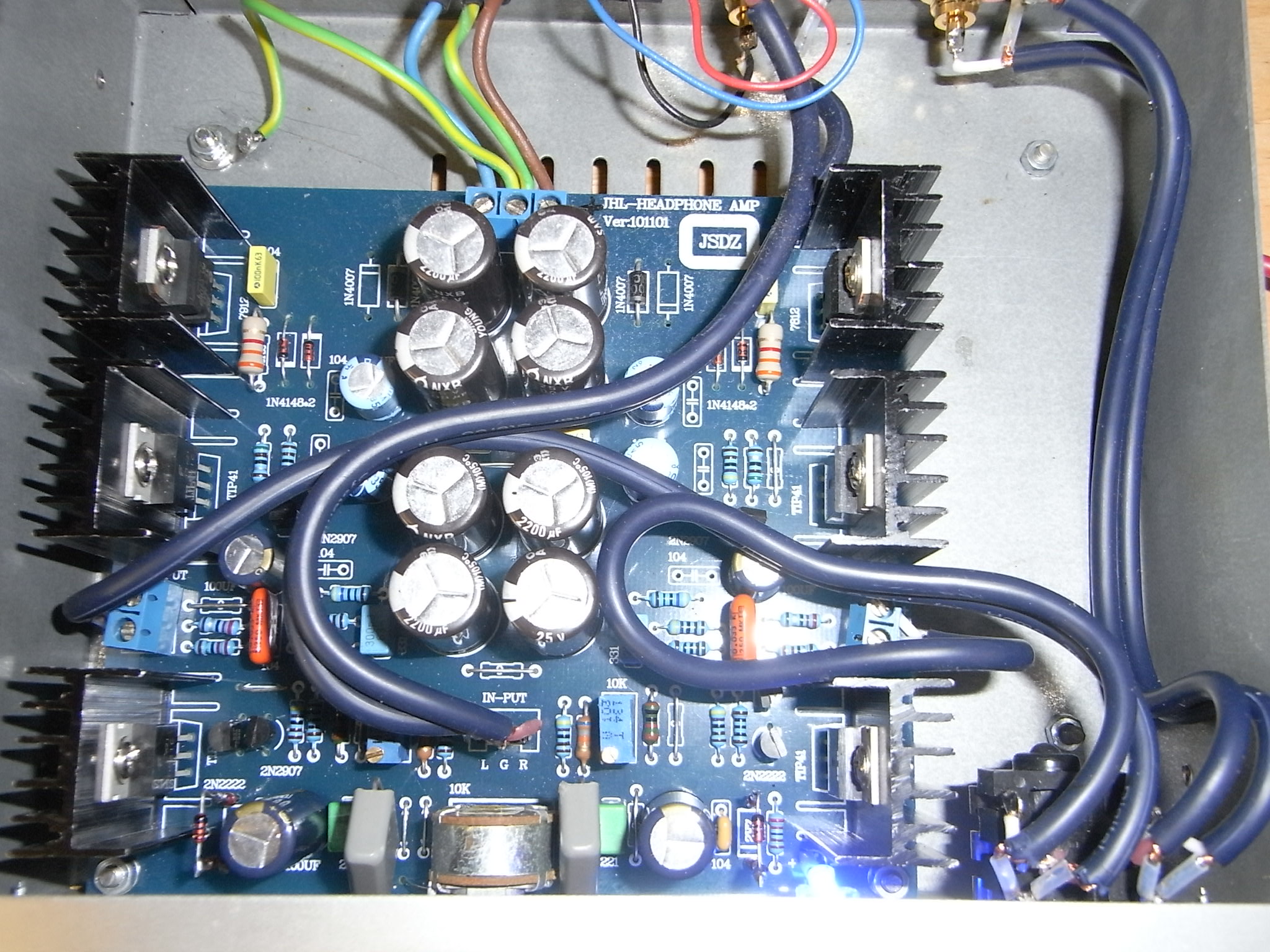

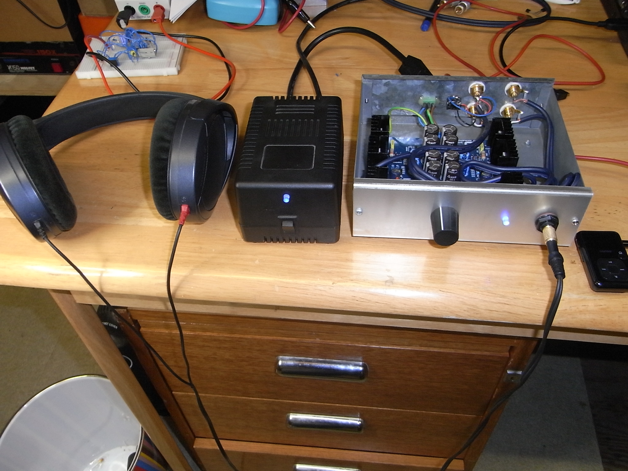

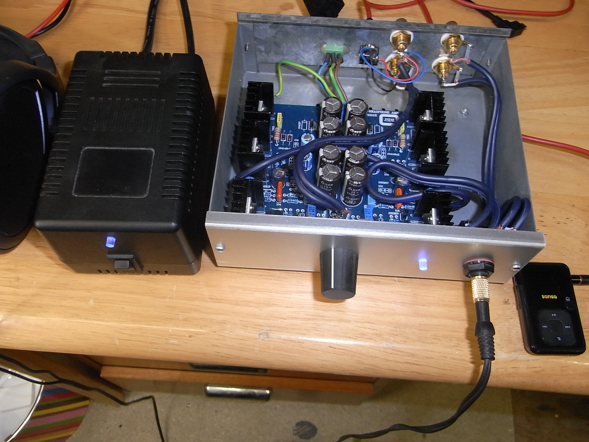

Hi Mayday,
Im listening to my JLH Class A amp as we speak, using a Sansa Clip+ and Seinnheiser HD565 Ovation headphones, sounds great with the mods discussed earlier in this thread. Maybe you are making this too complicated with output caps etc. Usually less is better in audio 🙂. You should be able to adjust the output offset to less than 5mV and lose the huge caps. If nothing else, try to find out why there is a large offset, that is more likely a fault elsewhere. I will help too if you need it.
Thanks for ordering your help 🙂
The only things I've done apart from swapping output resistors to 68R, is using film caps everywhere for everything under 1uF.
Changed the included 100uF caps for 180uF Elna RJH's (except the ones orienten incorrectly on the silkscreen where I used 470uF Rubycon ZL's).
U also use a 10K Dact type attentuator instead of the included vol pot.
Oh, swapped the 3V3 Zener's included to 2V7 Zener's as shown on the silkscreen.
The DC offset is identical between the channels with the trimpots turned fully CCW.
Should anything be very wrong I assume I'd get different offset between the channels? Or some other clue that something was off?
After swapping the 220K resistors connecting to the middle of the trimpots to 2x 100K in series to use the midpoint of these resistors as connection from DC-servo output when I incorporate in to the circuit.
After this operation I now get around 170mVdc offset.
That is when the circuit is hot.
Heatsinks can be touched and I can keep my finger on them without getting burned.
Maybe I should swap the series resistors to 2x 110K as the single 220K seemed to give lower and faster dropping DC offset.
From trimming offset before swapping the 220K resistors, I noticed turning the trimpots CCW lowered positive offset, and CW lowered negative offset.
Now getting 165mVdc on both channels after having the headamp powered on for around 30-45min, I haven't tried turning the trimpots from their fully CCW position.

No, the 220K resistor only provides isolation between the 10K DC output adjustment pot and the diode bias network. Its value is not critical but lower values allow more neg 12V DC rail noise to be injected into the input Q5/6 transistor, as well as forming a low pass filter with C13/14. Lower values will also give a "stiffer" bias point setting. JHL amp builders have used values between 47K - 220K with no problems. The LED not lit means you don't have a -12V supply, unless LED wrong polarity. Try reducing the value until you can adjust output DC offset around 0mV (i.e. + and - readings)
I am tweaking my amp now, as it happens, to try to improve the bass response for my HD565 headphones. I increased R19/20 to 100K (from 68K), C13/14 to 1uF (from 0.68uF) and C23/24 to 560uF (from 220uF). The new values are fairly typical values chosen by many JLH amp builders so there is nothing very critical in the design of the input stage/dc offset adjustment. It sounds very good, bass is definitely a bit better but through headphones its never going to be ground-shaking 😀. Photos attached.

C23/24 need to be installed with opposite polarity shown on silkscreen. Inputs and outputs should be unloaded. The value of R19/20 is not critical but I would stick to 100K or 110K or less, just to get it working properly.
The diode or original zener implementation only produce a fixed negative VREF voltage (about 2.5 - 3V) for the dc offset trimmer pot. Diodes are better because they allow some degree of temperature tracking of the output dc offset within the amplifier case. AFAIK nobody has calculated it empirically but 4 x 1N4148 diodes seem to work fine. Each diode has a tempco of around -2mV/C and this seems to compensate for the combined thermal drift of the transistors. But don't quote me on it😉 The only down-side is the thermal stabilisation takes a few minutes while the output transistors warm up but I don't think that is a big deal.
If you cannot adjust the output dc offset to approx. 0mV (+5 to -5 mV), something is wrong and there is no point going any further. Adjusting the dc trimmer causes Q5/6 to conduct more or less, adjusting the DC balance point between Q3/9 and Q4/10 i.e. the output. Easy things to check, 0.5 - 0.6V drops across R1/2 and R25/26. Check NPN and PNP are in correct place, even with pre-assembled boards. When you get a nice stable 0mV on your output, you wont need big output caps or DC-servo circuits to pollute the sound🙂

Forgetting the cap changes for now, the general consensus was:
R9/10 change from 2K2 to 3K3
R21/22 change from 1K to 10K (important because its in dc offset circuit)
R19/20 change to less than 220K, around 100K
Replace the 2V7 zener with 3 or 4 1N4148 diodes in series

I made the suggested changes, though stuck with 2*47K resistors R19/20, and I found the DC offset much easier to trim down.
Half a turn on the trimpots made alot more difference than before.
After about 30-40min I started trimming DC offset, I was in a bit of a hurry, but got the DC offset to around +/-4mVdc for both channels.
It seems the DC offset started dropping faster as well and didn't drift as much.
I swapped 2K2 to 3K3, 1K to 10K, 2V7 to 4x1N4148 and 2*100K (220K spöt) to 2x47K.
The heatsinks didn't get as hot as before these changes I think.
