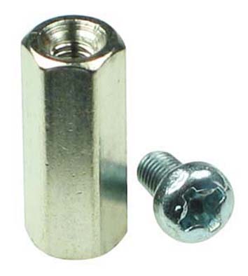

Normally this is done with stand offs at each mounting hole.
Although different sizes exist you could simply use the standard M3 chromed brass types with a length of 10 or 12 mm. I find the ones that can have screws at each side most practical. PCB mounting holes are M3 in 99% of the cases so it seems some standard exists in this world 😉
With higher voltages and devices that generate heat (those often have perforated PCB's for air flow) I tend to use longer ones. I avoid the plastic types as they might be cheap but they're not sturdy.
If you build stuff more often you better keep some stock as they're cheaper too when bought in numbers. Or share with a fellow DIYer. Don't forget to buy M3 (preferably Torx as they're the standard by now) screws and M3 nuts and washers with the stand offs so you can encounter any mounting issue with ease. An investment of a few Euro and you can go on for years without any delay.

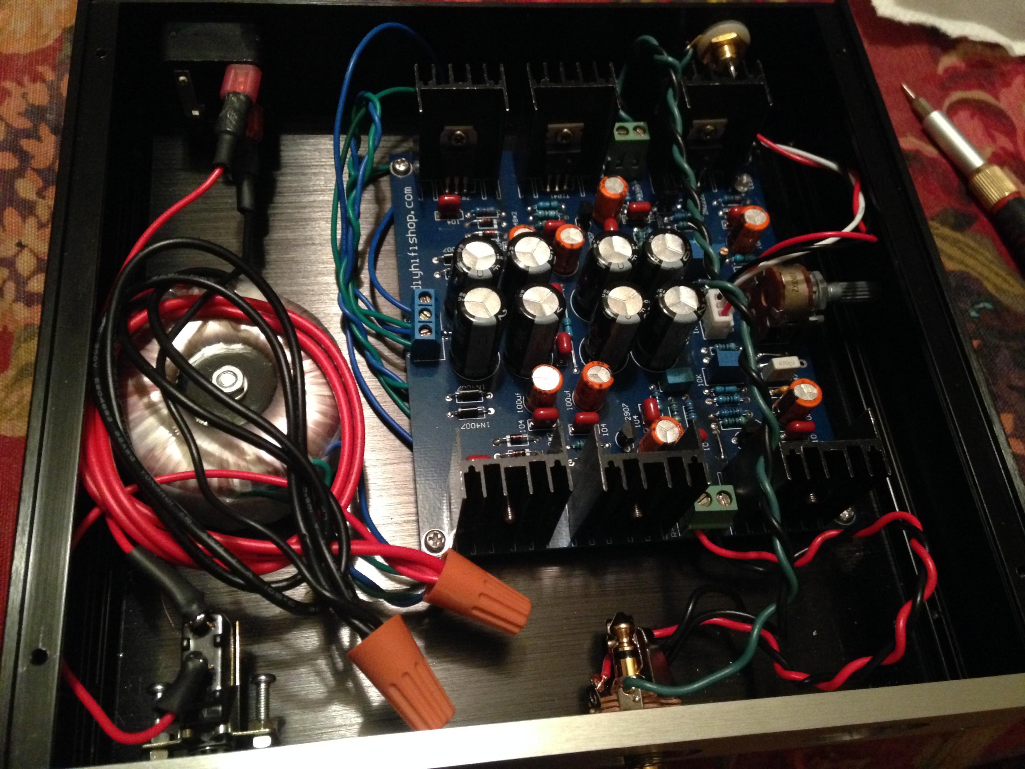

Kaplaars thanks for the info and very nice pics. As you say there is just enough space(possibly) to be able to close the lid which the case and the JLH amp. Here is a pic of my setup which unfortunately isnt as tidy as yours. Which amp did you get for your case ?

You're welcome 🙂. Nice work! I like the toroidal transformer, it fits very nicely. If I may give you a tip: I would try to shorten the mains / transformer leads a bit and twist all AC wires. Therewith you will minimise hum.
I really like the JHL, however I had some serious problems with fluctuating offset. To tackle this I added a DC servo circuit. It also gets quite hot. I got the advice to add some ventilation holes on top. This helped in tackle the heat quite nicely. There are quite some mods mentioned in this thread. Some are less important than others but it sure is fun to tweak the circuit a bit 🙂.
