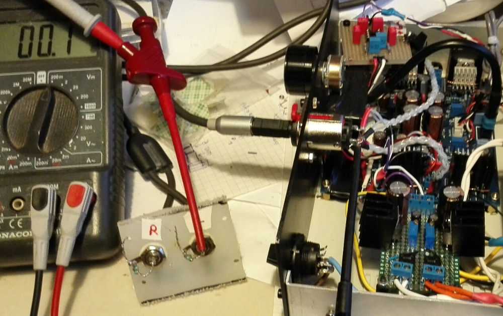

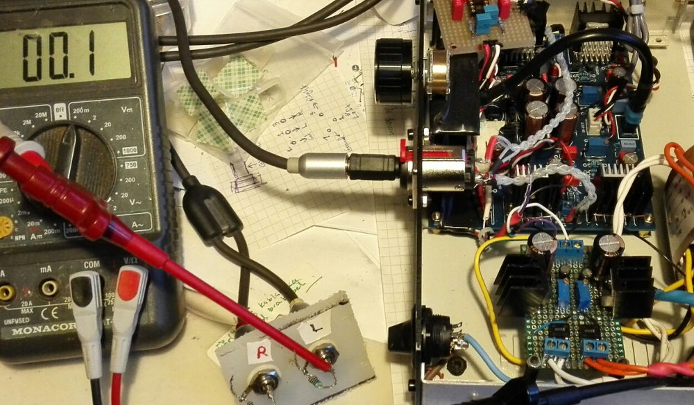

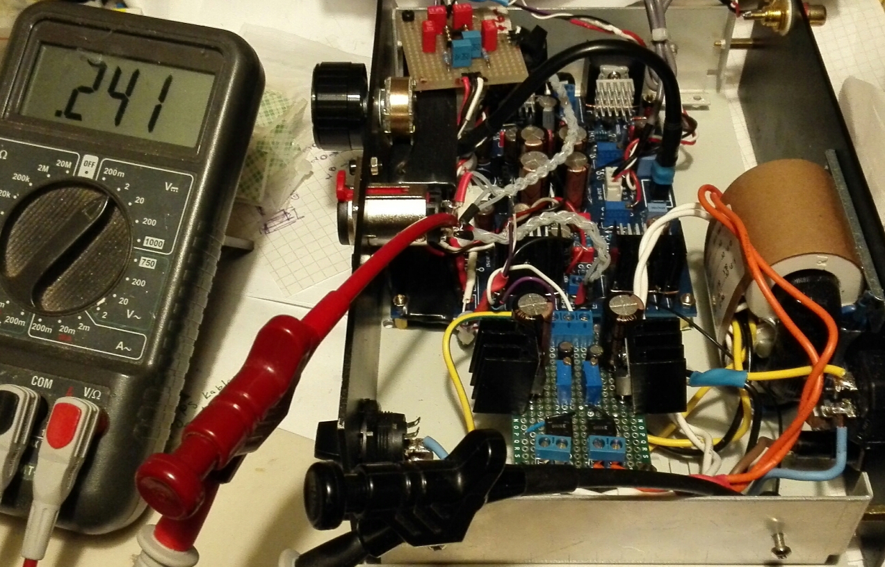

Had the headamp on for well over an hour earlier.
Got about 241mV DC offset on both channels without any load and empty inputs.

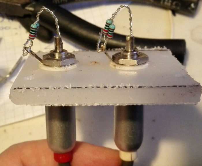

Found some post I had printed out a while back where the poster used a 100R 1W wirewound resistor as load.
I didn't have that, but I put two 220R 0.6W resistors in parallell.
I made two of these and soldered them on a "test-jig", two RCA jacks each with 110R 1.2W to ground.
Now I got 0.1mV (iirc, writing from my phone), both channels still the same. Unless I've somehow misread the DMM...
Now, without having plugged in the DC-servo that's just too good to be true.
That's why I'm very sceptical and ask here if I've made some mistake?
The DC-servo is plugged in as far as wiring to and from it. No power to it and no opamp in the socket.
Any advice?

Yeah, I think I'll have to get the PCB out tomorrow and go over it anyway.
Getting 0.05-0.09V across 5R1. I do get 12V between the side towards rail and GND.
LED still not lit. Heatsinks not getting warm.
(Related to only 0.05-0.09V across 5R1?).
Didn't get more than <1mV DC on outputs with load disconnected just now.
I need to go over the PCB carefully. This headamp has been built when ever I had time over a couple of months when I got stuck on my modular DAC build.
In other words, I didn't really take this that serious as the other build on perf board is that much harder.
And... I do have a tendency to fudge up on the easy stuff for some reason.
