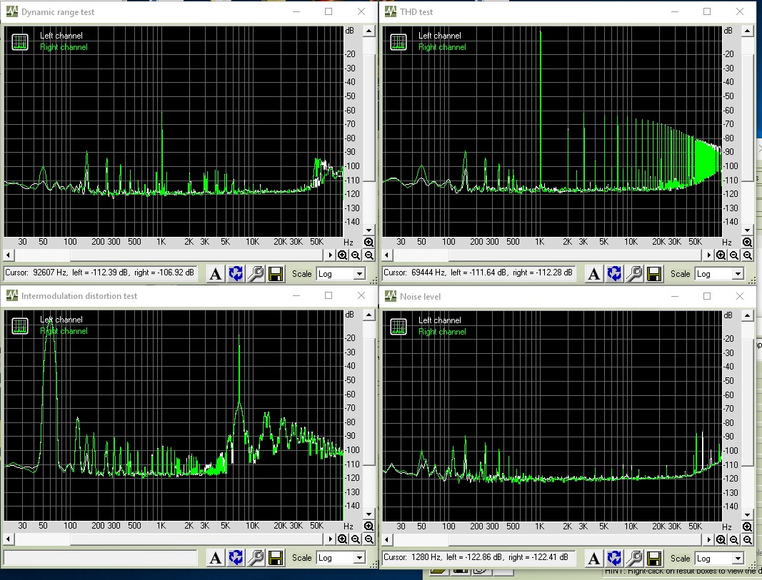

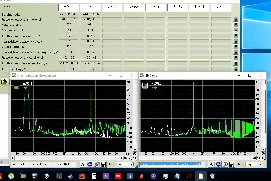

does anyone knows what is couse of distortion on picture, its headphone amp from Rod Eliott site which is similar to JLH.
looks like the signal is @ -5dB and the 2nd is at -75dB leaving the distortion @ -70dB relative to signal.
But you have a lot of mains hum and harmonics.
Sort the grounding and sort the signal wire pairs first.
Then redo the distortion measurement.
thank you on answer, i have sold my good usb recording soundcard and this is measuring with motherboard intergrated card and cheap 3.5mm cable so i dont know how to get noise down but thats why i measured my ne5532 output in same condition , so there is that harmonics over 1k that is problem,i hear them as cheap cartridge sound. i am using unknown power diodes in bias and general purpose transistors but 1k is not that high so its puzzling me.

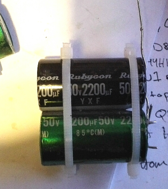

I put two Rubycon ZLH 470uF/25V in series( + - - + ) on each output.

The large-ish first to lytics are 2200uF Elna RJH's

If that claimed 5Hz were actually achievable, you can use that to arrive at the required capacitance.
F-3dB = 1 / (2 Pi R C)
Therefore C = 1 / (2 * Pi * R(impedance) * F-3dB)
C >= 1 / 2 *3.14*30ohms*5Hz >= 0.00106uF
For two polar capacitors in series, that comes to 2.12milli Farads, therefore use two 2200uF
That should give pretty good bass response down to 20Hz, since the F-3dB of the capacitor filter is two octaves below what you can hear.
You could instead use 4 off 1mF caps, +--+ in parallel to -++-
The that still gives the bipolar effct since it uses back to back and doubles the series capacitance since two sets are in parallel.
4 off 1mF used in series parallel comes to an effective 1mF.
1mF 16V, or 25V, are very cheap. I have bags of 50, or 100 of each.

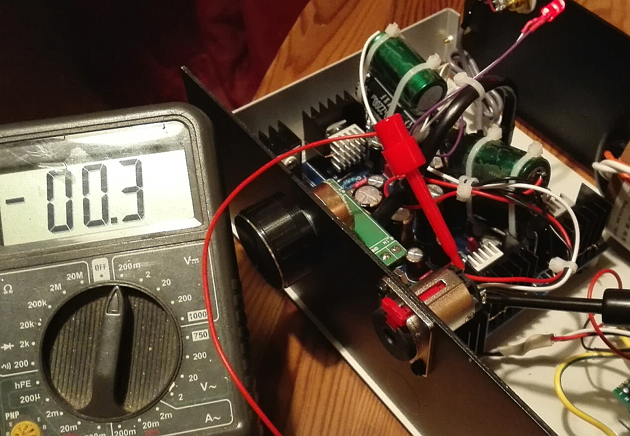

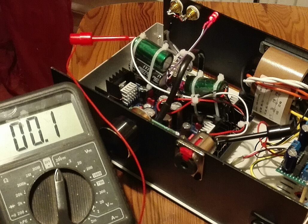

Got this headamp powered up today.
With the 2* 2200uF caps in series on the outputs, I got the offset down to < 1mV.
The heatsinks get hot, not too hot for touching, but very hot.
I'll leave the headamp running for a couple of hours tomorrow and make sure it is stable.

How quickly does the offset voltage drop for those of you that has used capacitors on the output?
It takes a while for mine, even with 110R resistors as dummy loads.
Without the dummy loads, it takes in the area of 10min - 15min or so for the DC offset to drop to somewhat acceptable levels.
As output capacitors I used 2x 2200uF in series for 1100uF.
The output capacitor would reach it's charged state around the time the Sun blows up.
But, it gets to within a couple of percentage points in 10 times it's RC.
A 1100uF (two 2200uF in series) feeding into a disconnected headphone with a 110r grounding resistor will charge to ~63% in one RC.
RC = 110ohms*0.0022uF = 0.24seconds. 10*RC = 2.4seconds.
If your starting voltage offset is 1Vdc and stays at 1Vdc, then after 2.4seconds the offset after the DC blocking capacitor will be <0.01Vdc.
Since your offset is lower than 1V, you should find that your offset without the headphone connected should be <<10mVdc in ~2.4seconds.
If you switch on, or switch off, with the headphones connected, then the lower resistance will shorten your charging/discharging RC.
I think you have measured it incorrectly, or wired it incorrectly.

I wired and measured the output like this.
The sch you have shown is correct.
The two series connected capacitors have an effective capacitance of 1100uF
The C combined with the R creates an RC time constant of 0.24seconds.
Your red and black probes are touching the correct measuring points.
Your very long delay measurements do not make sense.
Some else is not right.
Is the sch really the way you have wired it up?
Yes that is the way it is wired up, but the resistors are soldered to two RCA jacks at the end of a Y-cable (between pin and gnd).
This way I can use the load for more than one headamp project.
I've temporarily soldered a 4700uf in series with a 1K resistor between each rail and GND to check that the 7812/7912 are putting out correct voltages.
I'll probably get around to measuring voltage across the those resistors today. to see if there's an uneven supply or something causing the drifting offset. (Thanks Mooly for the suggestion, and all advice).
Hi Mayday,
Im listening to my JLH Class A amp as we speak, using a Sansa Clip+ and Seinnheiser HD565 Ovation headphones, sounds great with the mods discussed earlier in this thread. Maybe you are making this too complicated with output caps etc. Usually less is better in audio 🙂. You should be able to adjust the output offset to less than 5mV and lose the huge caps. If nothing else, try to find out why there is a large offset, that is more likely a fault elsewhere. I will help too if you need it.
