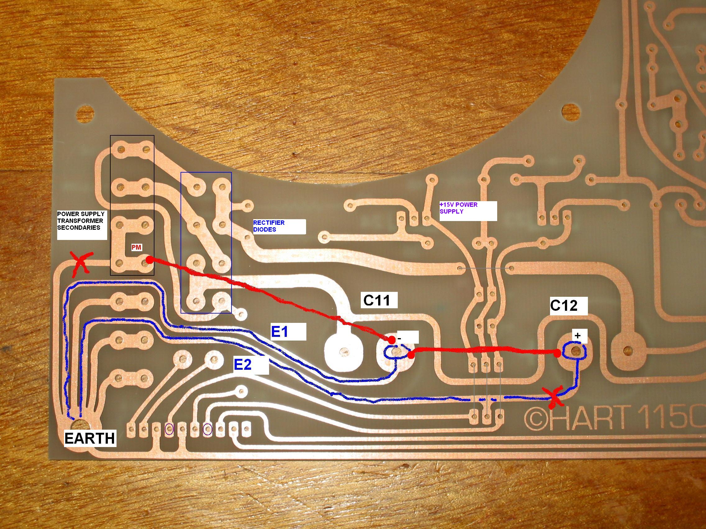

Hi Dado,
I made the mod that you suggested for the mid point connection to earth. This didn’t solved my ground loop problem BUT improved the sound a lot : much more opened, transparent and razor-sharp image.
Thanks Dado!
I modified the Power Supply like this:

I am glade you did some improvement. I am not familiar with Hart PCB, maybe there some more ground loop problems, don't give up.
dado

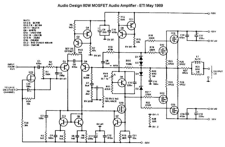

If you put R8 to 2K you will get the same gain as if the balance pot was in the middle, that is valid for original JLH amp. I don't see how Hart changes coud functon??? Just removing R9 and changing a valus without changing circuit connection is no good. Be careful with changing Hart amp, must be different then JLH original schematic.

Half the balance control is in parallel with 2k2 in the lower leg of the feedback.
If the balance control is to be removed then 50%*1kvr // 2k2 must be replaced with 407r for R9.
R9 & R8 can be summed and replaced with a fixed single resistor of 1227r for exactly the same gain. 1200r is close enough.

Using 2k7 or 3k for R8+R9' reduces closed loop gain to ~30 times. But this has two consequences:
1.) the bass response is extended slightly. 30ms cf. 11.5ms previously.
2.) the feedback is increased by a factor of [150k/1220] / [100k/3k] ~ 4times (+12dB). This will require some adjustments to the HF compensation to maintain JLH's standards of stability.

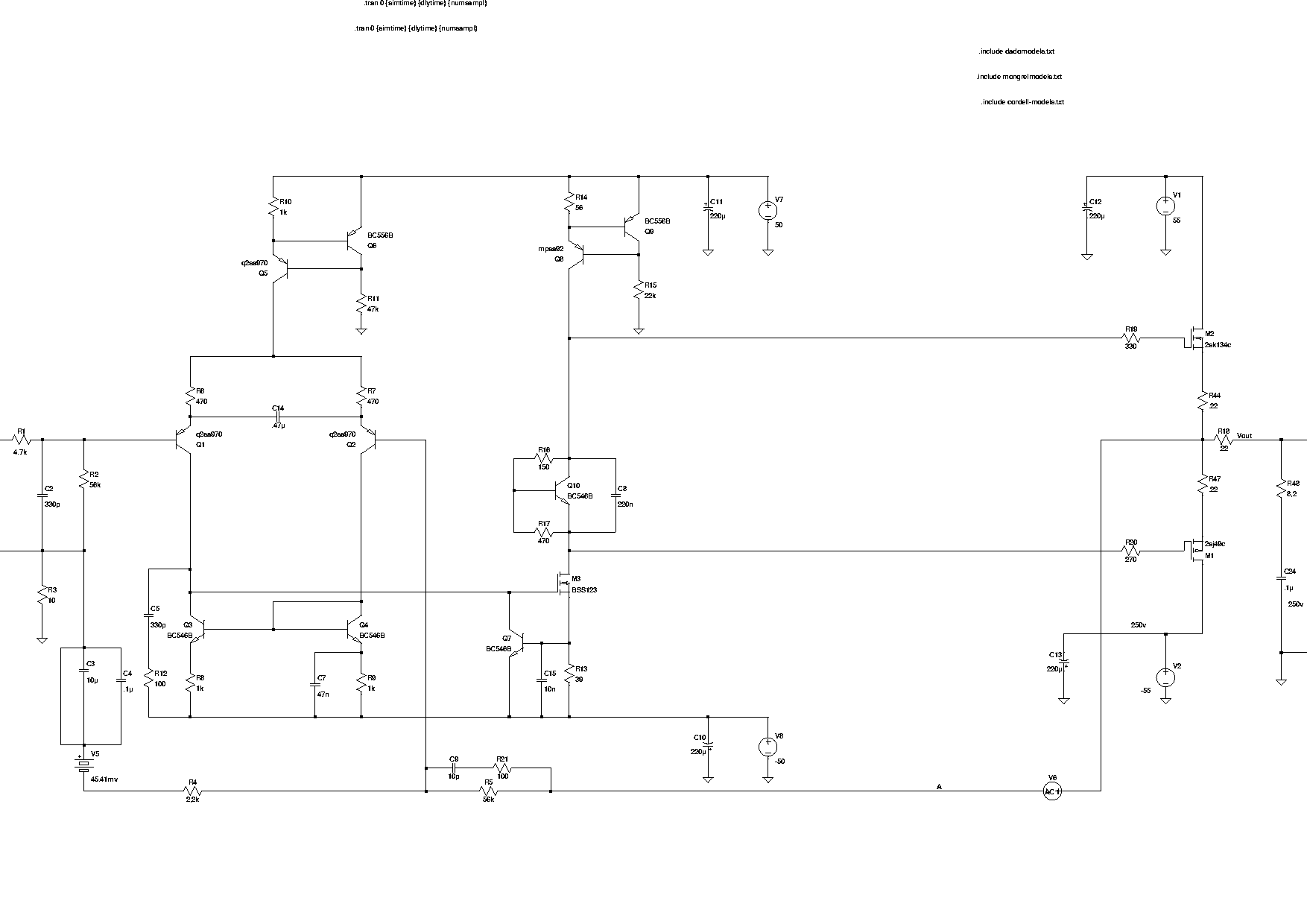

This is my version I am using. Look at #47 too. Protection diodes are missing on the schematic, it was not relevant for the simulation.
dado

So I’ll try first this config :
R1=100K, R14=100K, R8=1200R, R9=removed, RV3 preset=removed, balance pot=removed.
Note : R9 doesn’t exist on my Hart PCB.
Question : is this config OK ?

Nikola,
I think it should be OK. Instead of 42dB as for original Hart you will get 38dB of the gain.
