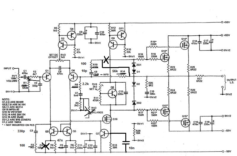

Hi all,
Finally I realized the Dado’s mod described in post #47.
It is very rare to find practical mod articles on this JLH 80W, although I consider this amplifier very good despite its age. This thread produced interesting suggestions and Dado’s mod was apparently a good opportunity to push JLH 80W beyond the limits. The distorsion improvement figures found by him were impressive enough to try the move, but apparently nobody else made the change or wrote about it.
My source is standard Teac VRDS-25 with unmodified Benchmark DAC-1 and my loudpeakers are recabled monitors Spendor 2/3E : the system is very transparent and revealing.
In my setup : R1 & R14 are 100K, and R8 is 2K2.
C3 is 330p now,
R3 is 100R,
C4 is deleted,
C5 is 47n,
R10 is 100R,
C8 (5p) is not changed for my setup (10p in Dado’s mod).
I’ve cut one track twice at R10 pad to keep it alone and I’ve added two (isolated) links on my Hart PCB (1989 schema) :
Remember that schema and PCB are two different things ! I learned that the hard way... So check carefully before!
It is not easy to describe differences because the sound changes a lot from one recording to the other, or with different sources.
The sound is cleaner, more readable, less spectacular because some resonances disappeared through the spectrum and distortion reduced, but more refined, quieter, more natural, more pleasant and easier to listen to. Treble is very clear now. The listening style changed and improved with a significant margin : it was necessary to accustom a bit because of the reduced distortion.
The improvement is obvious. Just allow several hours after the mod to open the image up.
I find the Dado’s mod icing on the cake in my setup. It is well worth the effort and I’ll keep it definitively !
Thumbs up, Dado !

- Track cut from R10 to D1,R18,R19,C13...
- Track cut from R10 to Q8,Q9 -> this R10's pad is alone now.
- Two isolated links added: one from same R10 pad to track going to Q8,Q9 ; the other from same R10 pad to R25,R23,D3...

Moving R10 from VAS to output changes the amplifier.
It is no longer a JLH.
It becomes very conventional. Everyone except the Brits do it the simple way.
Maybe the "Brit" sound does not suit you.
Hi Andrew,
Technically I don’t know.
About the sound : my words about change in style were probably not well chosen. Now the sound is in the straight line as before, but I should to accustomate to much less distorsion that it appears as a new « style » but it is not. This was obvious when I compared instantly modified channel with the unmodified one for several hours before going to full modification.
The scene is still colourful and colours are enhanced. If british sound is distorsion, then perhaps I don’t like british sound... To be sure that I understand you, could you explain what is british sound ?

Many British Power Amplifier designers do not use the Cdom (as used by D.SelF) method of stabilising the amp.
Instead they capacitor couple the VAS to the inverting input.
This generally requires a much more thorough and usually multi-location method of ensuring amp stability.
This style of topology was relatively uncommon outside the UK while it was being adopted inside a number of British, nice sounding, amplifiers during the 70s, 80s and 90s.
There are some non British amp designers who champion this style of compensation, either exclusively, or in conjunction with low values of Cdom.

Original JLH value for R10 is 470kohm and this is not just capacitor coupled from the VAS to the inverting input. If this could be reason for so called "British sound" I don't know and by the way what is the British sound, some specific kind of distortion.
The main reason I started with modification of JLH amp was that I have a hum coming from loudspeaker. I have found that the wrong earthing in JLH design was the case.
Then I started to look with an oscilloscope and found small oscilation with no load connected. In time when I have built the JLH amp I did not have an oscilloscope so I have just built it and It worked for years with described problems.
I simulated it and dasided to modify it according the simulation result, and I like the sound more now. Finally I still think this remains the JLH 80W amp as the main design goals are not changed.
