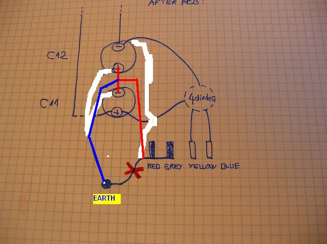

Connect midle of the transformer winding to the zero point of the large power supply capacitors and then from that point connect separate wire to the common chassis earth. Large current between winding and the capacitors should not go trough common earth point.
dado

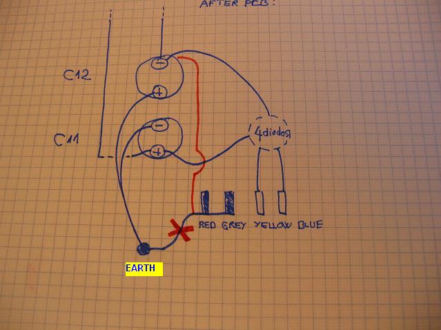

Do you mean this ? my schema is according to the Hart power supply pcb.
Not exactly, red wire to the +- of zero capacitors potencial and then with one wire to the earth. It looks that Hart connected earthing as JLH recomended and tha was wrong.
if yel & blu sec go to ~~, then red & gry must be centre tap.
Centre tap must go direct to the Zero Volts between the smoothing caps. This link is missing and instead you have shown long leads going to chassis.
Keep the transformer sec to rectifier to smoothing caps links short and twist all pairs together that have equal and opposing current flow.
Either Centre Tap or Zero Volts can be connected to Chassis.

Keep the red wiring as short as possible. And Keep Loop Areas very small. This requires the four secondary wires from the transformer to be twisted together and only separate two to connect to ~ & ~. Then the two centre tap wires and the +ve & -ve wires are twisted as a group of four to go to the smoothing caps. Then separate the +ve & -ve to feed the smoothing caps.
Take a tapping off the blue line and run that to your Main Audio (Star) Ground. This Zero Volts tapping can be very close to the red but not actually on the red.

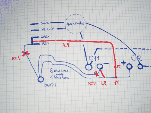

Then the project would be my new photo (the blue lines are now real PCB tracks) :
I’m trying to use existing tracks if possible.
L1 is straight on from center tap to P1 to keep as short as possible (not shown so).
Is it OK to put potential zero for smoothing capacitors at P1 instead of P0 ?

The two left blue lines on the left are designed on the PCB like this : two ‘long’ quite parallel lines going to common earth. Not as a single line. It would have been perhaps more logical for the PCB designer to link directly the + and – for potential zero of capacitors (separated only by a few centimeters) to have a single line going to ground. Could had been any reason for doing two paths to ground instead of one ?This link is missing and instead you have shown long leads going to chassis.
In the Hart design (and in my construction), common earth and chassis are mechanically together with a screw, and I cannot separate them. If I do as you suggest (connecting centre tap to chassis), I’ll find the initial faulty condition, doesn’t it ?Either Centre Tap or Zero Volts can be connected to Chassis.
Connect + and - (that is zero potentional for power supply) of the caps with short and masive wire and from there go to grey-red of the trafo. From the same point connect to the earth.
1. So is it better NOT to use the two existing blue lines going to earth, but a separate massive line to earth ?
2. Do you think that those existing PCB tracks are too small for earth connection ?

the point P0 is passing charging current around that figure of 8.
Be careful that you do not leave a common wire sharing charging currents with speaker/amplifier currents.
