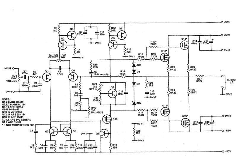

After meny years I decided to "improve" JLH 80W MOSFET amp from 1984.
Imade to amplifier with 3 channels in each one. It were used as amplifiers for active loudspeaker. Sound was nice, but I have had some problems with it. To sensitive, 37dB of gain, for my preamp with gain of 20dB.
When I decided to try improvement I simulated it wit LTSpice. As I had no models for original BJTs I used, for small signals BC546/556, and for small MOSFET BSS123.
Simulation of original JLH amp was not promising, probably I used different transistors in the simulation, but ot can't be to fare.
After that I changed following:
Gain lowered to 29dB by changing R14 from 150k to 56k.
R1 changed from 150k to 56k and moved parallel to C2
R10 removed and C8 in series with 100ohm and ten parallel to R14
C changed from 100pF to 330pF
C4 removed
C11 changed from 1nF to 47nF
parallel to R13 connected capacitor 10nF

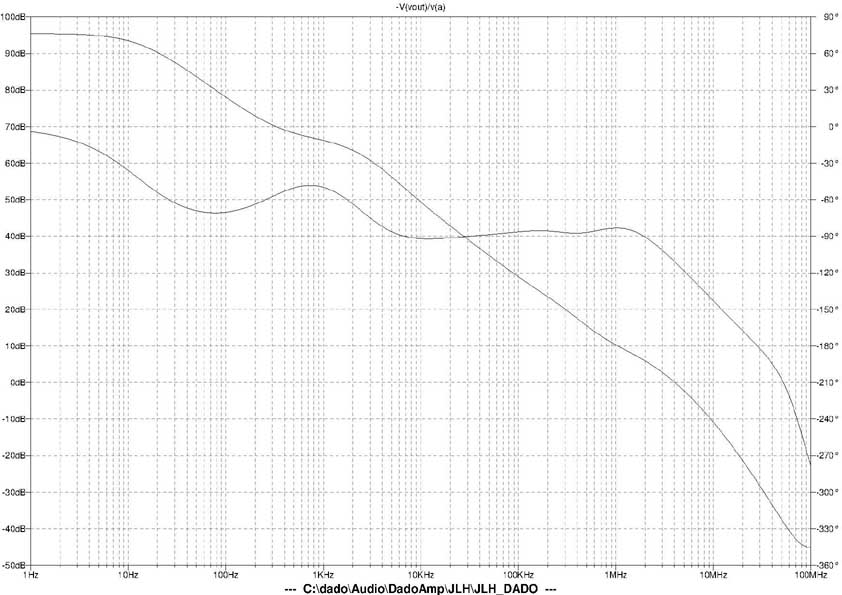

Simulated distortion
JLH 3kHz 0.028429% , 20kHz 0.114783%
JLH moded 3kHz 0.002066% , 20kHz 0.030721%
I tested wit square signal and capacitive loading parralel to 8ohm
with 10nF no ringing
with .1uF some very small ringing
with 1uf some ringing but it is acceptable
If someone interested I can make a photo of it.
Now with the new JLH there no hum and no noise if I listning close to loudspeaker.
Better paired with preamp, and wat abouth sound - I LIKE IT.
No transistor was changed.
dado

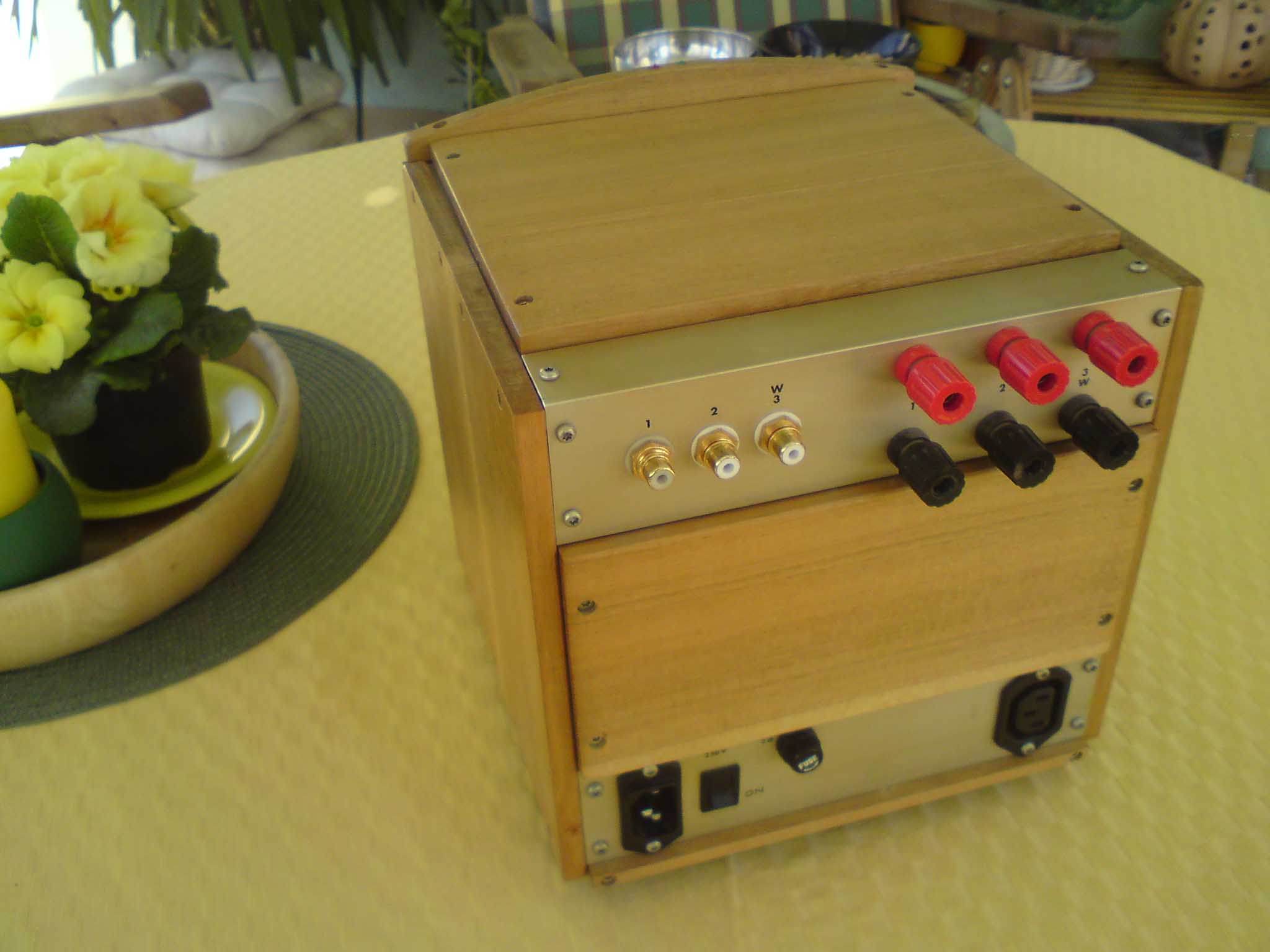

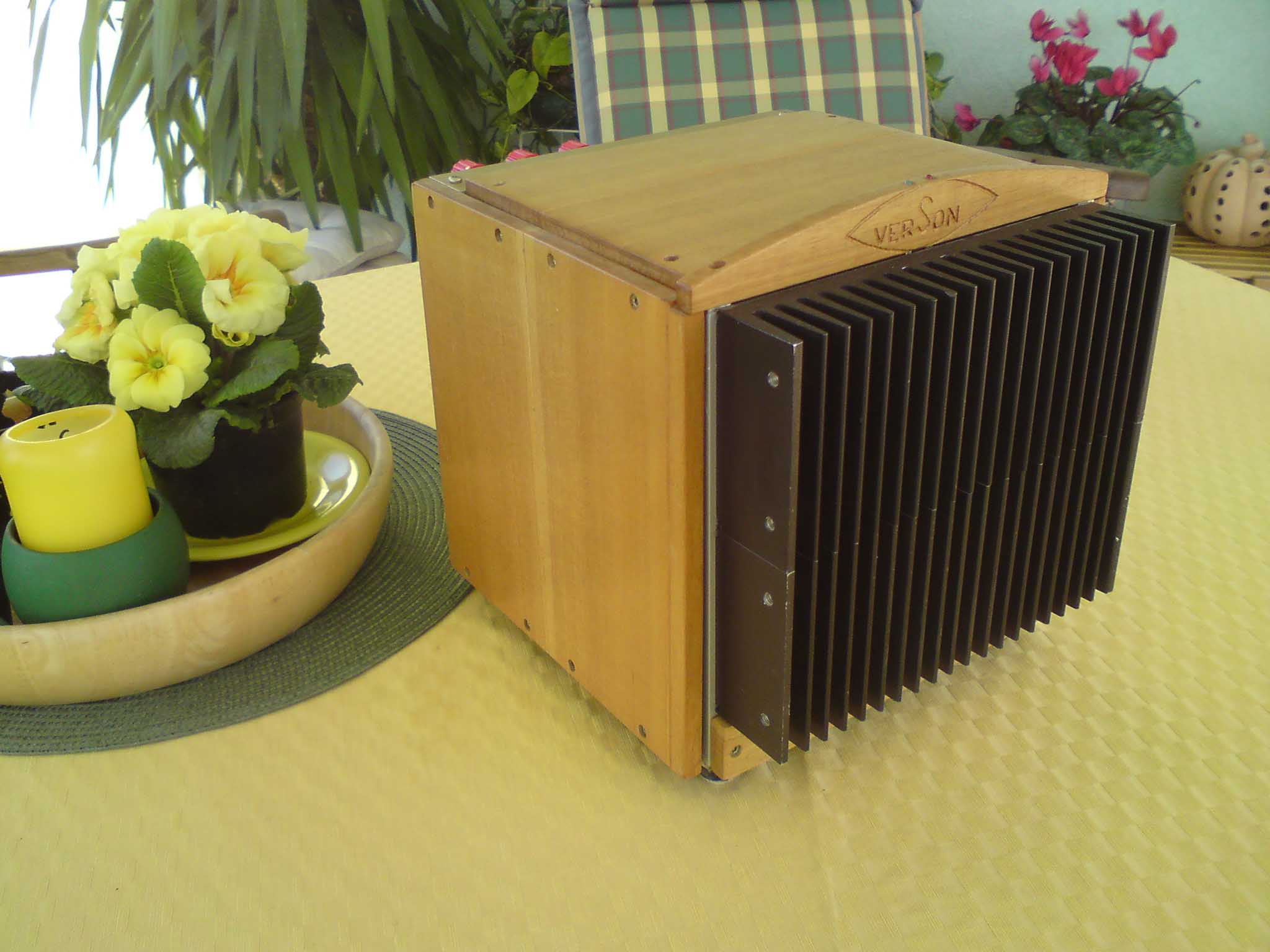

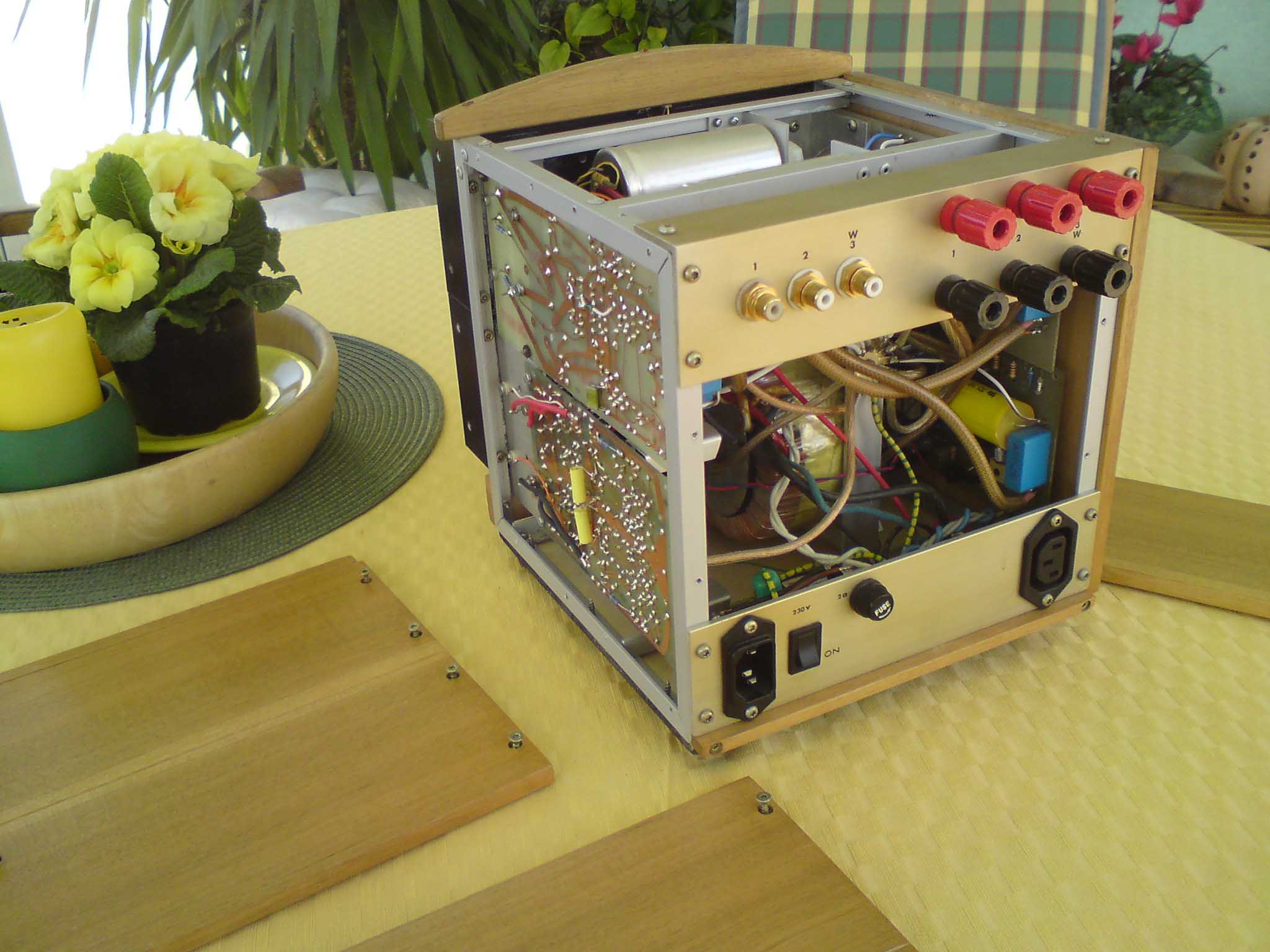

Listening modified JLH 80W
After almost one months of listening I am very satisfied with sound quality. It is very quite with no hum or noise. I am listening it for hours without listening fatigue.
Here is LTSpice file how I simulated it and a few photos of the finished amps. There are two boxes with three channel in each one. It was intended for ative loudspeakers but for the moment I use it as monoblocks to drive passive loudspeakers as on photo.
dado
dado

Thanks dadod ! Your project is very nice and the building is original.
I need some explanation to understand the effects of your mods, because, as I told in my first post, I’m still learning...
Please note that I’m using the schema from 1989, as used for Hart boards.
I’m looking for a more modern part of VN1210M to have improved characteristics. Have you found something interesting ?
vac231,
Schemtic I use is from 1984, but it is almost the same as from 1989, same values are different, but diagram and PCB is same. In my amp I use VN1210m but in simulation I used BS123 as I did not have model for VN1210. In earlier post you can find some suggestion for small MOSFET. I do not think that you will get mutch improved characteristics with different MOSFET. If you have VN1210 use it.
I have found more improvements in changing compensation, you can see it from my simulation. AS I do net have good enough test equipment for distortion test I did test with square signal and capacitive load and the amp was very stable, and the sound (during more then one months of sistening) is great.
dado
dado
