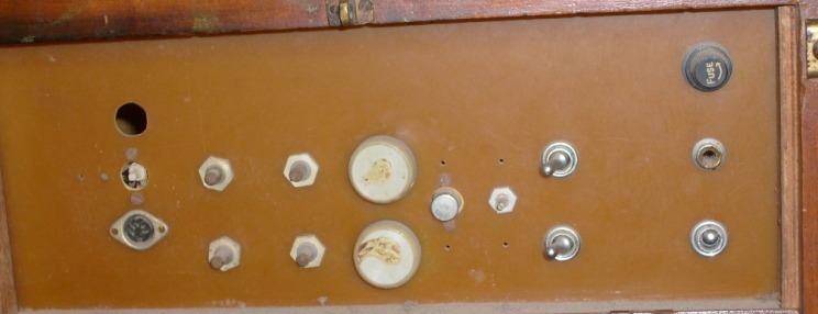

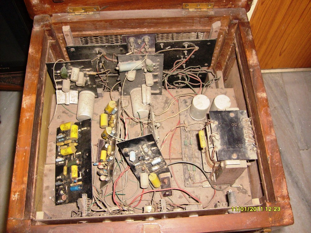

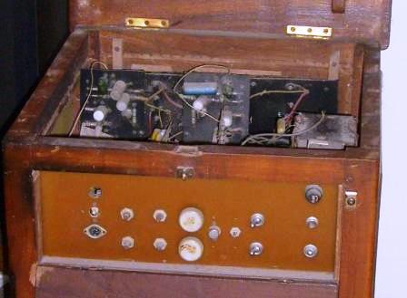

Old JLLH photos
Now that I could successfully upload the first photo, here are three more.
For some boring details:
Myself and my friend (Bachelor at that time) did this as a joint venture. He brought all the materials from Delhi. We assembled as follows. Taken paper based phenolic board, (6 nos), stick graph paper to them, drew the circuit diagram, drilled the holes and assembled exactly as per the diagram lay out. Each channel consists of one preamp board (Burrows), one buffer cum low-high pass board and one Power amplifier board. All the six boards were spreadout on his dining table along with four heat sinks, connected to Two loud speakers, known as Mellow Monsters, constructed from an American DIY magazine. The signal source was a Philips record player with ceramic pickup. This was like that for a few years. In 80, my friend emigrated to US and the boards and Loudspeakers were left with me. Then I assembled the whole thing into a wooden Box and used it for around 8 years.
The circuit used was the one given by JLLH in a letter to use 3055 and 1711 as VAS or phase splitter.There used to be a slight switch on thump. There was also slight hum when heard with ears within 12 inches of the loud speakers. Else, the whole system was very enjoyable.
--gannaji
--gannaji

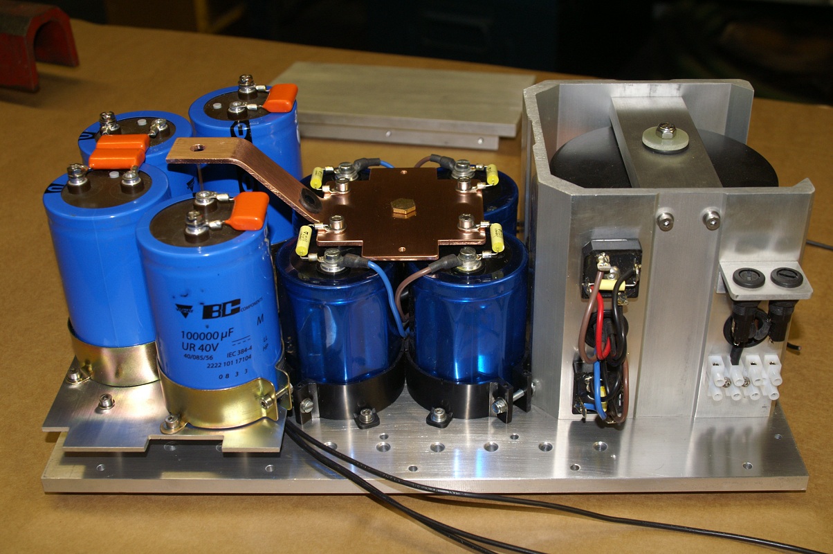

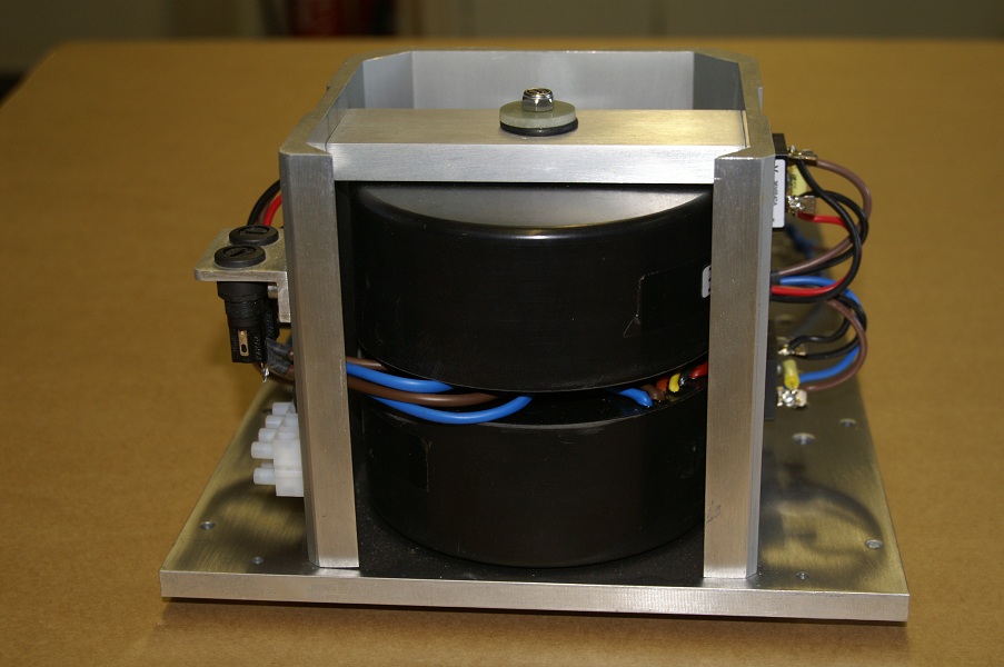

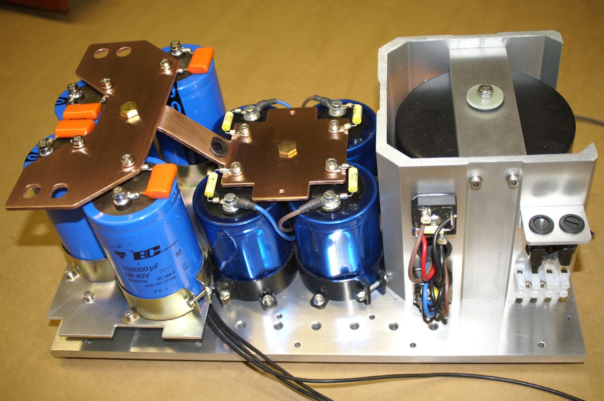

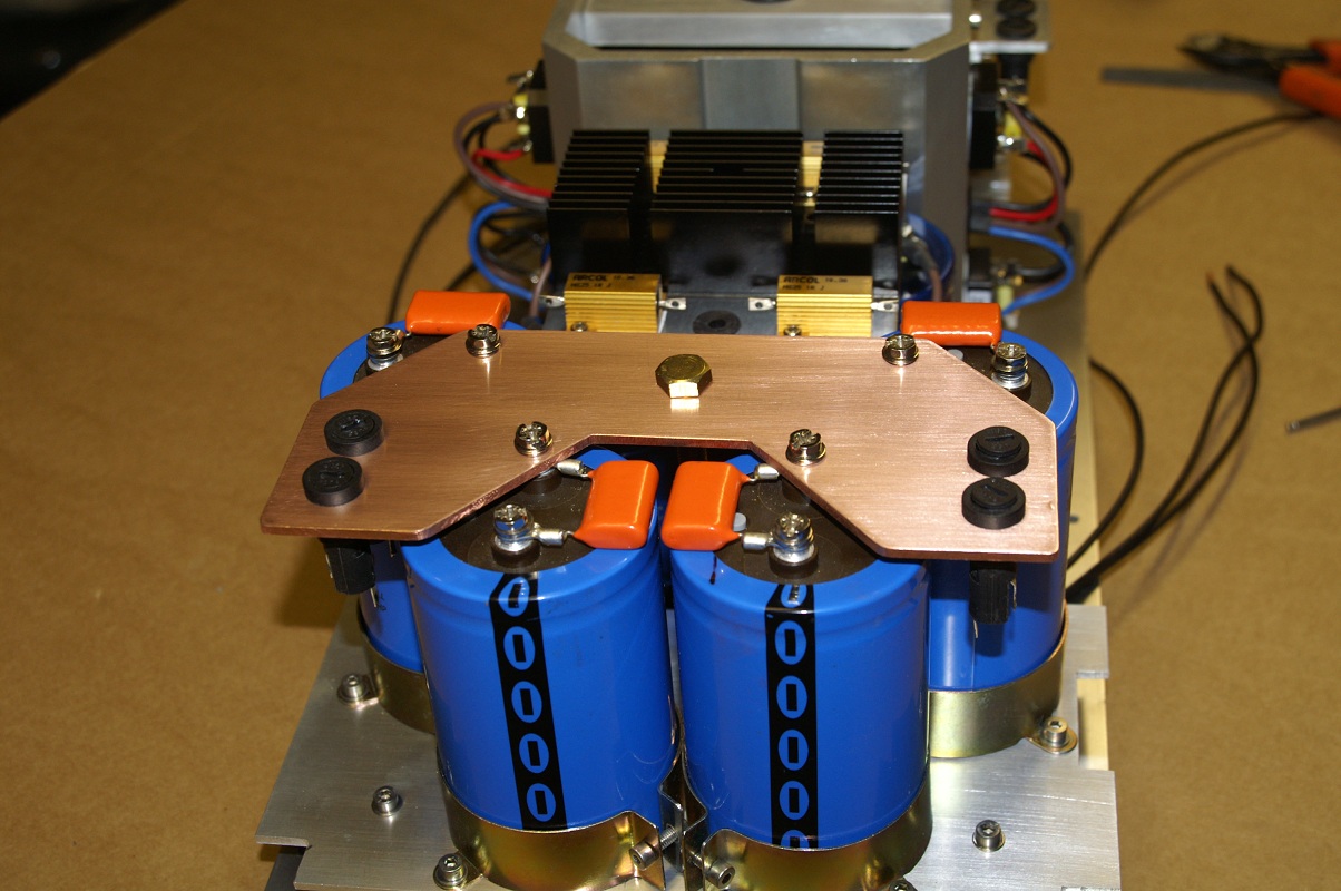

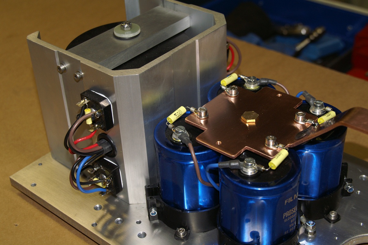

Hi everyone, i have started to construct the power supply ( rightly or wrongly, comments please ) Here is a rundown of progress so far.
2 x 300VA torroids suspended in rubber bushes in an aluminium housing.
2 x 25 Amp bridges for each torroid.
4 x 10,000 uF electrolitics.
4 x 1 OHM 25 watt resistors.
4 x 100,000 uF electrolitics
0.1uf bypass caps.
Fuses on primary of torroids
Fuses before amplifiers
This is all housed in a chassis made of 10mm aluminium plate, 400mm long x 250mm wide x 150mm high. heatsinks will be mounted along both long sides ( heatsinks are 400x 150x40 ).
I will try to post some pics of the work so far, have not posted pics before so appologies if I get it wrong.
Alan
0.1uf bypass caps.

Looks amazing . . . but when it's all connected up to the amp try putting 0.1uF + 47 ohms across each transformer secondary and see if it sounds better.
In my experience it always does and the difference is not small

it looks to me that you have a shorted turn on that toroid 😱
Edit: phew - noticed the insulated washers for the bolt.
Looking good !
Looking good !
I saw this too, but looks like the top toroid is bolted to top plate, while bottom toroid is bolted to bottom plate. There should not be single bolt going through both toroids...or else you will have shorted turn...
EDIT - or the washers...
Hi all, thanks for looking at the pictures. The torroids are suspended by 8mm threaded rod. The rod passes through both and is well insulated top and bottom from the chassis to avoid shorted turn problem. I have mounted the torroids like this to prevent any noise or vibration from them. Seems to work OK as I can put my ear really close when they are on and can't hear a thing.
Will post some more pics as I progress, but it may be a while.
Alan

Hi, I forgot to ask in my last post---MIKELM, 47ohm resistor, what sort of wattage please. Any other advice or help gladly recieved.
Alan
