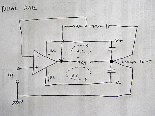

I've attached a simple dual rail supply schematic. It's not the conventional way to draw an amplifier with nfb but I want to make some points.
The signal input is a voltage, sharing a common point of reference to the output. The signal input is a single ended signal over an RCA-connected cable and we assume that the shield of the cable is, practically speaking, connected to the chasis of your source and the chasis of your amplifier (potentially via a ground isolating resistor bypassed by a diode to reduce ground loop hum).
The d.c. current from the power supply flows through the amplifier as shown. With no input signal the amplifier output should be at the same potential as the Common Point so that no dc flows through the speaker and the power supply.
The a.c. signal current in the JLH flows through both upper and lower output devices - call it push-pull or not. Since current flows in closed loops there must be two of them, each including the load and one of the output devices. I've shown these a.c. signal loops. We see that a.c. current must flow through both of the power supply rail capacitors. So we see that a dual rail amplifier does not remove large electrolytic caps out of the load current path.
But we don't find this is a problem because distortion introduced by these caps is reduced to negligible levels because the amplifier has plenty of nfb to correct for it. The nfb network samples the voltage signal at the output from the amplifier - shown by the arrow - and feeds a portion back to the inverting input of the amplifier.
OK so far ?

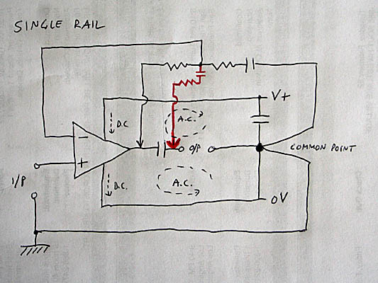

Now I've attached a similar schematic, but this time the original single rail JLH amplifier.
This time we can see that again, the a.c. signal current flows in two closed loops. One of them flows through the output capacitor. The other one flows through both the output capacitor and the power supply rail capacitor. As with the dual rail version, we have two capacitors in the speaker load a.c. current path.
But people say the single version sounds worse. Why ?
I think it may because the distortion in one of these capacitors is no longer adequately corrected for by the nfb. The nfb is sampled at the output of the amplifier as before, shown by an arrow, but this means it doesn't sample the distortion introduced by the output capacitor and therefore can not correct for it.
So I go back to my earlier question - if my understanding of how the amplifier with dual rails and single rail works, the issue is the nfb take off point.
A possible solution is to move the nfb take off point to the load side of the output capacitor, shown by the red arrow. In principle, this should allow the nfb network to correct for the distortion of the output capacitor. There are problems with phase-shifts when capacitors are part of the nfb loop (and potential motor-boating), so a practical design uses a combination of both nfb take off points.
Has anyone tried this - can it make the single rail amplifier sound as good as a dual rail amplifier ????????????

I think you have analysed the amp topology quite well but I think that even if you figure out how to have a dual feedback system the resultant o/p will still be the product of the two f/b paths and not purely the f/b from the far side of the o/p cap - so the result will also me a mix and not as pure as a single f/b loop in an amp without an o/p cap.
Also in both of your diagrams there is an electrolytic cap in the feedback path which will introduce it's own limitations to how accurately the feedback loop can function. This is clearly audible when you remove it.
Have you checked out Geoff's site to see the different versions he shows there ? I think there is a link above somewhere a few posts up - well worth a read

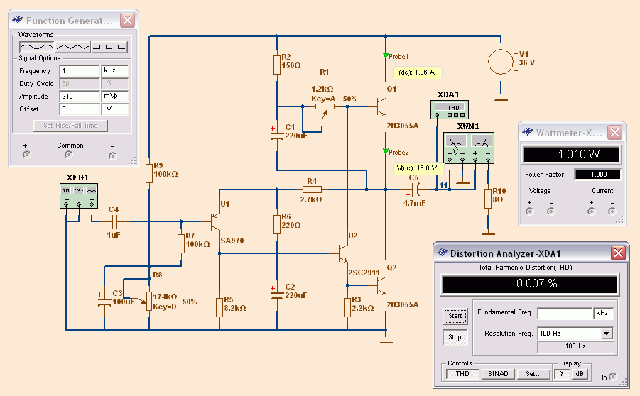

In the JLH Class A original I have tried THD distortion.
When I replaced 2N1711 with 2SC2911 at 1 Watt level
the THD changed from 0.103% to 0.007%.
Conclusion is that to avoid 2N1711 and go for
a transistor like 2SC2911 in that place.
2SC2911 is even considerably better than BD139 in this circuit.
See diagram for the updated JLH Class A.

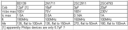

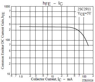

I checked out the data sheet to make some comparisons (attached) - the main concern I have is the 2N1711 has limited current capability and you see this in beta droop above 50mA. The BD139 looks more robust from this perspective.

BD139 SPICE better then 2N1711, too.
But 2SC2911 is yet another level better.
with
1N1711 - 0.203% THD
BD139 - 0.050% THD
2SC2911 - 0.007%
This shows at least, that transistor in this place of the amp
is of great importance for good performance.
Bigun.
That beta curve of 2SC2911 looks nice, to me.
If curve is flat to 50mA, I think it is enough. Depends on the gain of output devices.
We see that the capacitance is where 2SC2911 wins.
Maybe this is importance.
