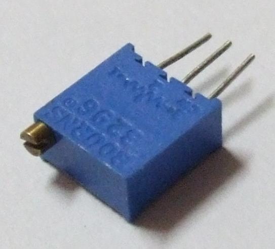

What bias pot are you going to use? Finding pots large enough for the `69 design can be difficult. If you find some that are suitable I might make one too.

I believe JLH used SOT fixed resistors, i.e. 'select on test' which maybe what I'm going to do too. There are big pots out there, but they don't tend to be 'hi-fi' and I'm reluctant to put anything nasty into the current path.
I was considering a switch, to allow me to select 'hi current' and 'low current' settings by switching in additional resistance in parallel with the fixed resistor. This does mean putting switch contacts in the signal path...
Ah yes, fair call. Sounds good although it might take some fiddling to get two channels exactly the same. What a nice "pure" amplifier topology though 🙂
