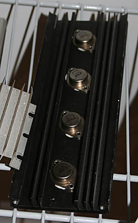

I have 4 heatsinks (see photo attached showing one of them, they are all the same) that were stripped out of old regulated power supplies, I will add additional metal heatsinking to improve power dissipation. With 4 in total I can use 2 of these heatsinks per channel. As you can see from the photo, there are 4 power devices riveted onto each heatsink which if they are all still working are already matched as they are wired up in parallel on the flip side of the heatsink with 0R1 emitter resistors. So I'd end up with quadruple-2N3055 outputs.
I read on this thread and others that the 2N3055 is worse than rubbish. One of the main complaints is bandwidth - although this does apparently help with stability. Another major complaint is beta-droop. I checked the data sheet (see attached photo) and it looks pretty awful. However, there is a current range where Hfe doesn't vary too much - looks to me like you want to avoid going above 500mA. So with 4 devices biassed at 250mA each I'd have an idle current of 1A and a peak output of 2A as well as very hot heatsinks - but it looks doable.
Would I be wasting two good transformers on these ancient transistors ? - did anyone try a pair of BD139s as drivers for the output devices ?

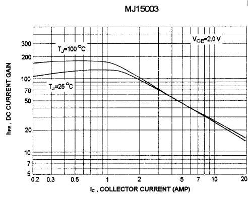

The MJ15003 are a good choice, both sound-wise and spec-wise. Similar to the 21193 and a little cheaper. I also use 139s as drivers with no complaints.
I used to use 2N3055s as outputs (and in the regulators where I still use them). This is a good sounding amp with the 3055s but the 15003s take it to the next level of smoothness. In other words the 3055s sound a little grainy by comparison.

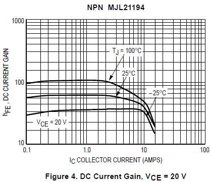

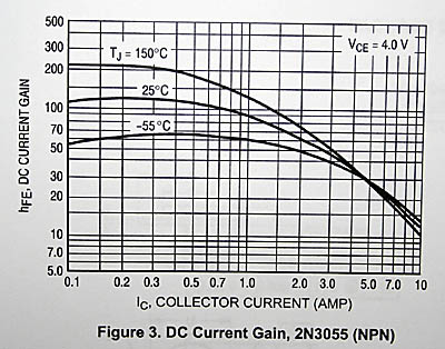

I think it would easiest for me to use what I have of course, which means starting of with the 2N3055H's. If I then wanted to swap them out I'd want to replace them with TO-3s so as to use the same heatsinks. I usually buy from digikey, they don't have the MJL's in that package style but they do have the MJ15003's though.
I've looked at the data sheet and it is very similar to the 2N3055, ft is only 2MHz which is actually a bit lower than the 2N3055H, suggesting Cob is similar. The beta droop is improved though (see attached) giving good performance out to 1A. But if this is the only benefit I'm already mitigating this by employing additional output pairs ??
Edit: attached beta curve for the MJL part for comparison, it's the better part on this basis.
So, if I use 2N3055 in quantity I mitigate beta droop. Does this 'fix' the problem, what else do I need to learn about transistor performance ?

The 15003 was a direct swap. I was using doubled up 2N3055s before (ie: 8 devices per stereo amp). The MJ15003 I used singularly (4 per stereo amp). It took half an hour to do the swap and measure up only to find I didn't need to adjust anything.

Thanks, that link certainly paints a strong recommendation for the MJ15003. Trouble is, it means I'm really starting from scratch rather than using what I got, but it seems from the experiences of others that it's worth the trouble.
Still I'm surprised and intrigues why the MJ1 is providing such clear sonic benefits over the 2N3055 - in your case the beta droop should not have been a big issue as you had double the number of 2N3055's - I can't see why from the datasheets and I feel there should be some explanation.

Just build it with what you have and sub the other parts later when and if you decide you want more. They are a direct swap.

MJL is the plastic package equivalent of the metal package MJ device.If I then wanted to swap them out I'd want to replace them with TO-3s so as to use the same heatsinks. I usually buy from digikey, they don't have the MJL's in that package style but they do have the MJ15003's though.
Check the datasheet. The thermal data is slightly different between a To264 MJL and a To3 MJ

There seems to be a lot of "hot air" about the 2N3055. The 2N3055 today is not the same as RCA made originally. TOday's epitaxial type will have a higher fT than the original and should give a good frequency response.
But it has still got droop. A discussion of the standing current occured in Wireless WOrld after publishing the JLLH article. Gain droop did not feature in JLLH's reply, but he came close. The point is that the standing current needs to be higher than it should be from simple calculations. Typically, if the gain droop is 55 to 45 from 1A to 2A then the quiescent current of a Class A should be nearer 1.2A than 1A. The point is that the lower output transistor can only function by stealing current from the base from the upper, so if there is insufficient, the amplifier could go into Class B at higher outputs. I don't know if this is the cause of the 2N3055 JLLH sounding "bad", but it won't help. JLLH alluded to this but did not quite say so.
The MJ21194 transistor has a much reduced droop and this distortion mechanism will be less. I have not run a side-by-side test but if modern 2N3055's are used and run with a highish bias they should be fine.
