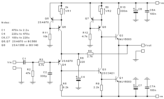

I have the need for a unity gain output buffer to drive 8 ohms. I'd like to use a JLH but don't want to waste the gain. Has one been made into a buffer, or is there maybe a way I can strip the first stage or maybe even eliminate the driver and drive an output stage directly?

From what i've found, this is the most recent update to the JLH Class A - High Power Circuit? (Figur 3)
The Class-A Amplifier Site - JLH Class-A Update
And figur 2 is the most recent "normal" one?

I think figure 2 is the most advanced, the constant current sources are a big technical improvement to the design together with modern device choices.

If you remove active devices you will have to look at all dc conditions again.
You could remove the negative feedback components from the input Tr to ground R6 and C4 . That will make it a unity gain buffer . However you might have to check it's stability . I tried my sim on the design with other output transistors and it appears to be stable with unity gain. But you need to check it out in practice as the spice models may not be accurate and give wrong results.
Note Q1 Vce must be able to handle the full supply voltage . So for a +/- 30 volt supply it should handle more than 60 volts across collector and emitter to avoid breakdown!

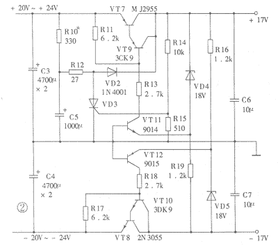

Hi, everyone, this is my first post to this thread. Last year I constructed 3 class A amplifiers to run listening comparison tests. These were Hiraga 20W Krell KSA50 ( which I limited to 25W ) and JLH 2005. I used the same power supply for all of them, which was 100,000micro farad resovoir followed by a capacitance multiplyer for both + and - rails. the voltage was +-22V.
I decided from listening that the amplifier I would be most happy with was the JLH.
Unfortunately for personal reasons I had to abandon my hobby, but I am now in the position to start again with the final product. I need some advice regarding the power supply.
Should I stay with the capaciance multiplyer.
Should I use the series regulator from 2005
Should I use a simple C L C.
Any advice or views would be much appreciated.

Hi Alan,
KSA50 running +/-45~50V on rails will be much much better than +/-22V. I'm running +/-48V, 650mA per transistor. It is hot, but it is worth to.
On my own idea, for an amplifier, a bigger transformer is rather better than more capacitance. For instance, my machine has 28000uf per rail, but transformer has about 500W.
CLC is good. But inductance is expensive normally. So I use a CRC, i.e. 14000uf+0.47Ohm 10W+14000uf. That will be also a good solution.
Hope above helps. Have fun. 😉
Thanks la Mer for the reply. I purposely built the KSA50 to run on +-22v to keep heat dissapation down to an acceptible level ( the people on the KSA forum were very helpful in guiding me through component alterations to suit the lower voltage). I found the Krell to be very easy to set up with offset voltage at near zero and not altering during warm up. The Hiraga seemed to be the most sensitive to offset problems, moreso than the JLH.
I tried to be subjective when comparing, and I must say I liked them all, but there was something about the JLH that made me think i could listen to it for a long time. ( just me I expect )
I will start building the final version after Christmas and I think I will go with the C R C or C L C unless someone can persaude me differently.
