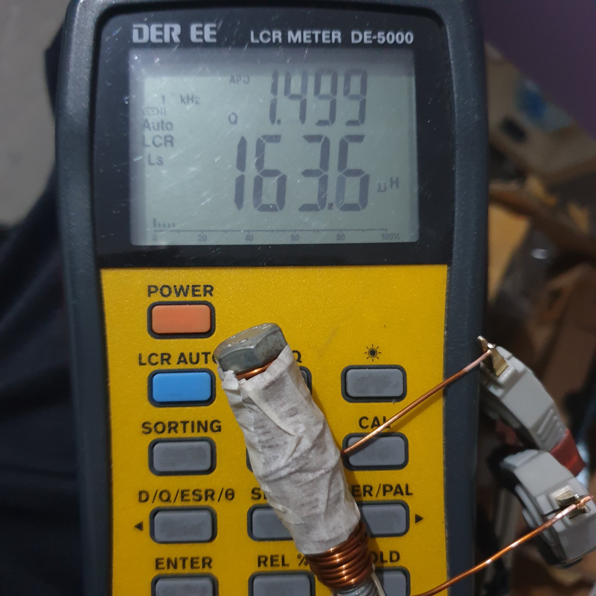

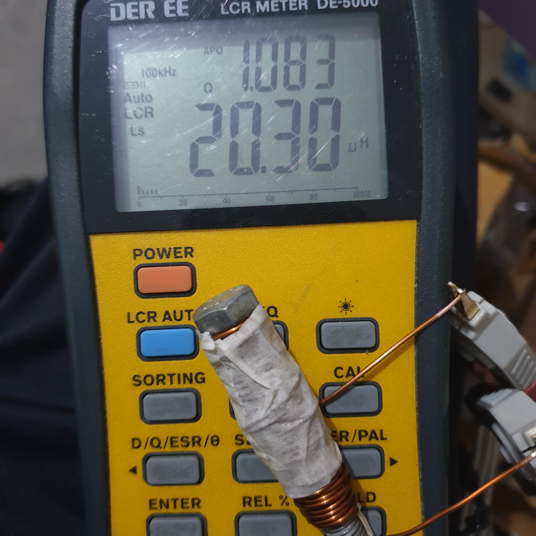

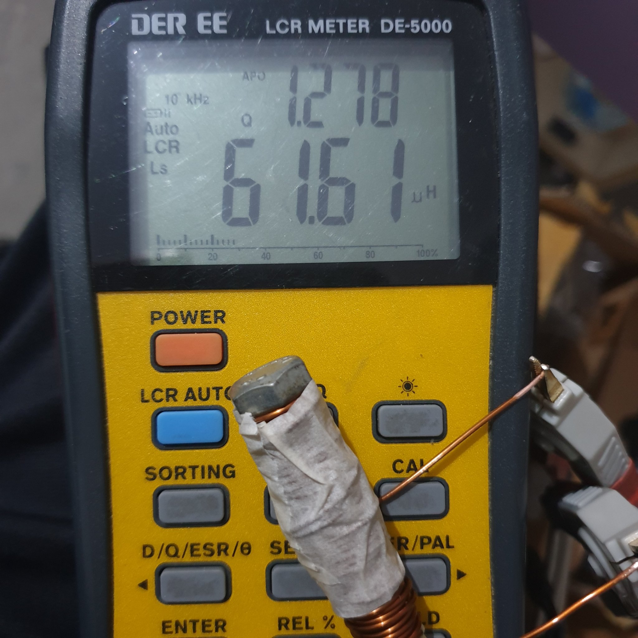

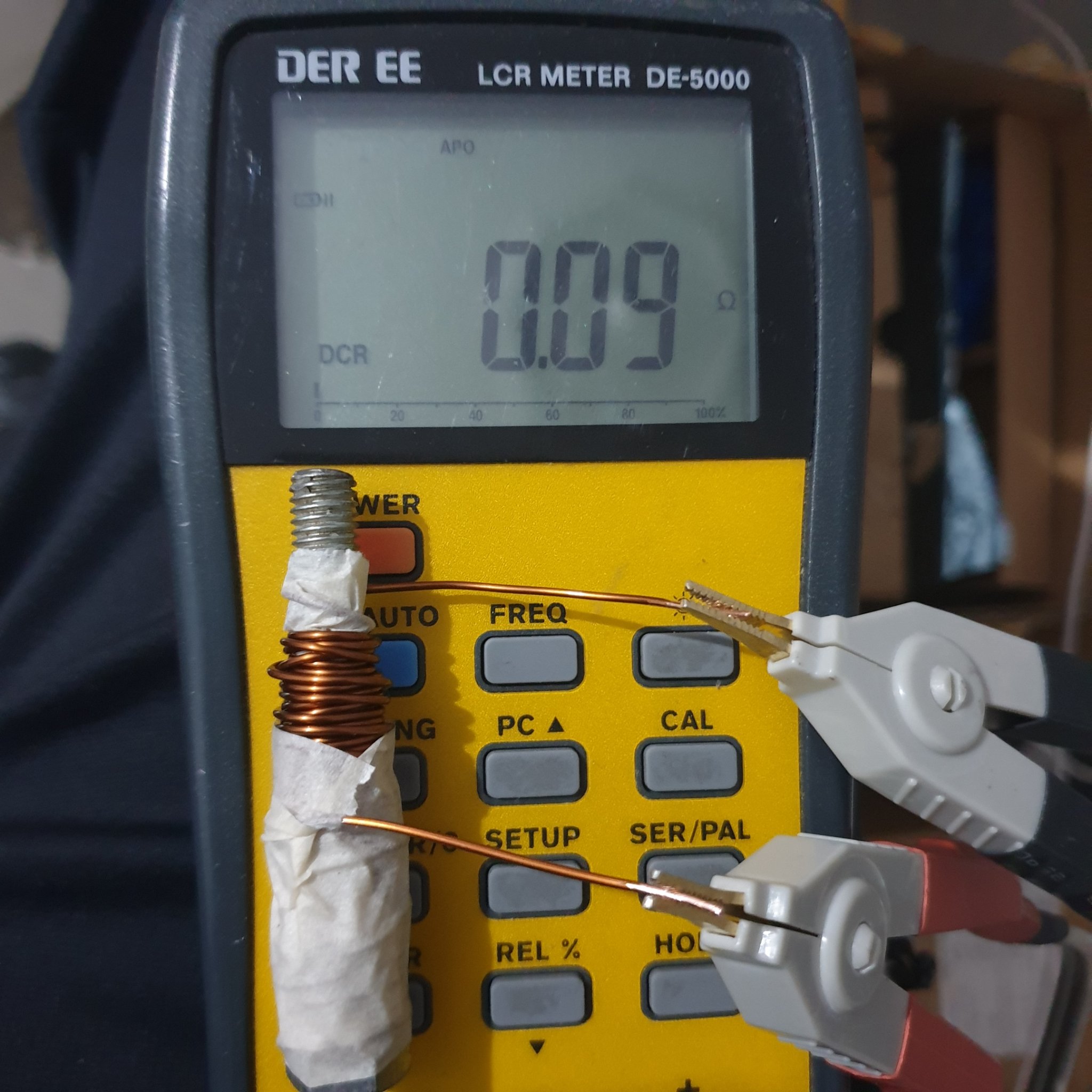

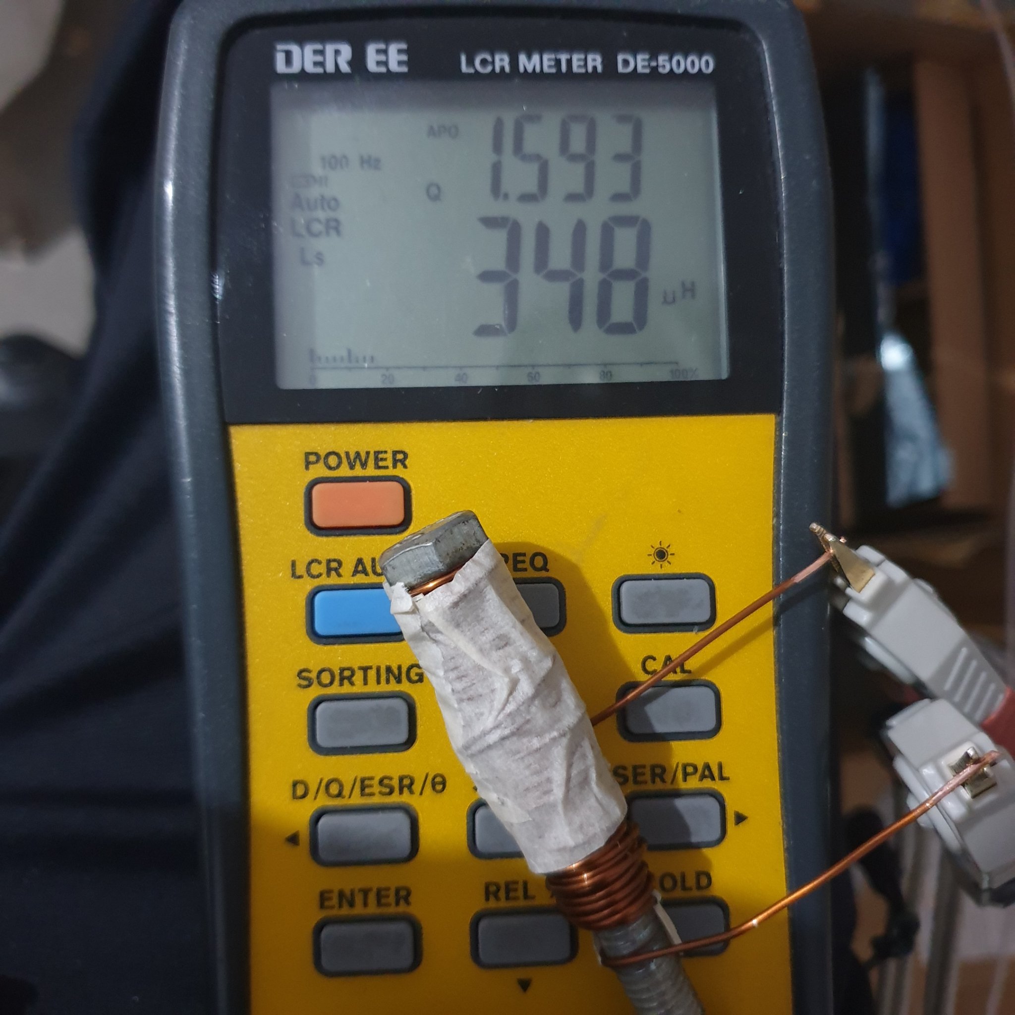

Idea of iron core inductor bad for CLC power supply? Is it better than no L ? And i found a bolt what about winding on it ? Is it a bad idea ? It is about 25grammes of copper 1mm diameter.348uH @100Hz but I can wind more of it and maybe it may be useful for CLC

According to the article linked below, you could need something like a 250-500mH choke for either an LC or CLC (pi) filter. That's quite a lot more than 348 uH so are you sure you're reading up sufficiently on this project? Read here why CLC may not be the best type of filter to use either: https://www.jacmusic.com/techcorner/ARTICLES/English/Power-Supply-Design/Index-Note-01.html 00cl

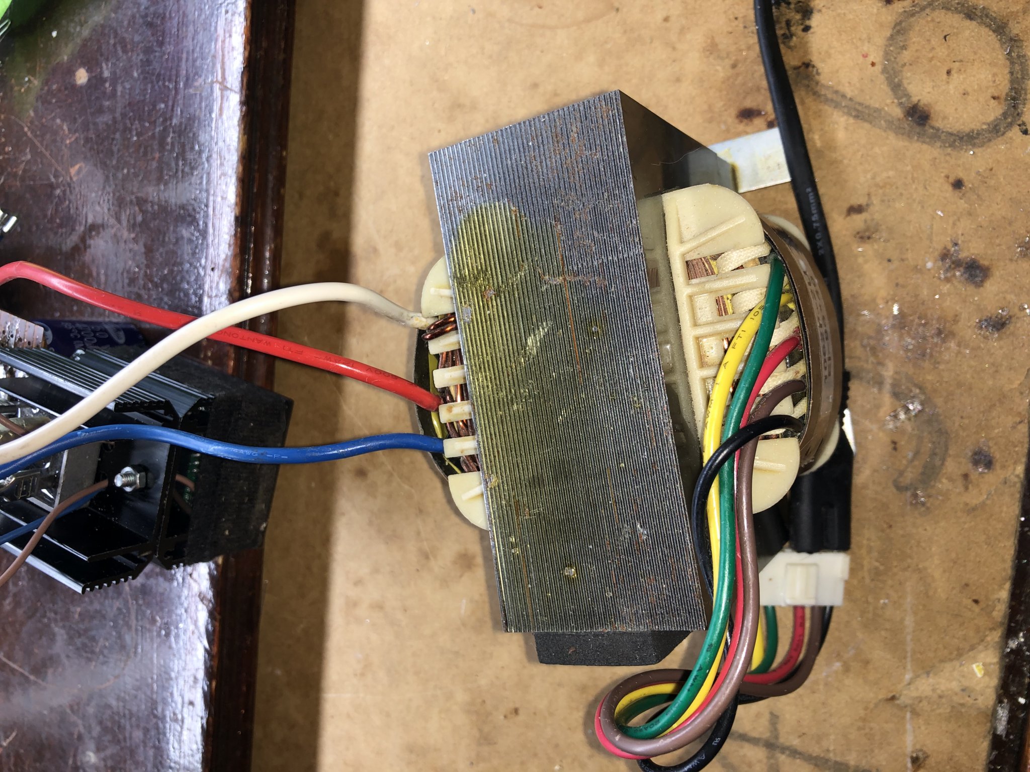

I have a similar UPS Transformer.It is 2x8v ac transformer.Not single 8v. It makes about 19vdc loaded at 8A.It is minimum 200VA transformer.
Alixpress isn't a reliable source for semiconductors but good for other thing. But yes their price is very attractive.
I thought you're going to use each winding separately. 200VA sounds good.

The article referred to (Power Supply Considerations) is only a few pages of plain text. The rest is diagrams, graphs and a couple of summaries. There is no need to look at the tube power supply comments which refer to high voltages either. So take another look since there is no point in building, making chokes etc. for a project that is doomed to failure before you begin - only because you haven't learnt how it should work yet.I thought about 1-2 mH may be enough because of Aleph amplifiers use it. 500mH may be too big for air core. And yes English is not my native language and it is very hard for me to read more than 400 pages sorry. Thank you

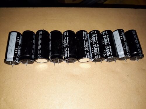

Which option is better in your opinion? I have 40pcs of Rubycon 6800uF 25v 105c capacitors .They measure about 6200uF each. I can make power supply with them.I will not build dual rail.Ac voltage is 16v.It makes 19vdc after rectified and loaded.Nelson suggest CRC but i did not see CRC here but maybe someone can advise if any.
Or i can loose some voltage and make regulator for JLH and think it will drop to 15-16v. I will build this amp for my friend which has limited budget. (i will use UPS power supply and do not buy another transformer)
My friends speakers are 8ohms.Focal 714.
Much better than C-Resistor-C sounds a C-Choke-C. Try to use any transformator, e.g. 100 VA, 2 x 12 V. Use the secondary windings. The primary winding you could use to break down the inductivity to hear the effect - per shorting. Then you get CRC only;-)
I would try 4 Caps - Choke - 4 Caps. Should sound very well.
No further little foil caps or so on!
It will work fine, just like the original published design without optional smoothing or regulation of the power supply. Build it with the simple power supply shown at Fig.1 of the postscript article (linked below) first, mount it properly in its metal chassis/case and then listen before deciding what is strictly necessary for your friend. http://www.sound-au.com/tcaas/jlh1970.pdf
Use the 2 x 8 V = 16 V winding-s;-)Sorry i can only use my transformer for my friend. It is 2x8vac or 16v ac.
