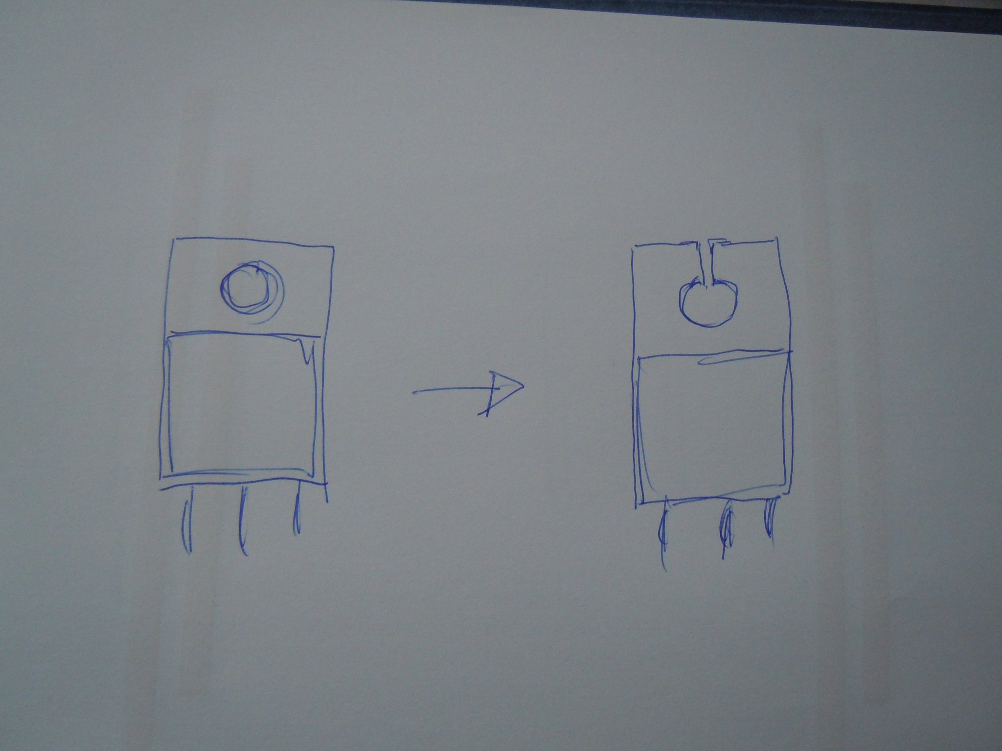

On the side:
Slit, cut your transistors in designs with mounting holes, like TO-126, TO-220, TO-247..., in the following way - (at least):

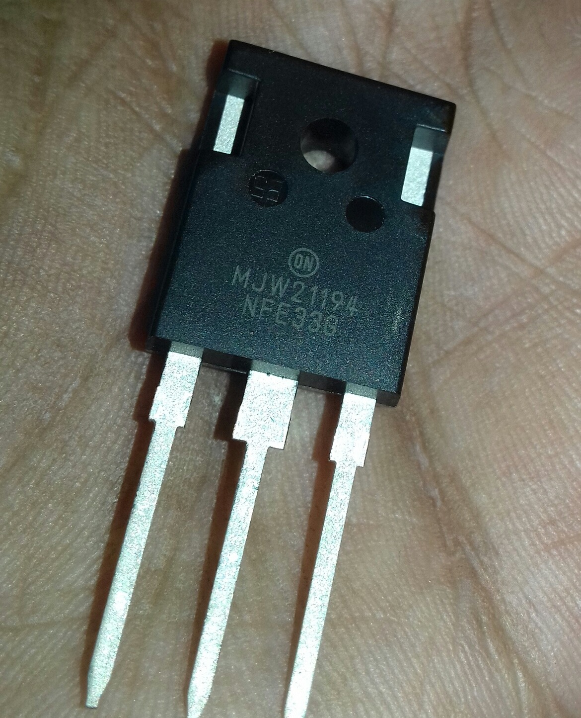

You're comparing a 200w transistor with 125w tip35c. Of course it is better & will work fine. But what do you mean by another brand? I have only seen Onsemi made 21194.
It is this one
US $28.00 | Aoweziic 2021+ 20 PCS = 10 Pair 100% New Original NJW21193G NJW21194G NJW21193 NJW21194 TO-247 Audio Power Amplifier
https://a.aliexpress.com/_EHwHY2P
Maybe it is good for class Ab but not necessary for class A

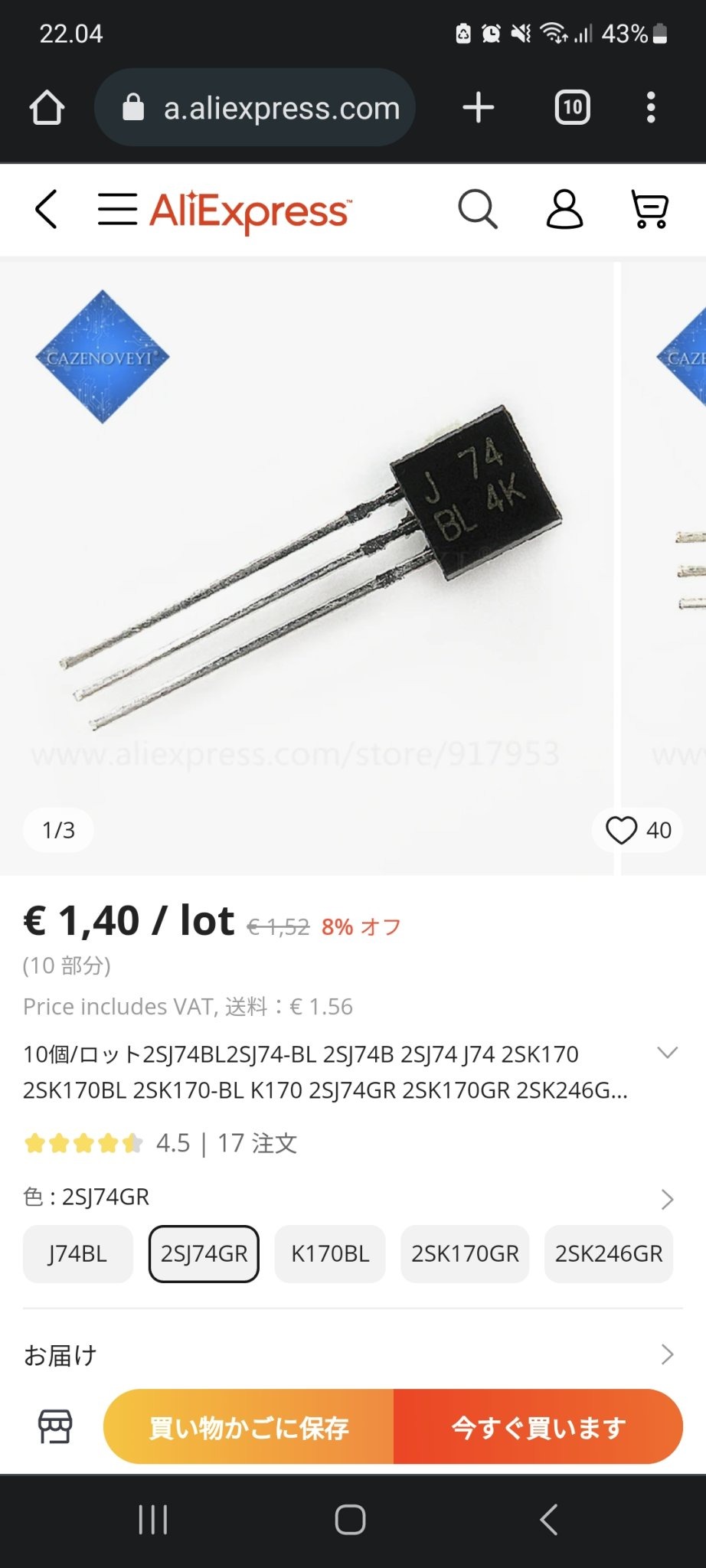

+1 buy all components from a reliable source. On ali you can find rare transistors dirt cheap that are dificult to find elsewhere.
If only that were true. If anyone has bought genuine 2SK170 or 2SJ74 for a pittance like 14P each in recent times, I'd like to congratulate them on their good luck and offer condolences to all the sellers who decided to sell off their "rare" parts all at the same time. These copies may meet the general specification of the parts as marked but they definitely won't be genuine Toshiba products. They are dirt cheap at Ali and similar marketing platforms for a reason........:cannotbe:

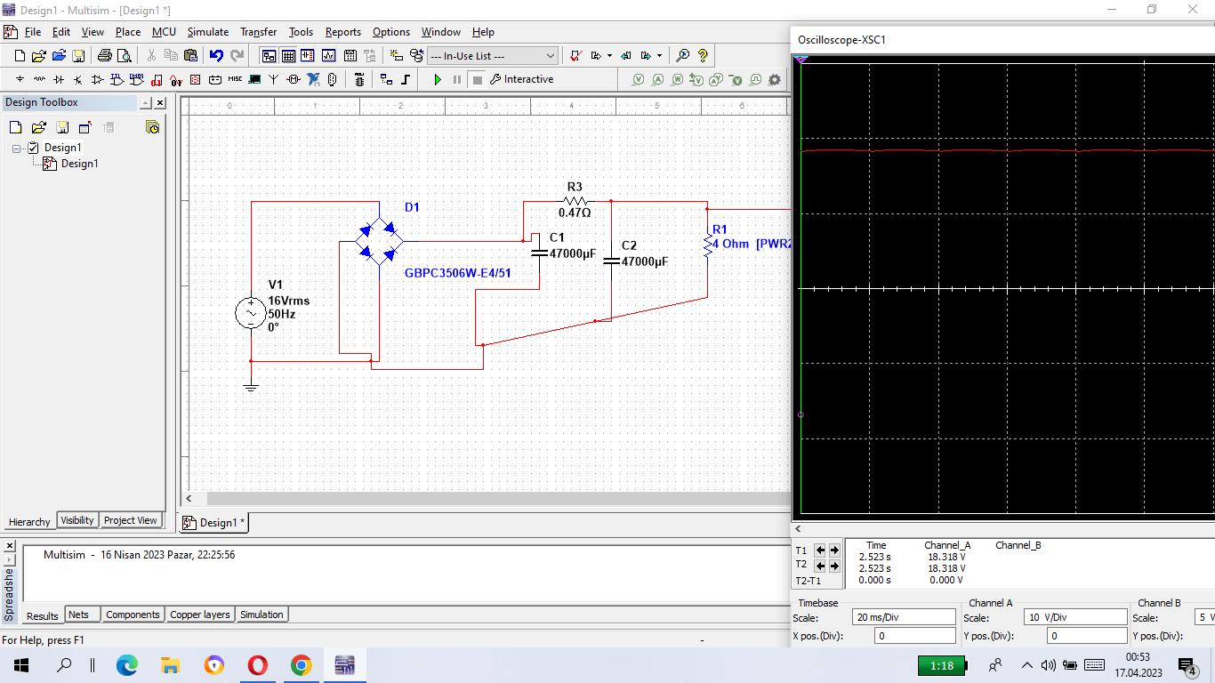

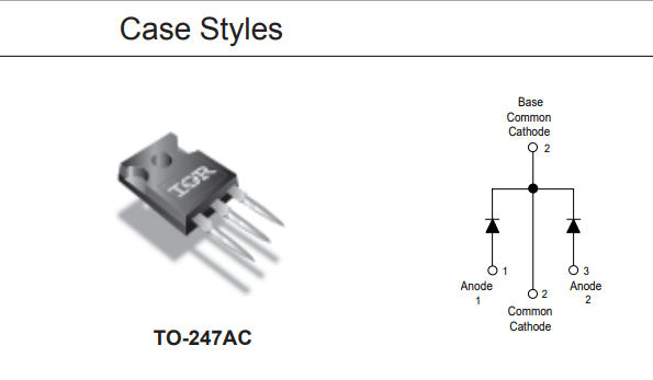

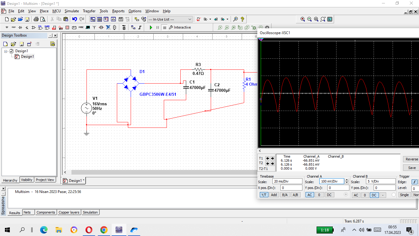

I have made some simulations for 4ohm load ( 5 amperes approx) Here is ripple voltages.Maybe i can use some coil inductors to reduce ripple.But i think i will use iron core to save voltage. And i have 40CPQ045 diodes.Can i connect 1 and 3 pins of this diode and use it as single diode? Use 4 of them to make bridge diode?(i heard paralelling diodes is not good but maybe it can be done for this diode) They have very low voltage drop.

Mains power ripple of 50 or 60Hz is an essential feature of all domestic AC supplies but the noise I refer to is from interfering sources - heavy equipment that radiates or leaks its own, often randomly generated noise back into the power grid. Welders, commutated (brush) motors, switch-mode power supplies and many other large, mains powered devices do this unless their supplies are appropriately filtered.
For example, commercial (heavy duty equipment) power users often have faulty equipment that can make it impossible for local residents to watch TV, listen to music etc. without interference. Normally, some low level of environmental noise leaks into your audio system and becomes audible, whatever protections you have in place, but careful filtering of the power supply and other external connections can usually reduce that to negligible levels.
Alixpress isn't a reliable source for semiconductors but good for other thing. But yes their price is very attractive.
