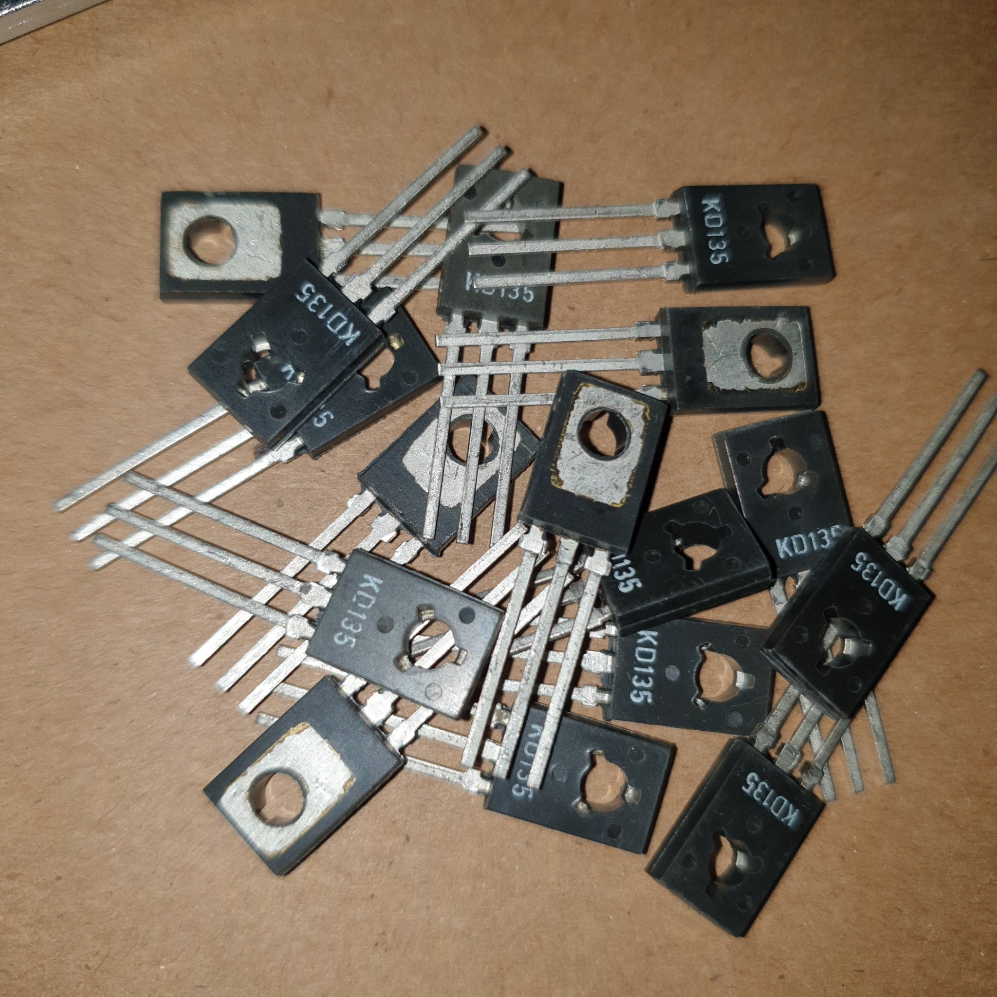

Hi. I measured 10uA (Ib) with my chinese hfe meter and Hfe's are between 100 and 300 and mostly around 175. Maybe i can use around 250 Hfe ones which i found about 10pcs from about 100pcs.
My supplier told that he has oroginal st bd237 but it seems Ft is not enough for Jlh
