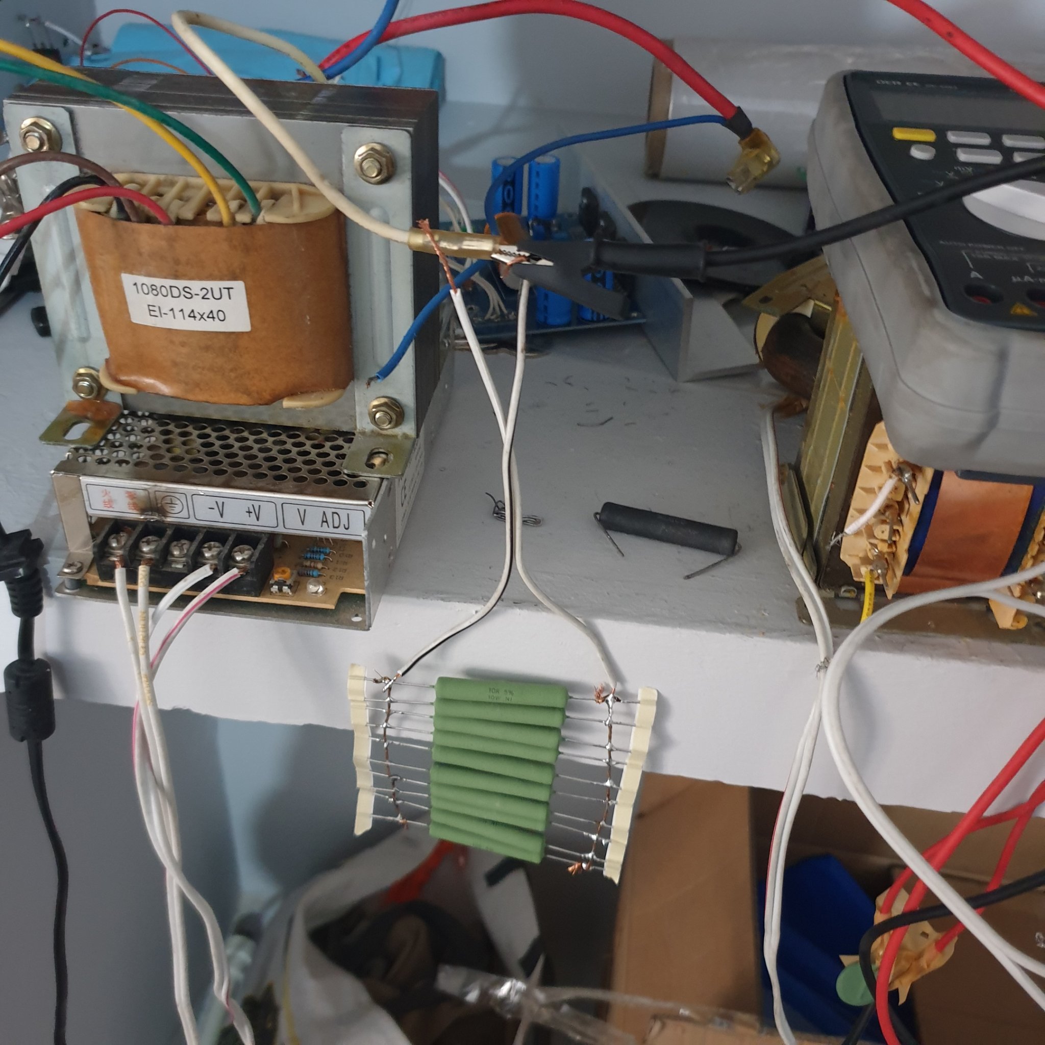

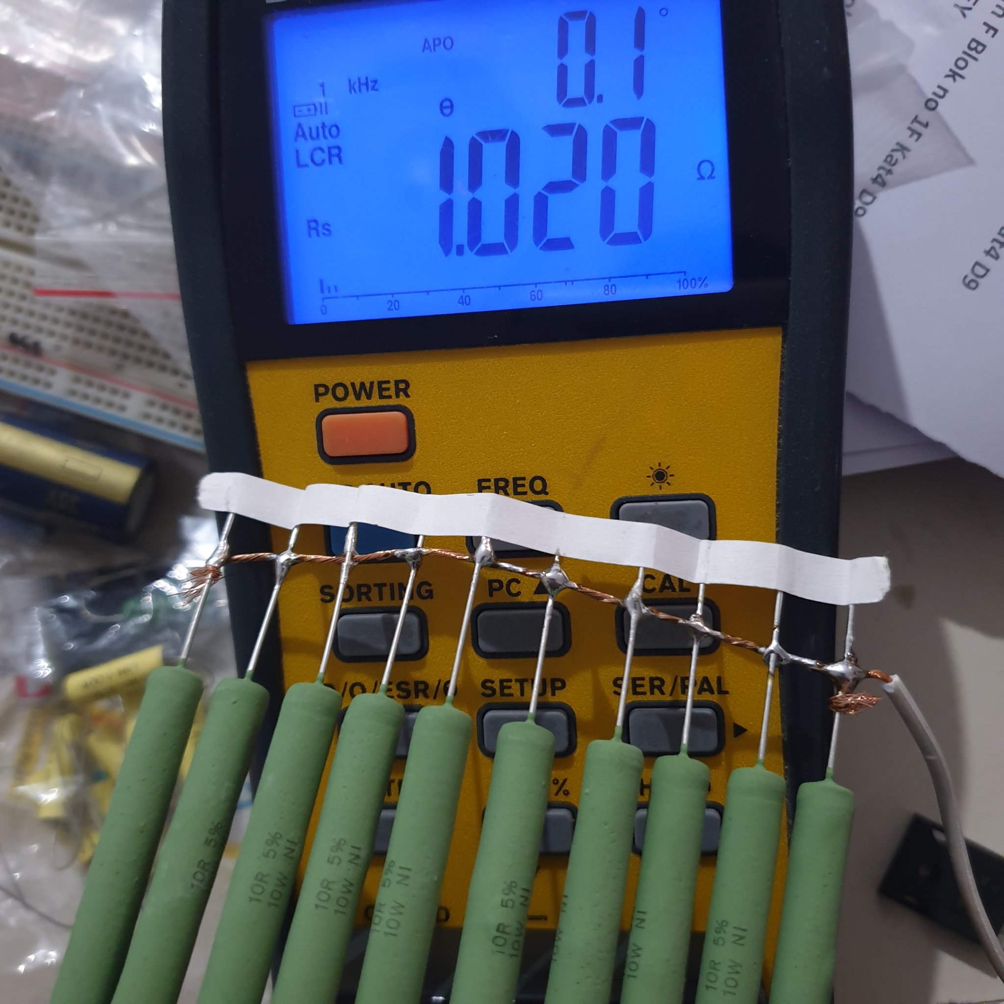

I could not connect Filter right now ,transformer cables are too thick to fit pcb, but i made 1R 100w resistor with Vishay AC 10 NI non inductive 10R resistors. Here is approx results with no load and after connecting test resistor. Red is common cable.
Red white cables 8.10v to 7.72v
Red blue cables 8.08v to 7.64v
Blue white cables 16.12v to 14.52v

If I understand your results you are seeing less than 0.5V drop for 7A load. Is that right?
If the transformer is 114x40mm it should be something in the region of 150W so at 16V output that seems right for approx. 8-9A. That should be plenty to run a JLH for 4 ohms and you might be able to get 10W from it, per channel, but you would need high current low voltage drop rectifiers and large reservoir capacitors.

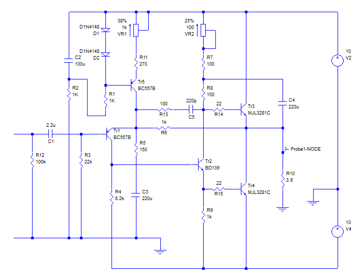

Well, I don't know either.
But a first pass simulation would be along the lines of the circuit I've attached. It has the 1996 input current source (modified to use diodes instead of a transistor limiter) but a bootstrap driver to maintain high efficiency.
As regards the choice of output transistors, it's not obvious at the moment. For best HF response the modern devices are winners, but people report stability problems with them. Also, modern devices tend to have quasi-saturation effects which reduces the gain at low colelctor voltages and higher currents. I would suggest some of the older but higher frequency devices like the 2N5882 perhaps, which have lots of current and maintain a high gain at relatively low voltages, but the HF response won't be so good.
And because the supply voltages are low, we're struggling to obtain low distortion at low impedance loads near clipping. So, I have reduced the feedback resistor and grounding resistor to reduce the distortion a little. It simulates at .07% at 7W into 3.9 ohms. If your PSU gives you 11V that will help.
To aid with stability I've included a 220pF phase lead capacitor and base stopper resistors in the MJL's.
Caveat and warnings- not optimised, not built, not tested, and the bias resistor pots may need some playing around with.
If anyone wants to chime in please do so.

In JLH's I have built with 2SC5200's and MJL3281A's, one needed a 33pF compensation capacitor, the other not. With increased feedback for low resistance loads to keep the distortion low, I suspect that the scheme I showed in the post above would be better, but to note that the base stopper resistors may need to change depending on the output transistors used. The problem with these is that they will clip the negative output voltage if too high.

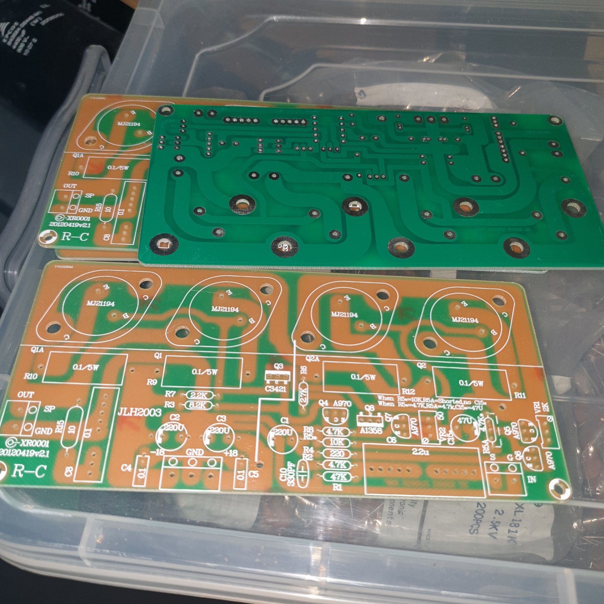

Hi. I also have pcbs jlh 2003 and 4 x 18v ac seperate output 500Va toroidal transformer too.I have 2n3773 and 2sc5200 toshiba transistors. Which Can i use them?
My friend told that jlh2003 will not work well because it does not have thermal compensation ( bias transistor not attached on heatsink) I have many options. I am confused which one to build. I am just looking for best sounding single ended class a which have 15-20w power to 4 ohm. ( i have ta2020 class d right now and happy with it but looking for better sounding amp)
I think this board is a more advanced design contributed by Tim Andrew and last updated July, 2003. It's title is very likely "JLH Class-A Update" and you can locate it at The Class A amplifier site - originally started by Geoff Moss, now an archive hosted by ESP. http://www.sound-au.com/tcaas/jlhupdate.htm
There is plenty of comment, variations and explanations of what and why changes were made as the design was developed. However, this is a work of refinement and perfection by a musician. Who knows what you will hear with the choice of components and semis that are available to you? I would be thinking carefully about the options.

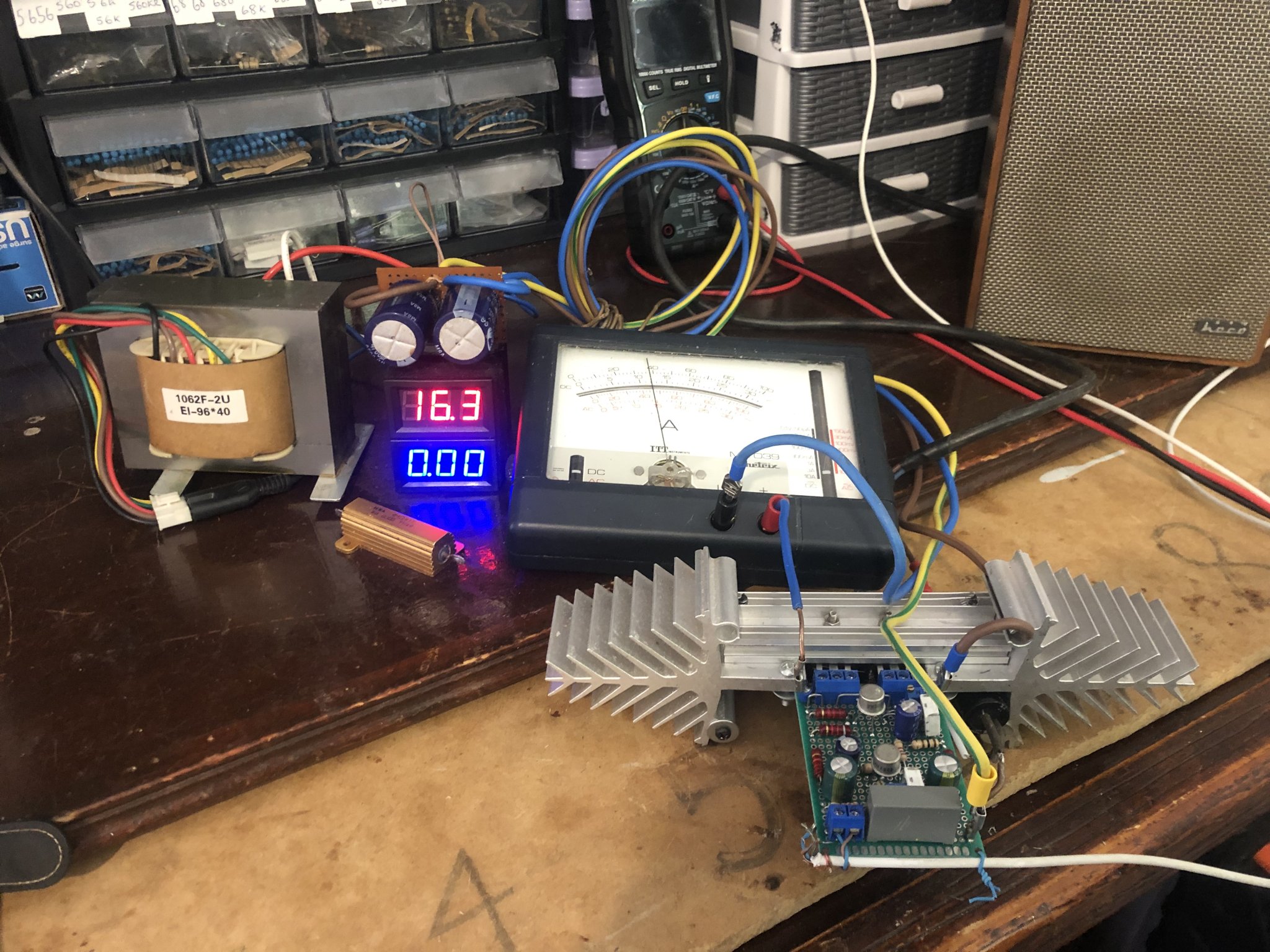

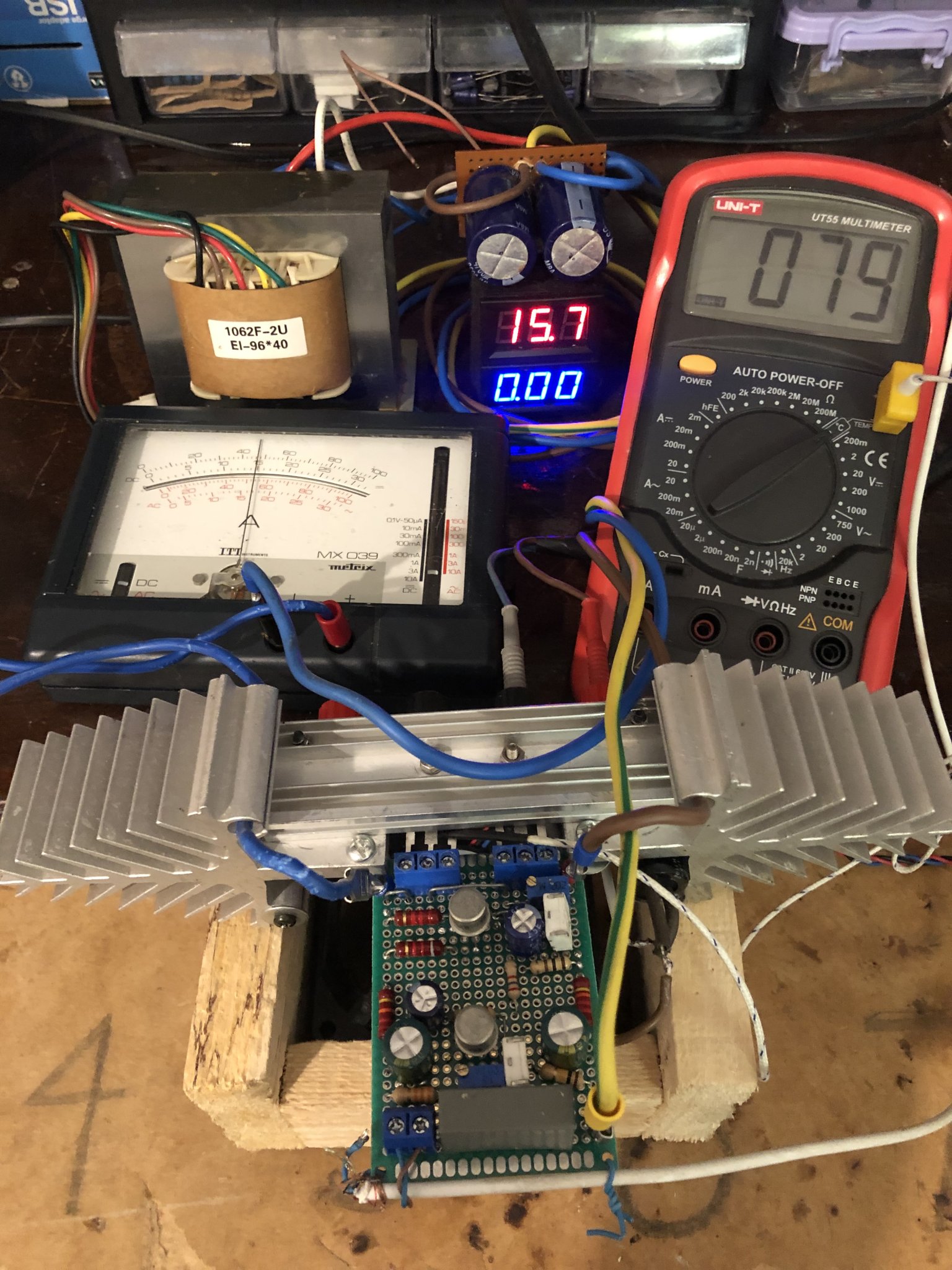

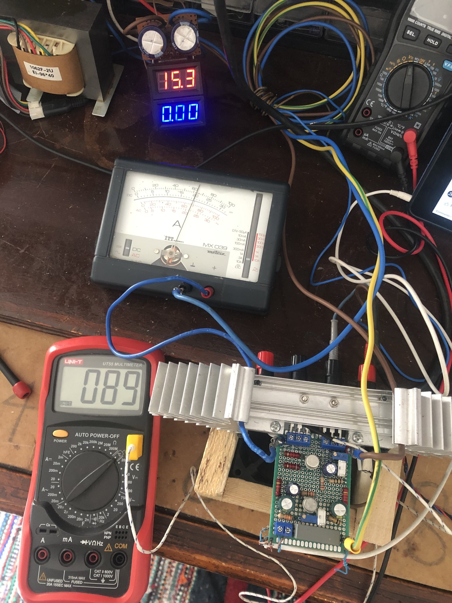

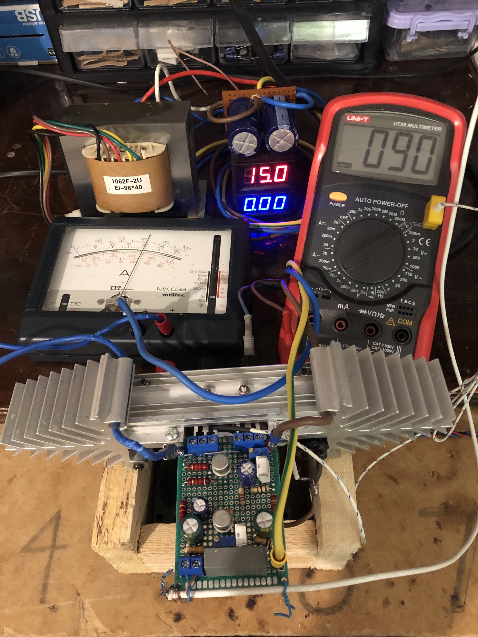

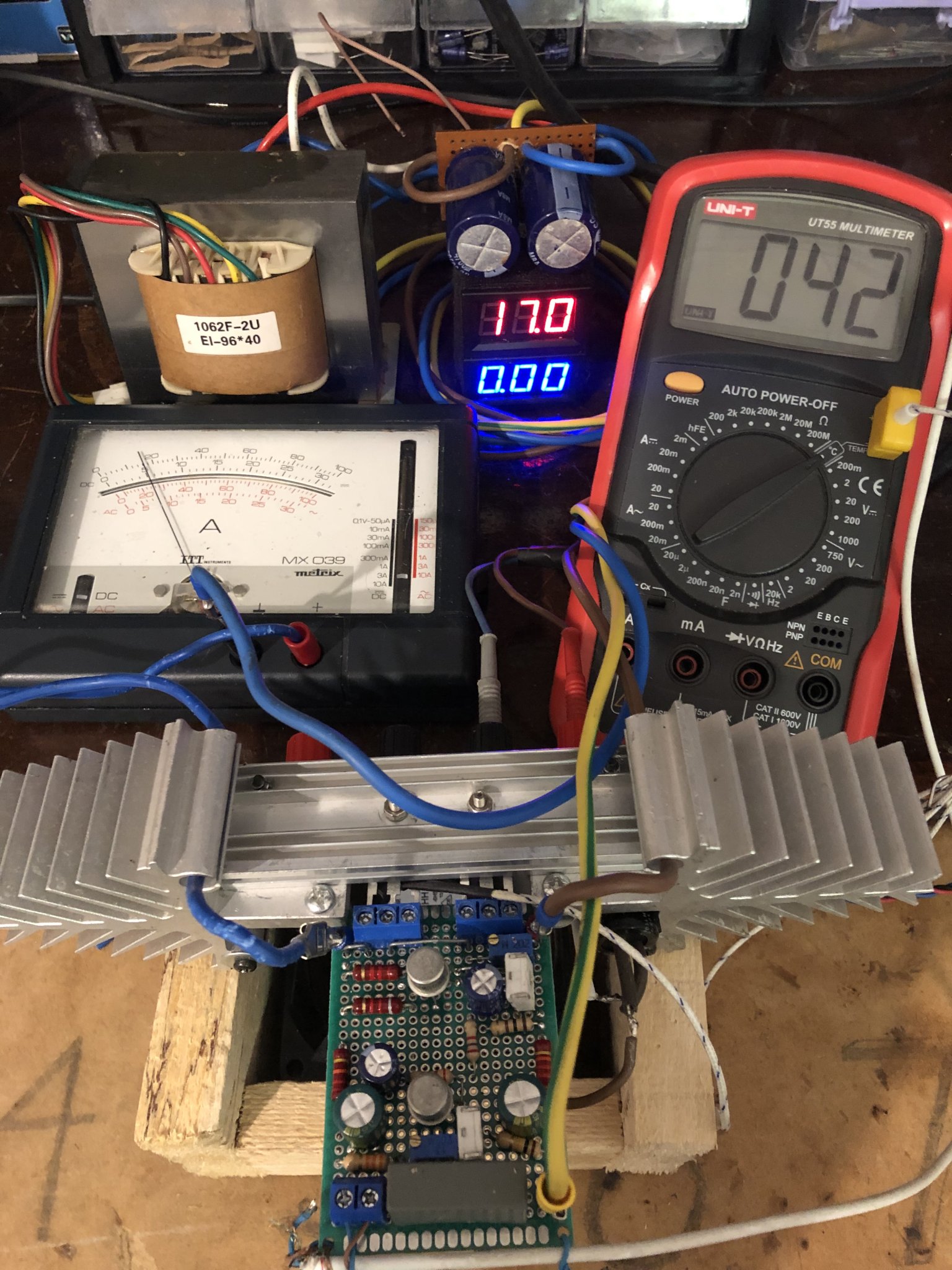

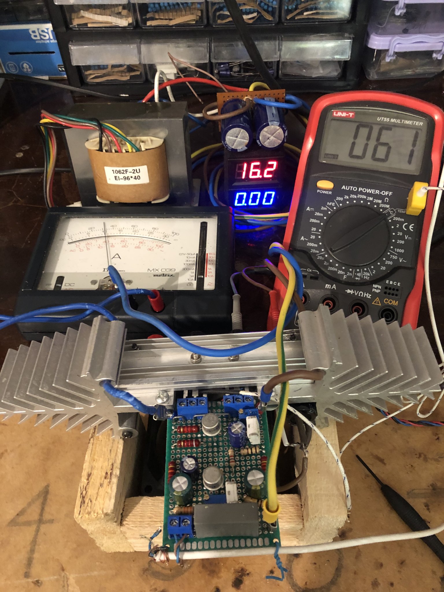

However since that post I’ve tried gradually increasing the quiescent on my JLH69 dual rail prototype to 2 A , and the voltage across both rails actually reduced to 15 volts. I am not able to get over 2 amps as it increases quickly & a hum is heard in the speaker. Besides the temperature increases to about 90 degree’s Celsius. Here are some pictures of it when the output to the speaker has been adjusted to zero with the quiescent current set to
500 mA
1 A
1.5 A
And finally 2 A
All the above are fan cooled as the heat sink was getting uncomfortably hot at high quiescent currents.
William
Reactions: Veysel
