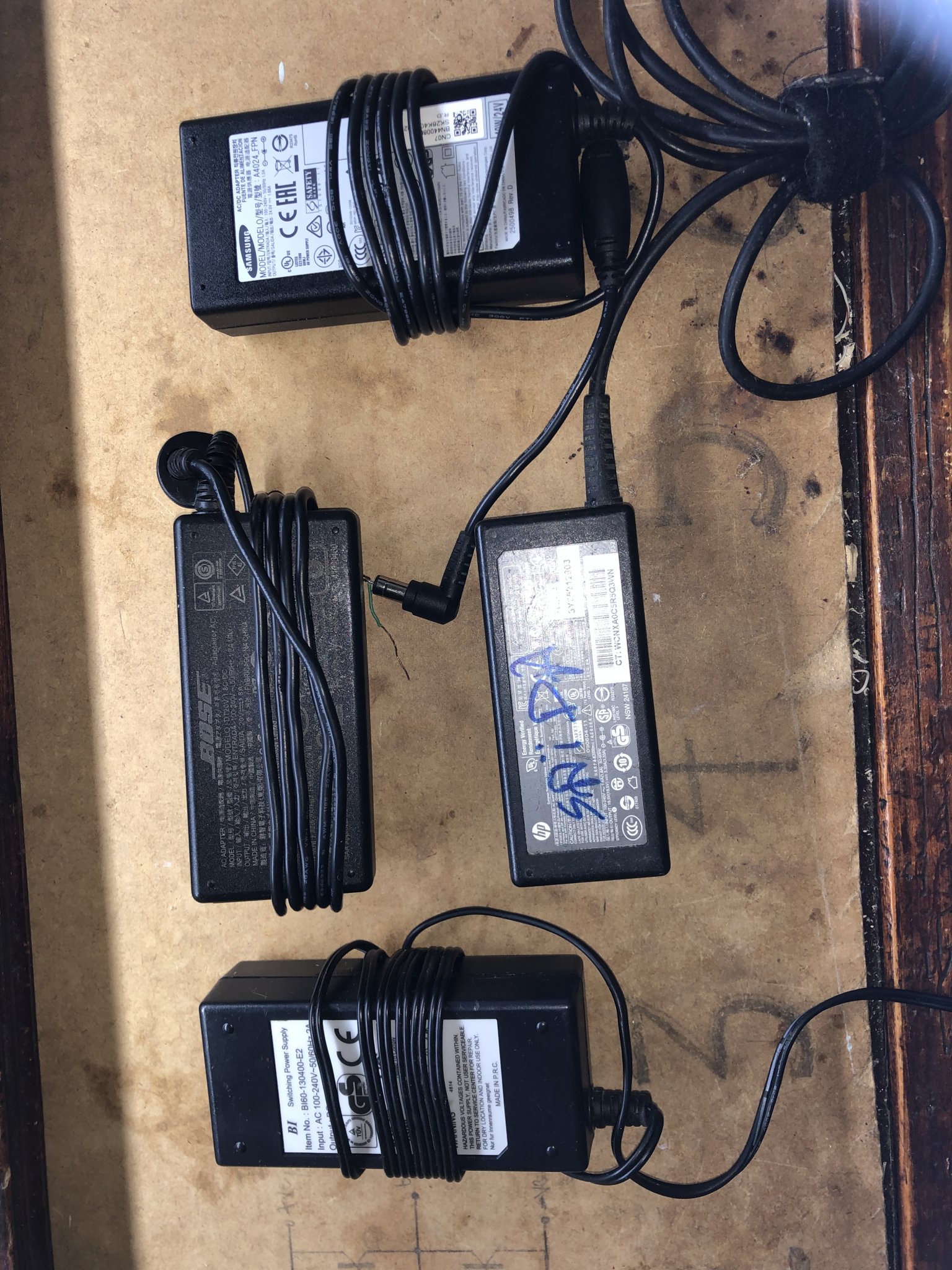

My personal preference would be a linear PSU
[ that is one with a transformer / rectifier / smoothing capacitor(s) ]
However for convenience Laptop ‘ Bricks’ are very useful. As I’ve been trying to find redundant Laptop PSU’s for a little while now as initially it was the easiest option to power my single 1969 JLH Prototype , the most useful was the 12 volt one for testing , the best sounding one is the Bose 20 Volt, but the Samsung 24 Volt gave more power into 8 Ohms but all wouldn’t deliver enough current to use on anything other than single original 1969 JLH with pair 3055’s

There have been many posts previously in this thread about SMPS of all varieties & my personal preference as I have already expressed is a powerful linear supply as a PSU for my DiYJLH Build.

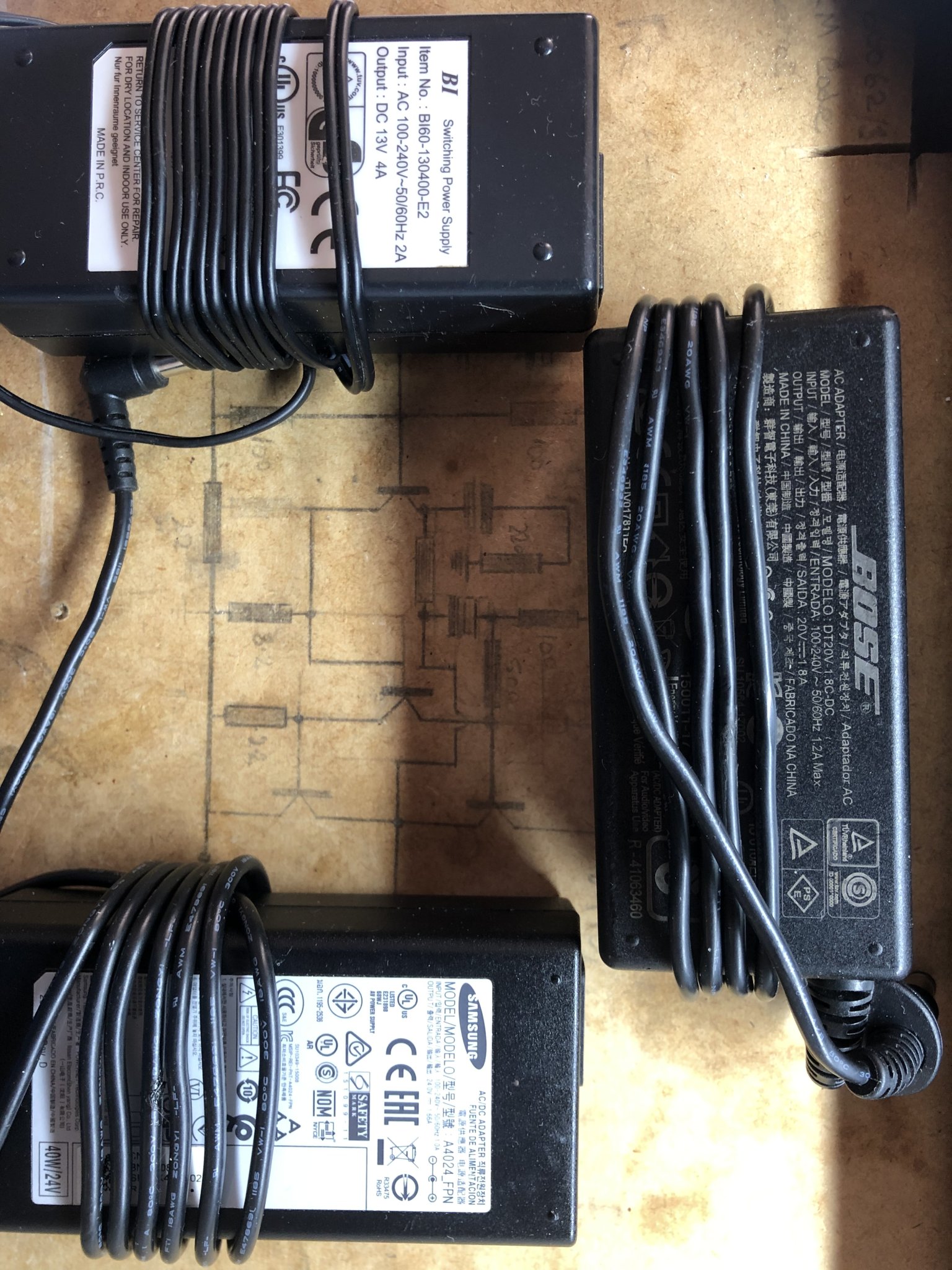

Data in a readable form presented in image below :
I was only considering using ‘Bricks’ above for testing my JLH 69 Prototype as I’m painfully aware of their limitations as the laptop power supplies I have obtained, range from 40 to 60 watts. Unfortunately I haven’t been able to find anything better due to my current location on the African continent. When I return home I will be looking 4 a case , large heat sinks, quality semiconductors & a massive toroidal transformer with capacitors up to the job of smoothing the ripple.
